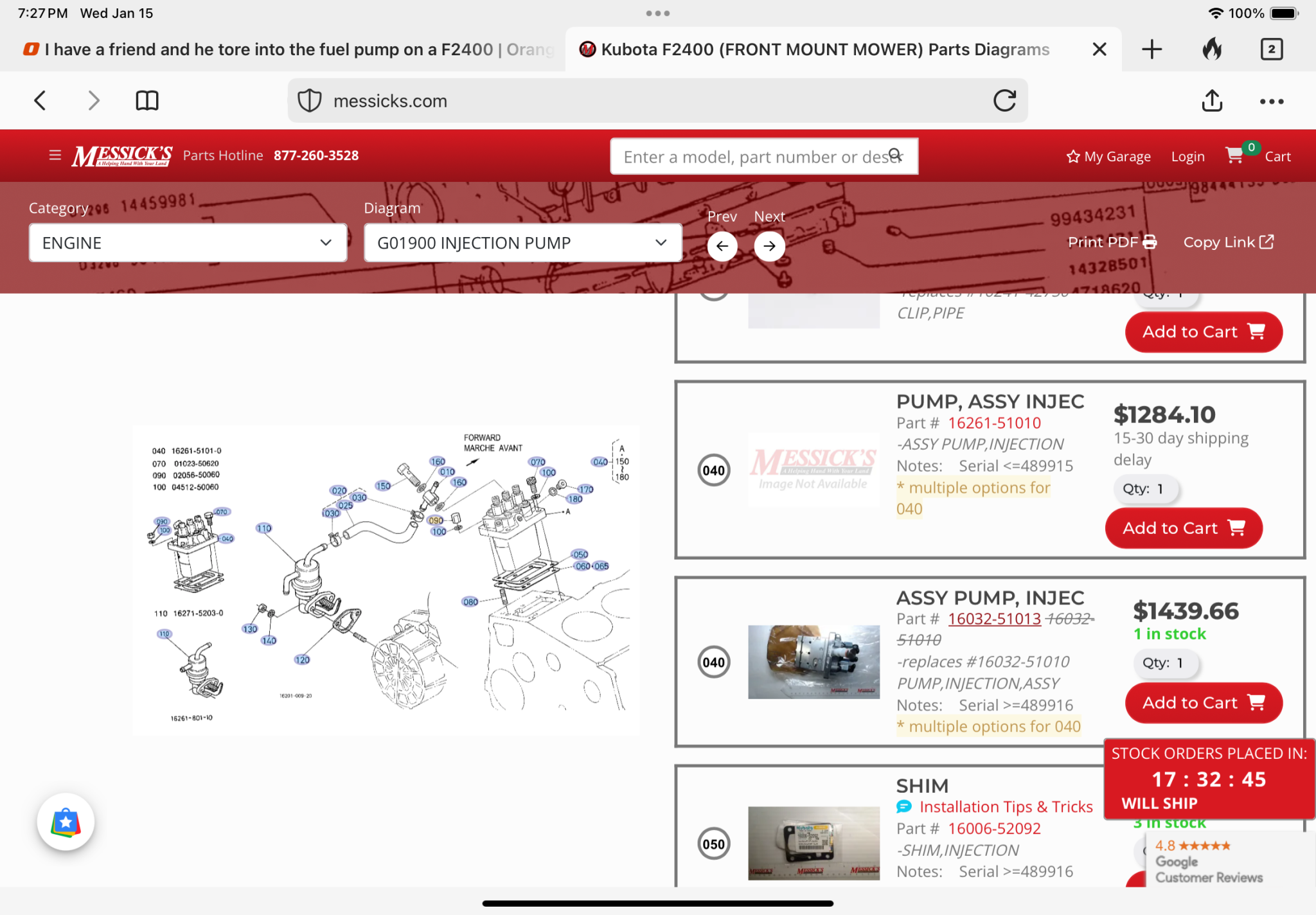

I looked at Kubota illustrated parts list and Messicks and nothing showing for internal parts of the injection pump. All that was shown is below
But WOW I don’t think he is going to be happy about the price of new pumps. There is a break in part number for the injection pump so be careful with that
