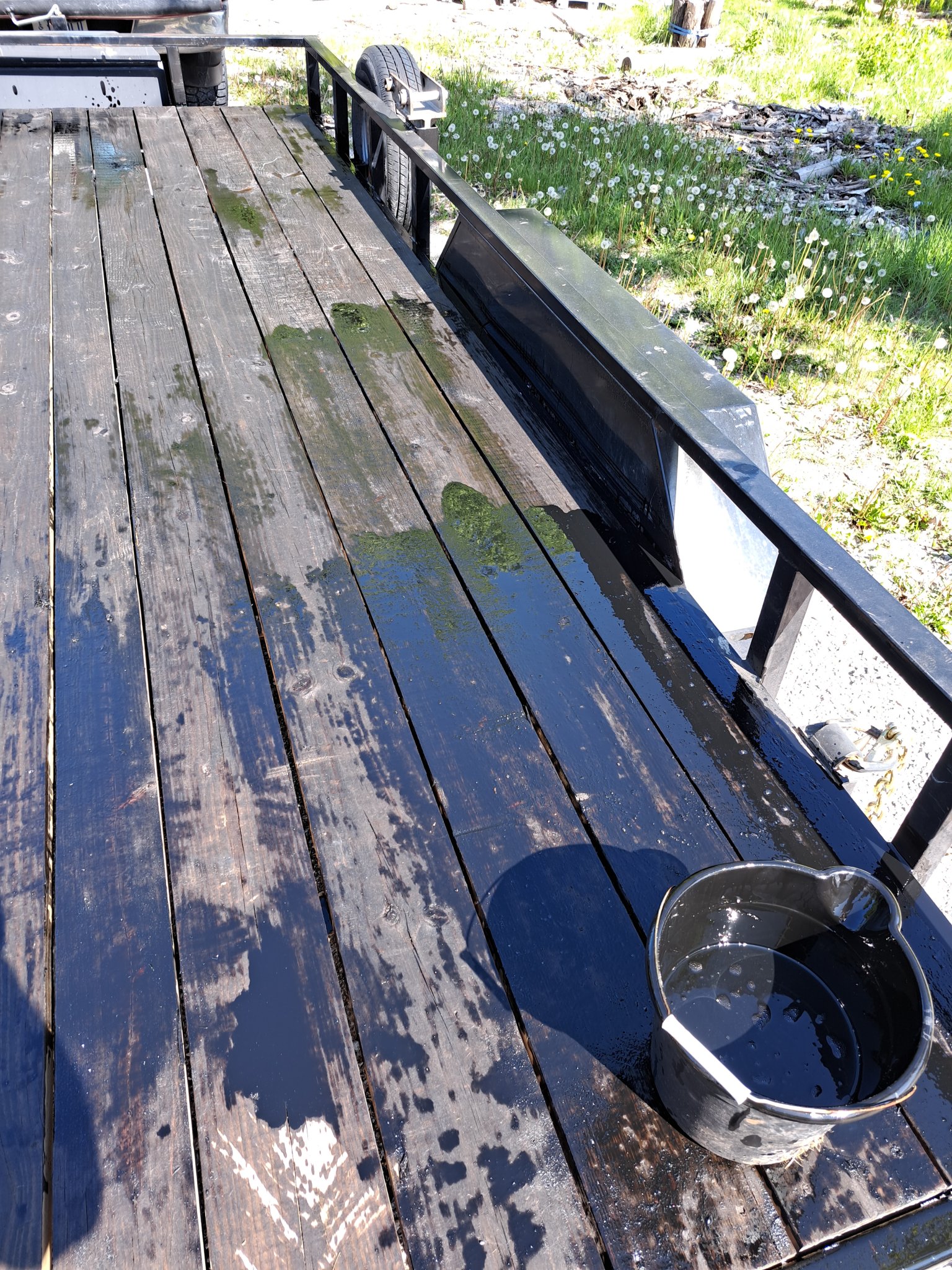

About 2-3 months ago, I was reading about how guys "recycle" their used motor oil as a wood preservative for their untreated trailer decks.
Well, while up at the cottage, I was just sitting there having a few, and I decided it was a good time to tackle this project.
I have learned my lesson (many times) about mixing "sharp tools and rum", so that's a good thing.
But a swab ain't sharp.
So off we go.....
Here's the before pic (kinda)
1,853
1,956
The "general consensus" on the Inter-web is that a 50/50 mixture of motor oil and kerosene to properly thin out the mixture is the ticket.
I don't have any kerosene so a natural substitute is of course diesel fuel (got lots of that)
So its off to the "mixing lab"
The first coat goes on nicely but is absorbed rather quickly, so after a beverage refill, a second coat is called for.
starting the second coat.
1,853
1,956
I don't recall the others I saw turning out his dark, so it appears that using "used diesel motor oil" Vs "used gas motor oil" makes an "appearance" difference.
2nd coat also goes nicely, but doesn't absorb nearly as fast.
The edges and some of the cracks are a little dry,
but using the swab to "mush it down" seems to work 'good enough".

Overall I quite pleased with it, however there are a few things to "take away" from this.
1. It sat for 3 "no rain" days before I loaded the tractor on it, and drove it at "basically" 70 mph for the 4 hour journey home and I'll be damned. It still had residual oil on it that dripped onto my concrete a little.:mad:
2. When I pulled the General Lee off the trailer, my tires were basically a "Giant R-4 tread stamping machine", so there were a few "MotherFu@@ers" thrown around.
Luckily (or Unfortunately, depending on how you look at it) , I am a pro at removing oil on concrete so the damage was mitigated quickly.
3. Lastly, (and most obviously) Do NOT do this on a "regular concrete" driveway. Here is a pic of my gravel drive right after. (it is now gone though)
The end.

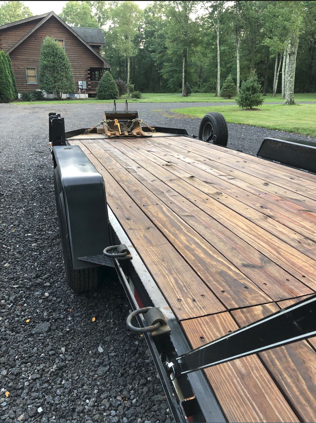

I did the motor oil treatment only once and wouldn't recommend it for the reasons that you posted above. My new "go-to" for trailer deck is ATF (used or new, doesn't seem to matter at all). It works much better than oil and isn't slick at all.
Here is a shot from a few weeks ago...this was the second time I've treated the trailer with ATF (once/year)
Give it a try the next time...I think that you'll like the outcome.
