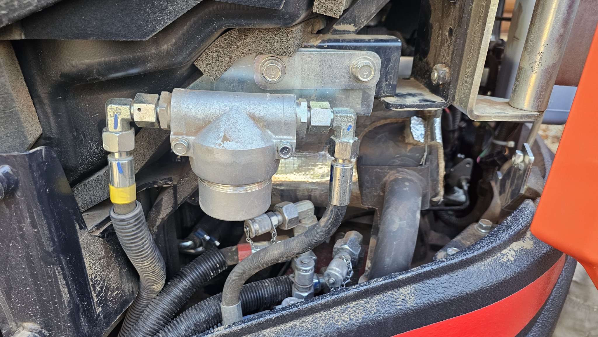

Hi, the hydraulic pump on my u27 excavator is vibrating excessively and shaking the cab. Also the hydraulics appear to be moving slower than they used to. It's only 2 years old with less than 200 hours on it. Is there a chance one of the filters has got plugged? I have noticed that when I extend the boom I get a a whistling sound through the hydraulics.
I've checked the hydraulic oil level it looks good and it is clear.
Of course my warranty just expired, So any advice would be appreciated.

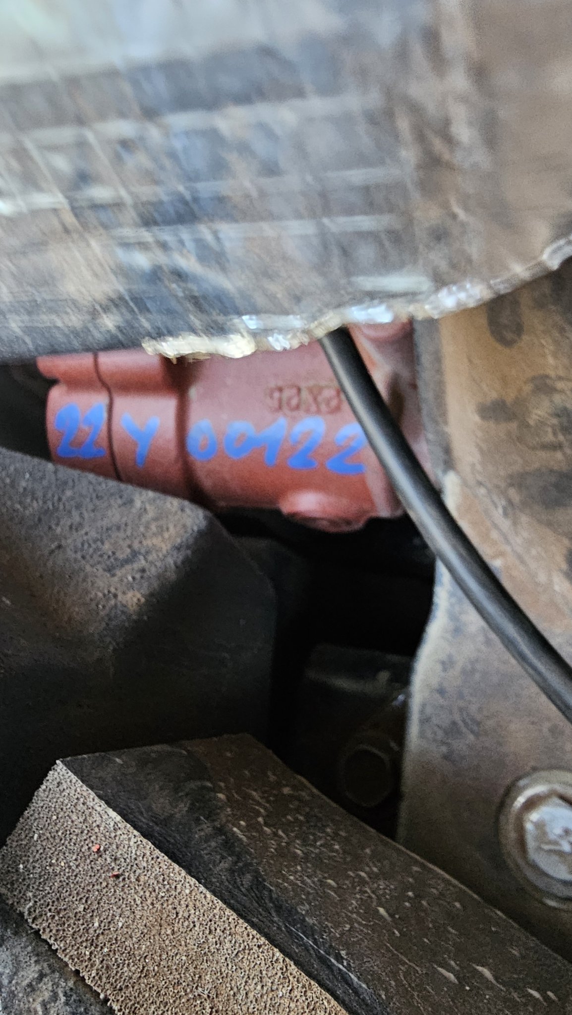

The hydraulic pilot filter and the pump, the filter housing is vibrating excessively

No idea about your particular machine, but from the description I'd be wondering about cavitation or air entrainment, like some problem with the suction line. Depending on whether suction line/s are hard pipe or hose. Kink or partial blockage of suction line, or crack in it, suction pickup damaged inside the tank, anyone done anything to any pipes, did it come on suddenly or slowly. What if anything preceded it, any mods or other disturbance. If flexible suction line sometimes the lining can come away like from faulty assembly of hose fitting and cause havoc downstream.

If this is due to an air leak, would there be clues in the oil tank? would the oil be cloudy or airated?
