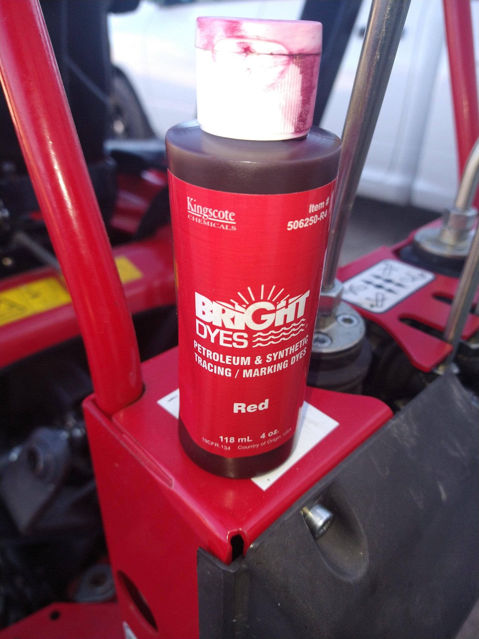

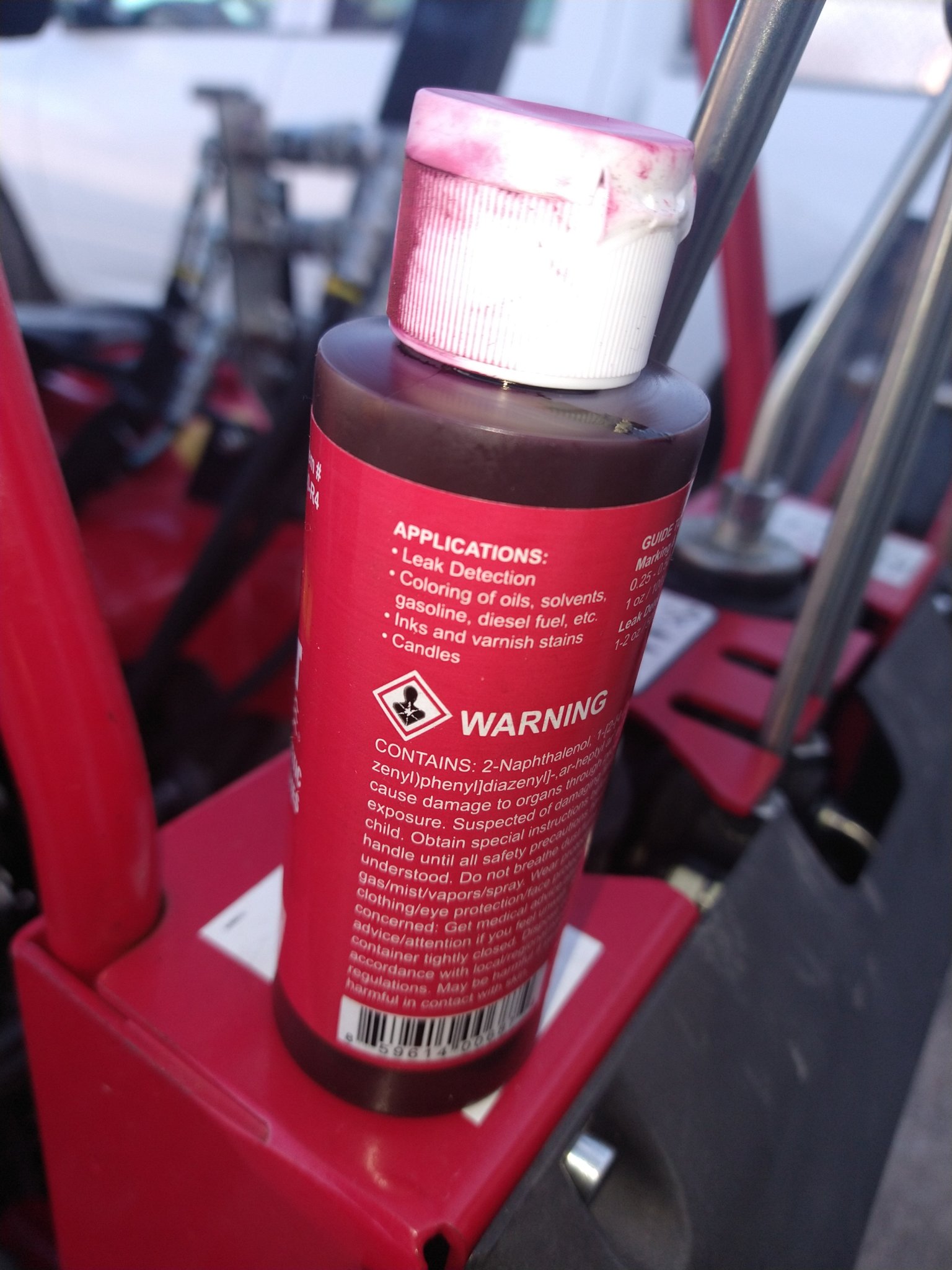

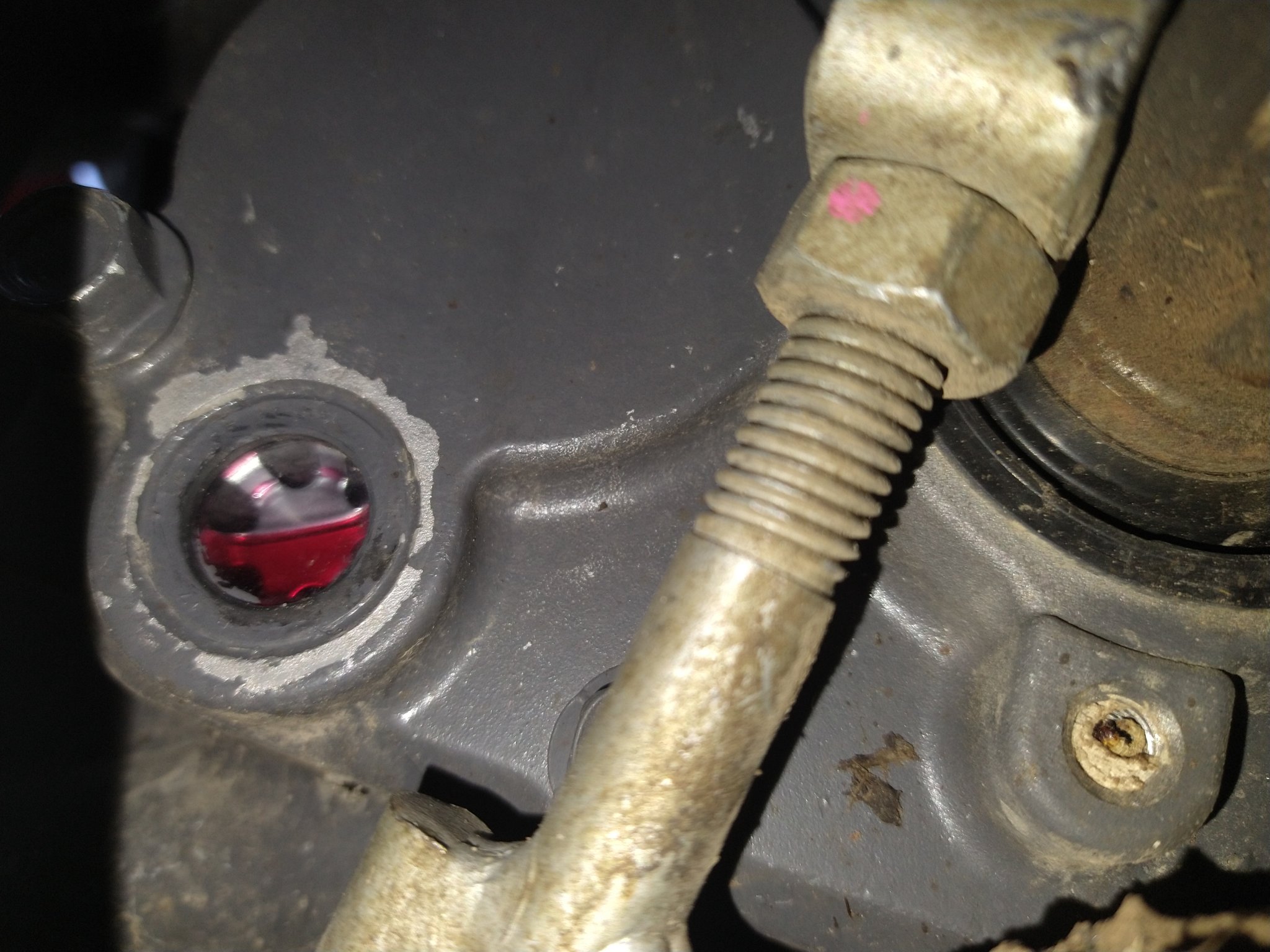

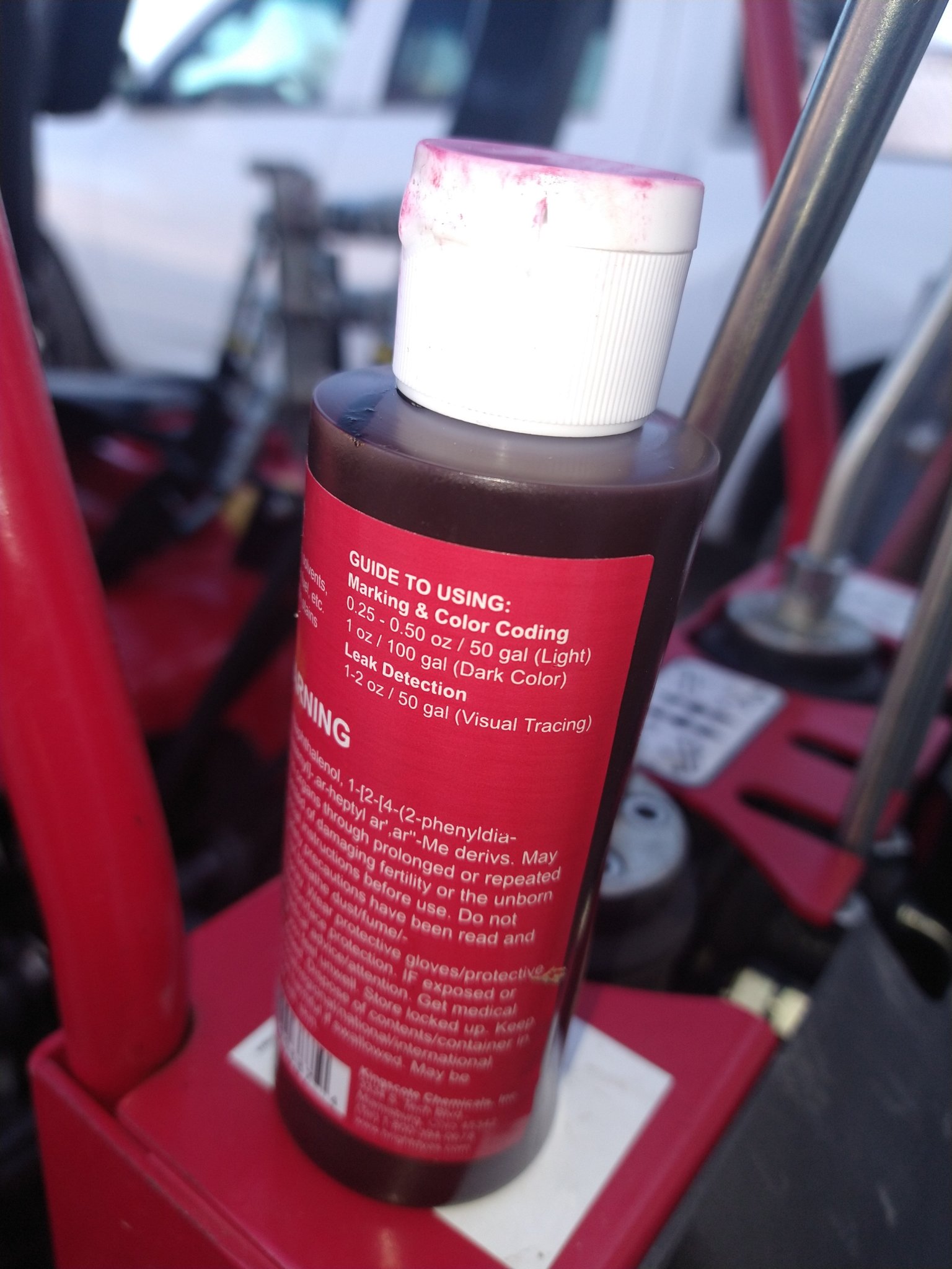

Just for notes sake ... The JD stuff is actually RED! If it is "pasty" when you open the tiny jar, don't throw it out, just add a little hydraulic fluid to it and stir ... ! It is only good for 5 gallons!
I use the same brand stuff mentioned above, but I bought the 4oz size from ... https://www.zoro.com/kingscote-dye-...red-4-oz-506250-r4/i/G5130815/#specifications (I wanted "free shipping" so added a pair of gloves or three) ... About 2 drops per gallon of hydraulic fluid is plenty ... I suggest you add it to the factory jug, then pour into tractor, because if you drip a drop on your tractor, you will have a red "tail", wear gloves too! 😉
There are other colors available, but I chose RED mostly because it was the cheapest, but also going into my RED tractor! I didn't feel like paying for the UV version, as if the leak is that tiny, I'm not worried about it ...

On my 1st use, I tried to drip it into the back of my tractor, (bottle is FULL!) I had my BH on, and it was challenging to say the least, I have red stains still on the back of my tractor, even though I tried to get it off, I'm guessing if I had tried something like brake cleaner, it may have gotten it clean, but I just used soapy water and a brush, I now have a red stained brush! It did read somewhere that it can be used in water, so I figured water would wash it off, I got "some" off my tractor and fingers with soapy water, some! :cool:
