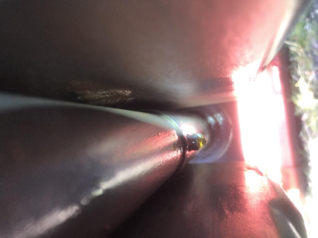

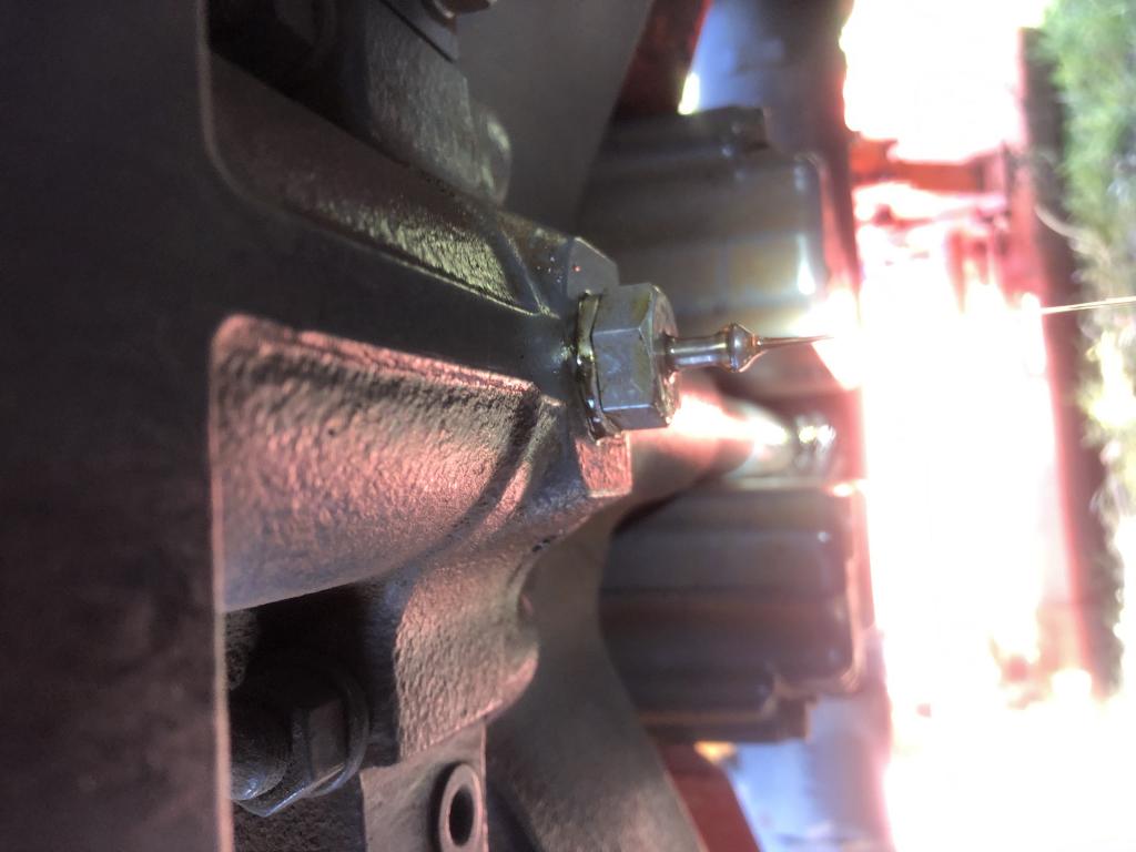

I have a L3540 with loader and backhoe attachments. Was using backhoe this morning to dig stumps out and after moving tractor i noticed a puddle of hydraulic oil and a trail. I looked under the tractor and saw a stream of hydraulic oil coming from under the tractor. I dont know how to describe the place it was coming from the most other than to call it what looks like a drain plug with a rivet in the center that can be pushed in and out. I'm assuming this is a weaphoe for over pressure?

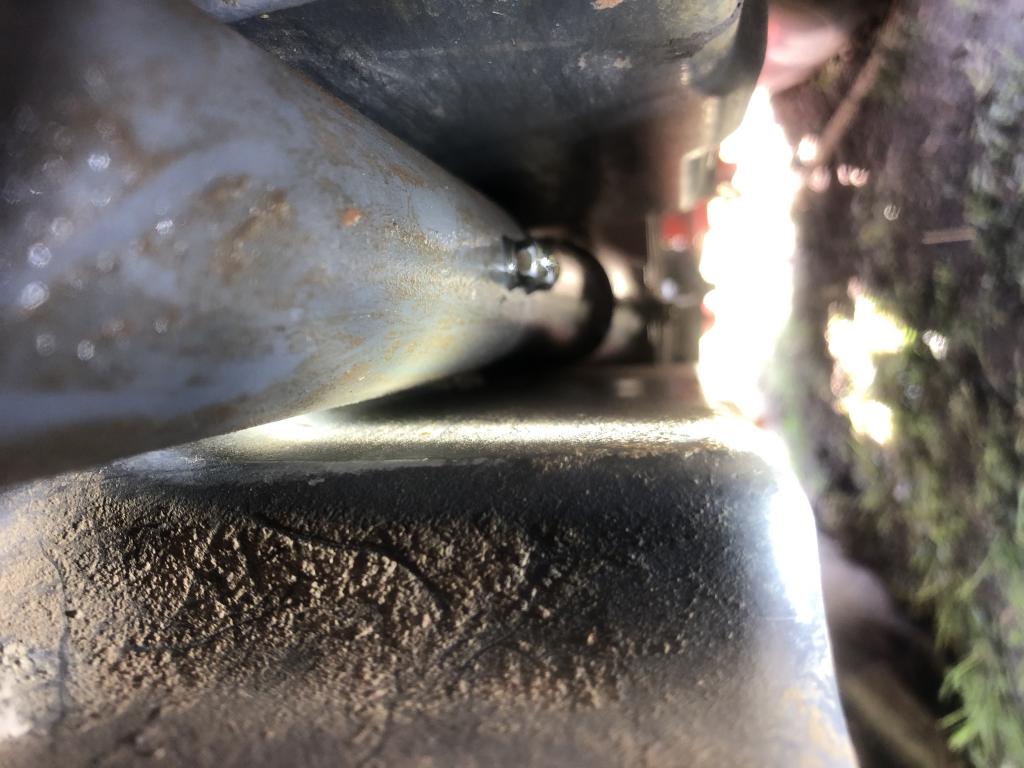

It also had a pretty good drip from the front drive shaft or what looks like it should be the front drove shaft that goes between the engine oil pan, about 6 or so inches to the front of this main leak. That was also hydraulic oil, and hoping that is was just coming from the same source...
I took pictures and hope someone can help me out.
1st and 2nd pics are going to be from under cab facing front of tractor
3rd is going to be same area but 6 or so inches forward on the front driveshaft.

Yes, that is a weep hole for any fluid that leaks into the clutch housing.
The most common source of a leak here is from the front axle propeller shaft where it goes through the front of the transmission housing into the clutch housing. You have to separate the tractor to access the seal. While it is separated you will want to also replace the transmission input shaft seals.
It is plausible that the oil could be from the front axle input shaft seal leaking and running through the front propeller shaft shield into the clutch housing. Check your front axle fluid level. You most likely are going to find it full though.
