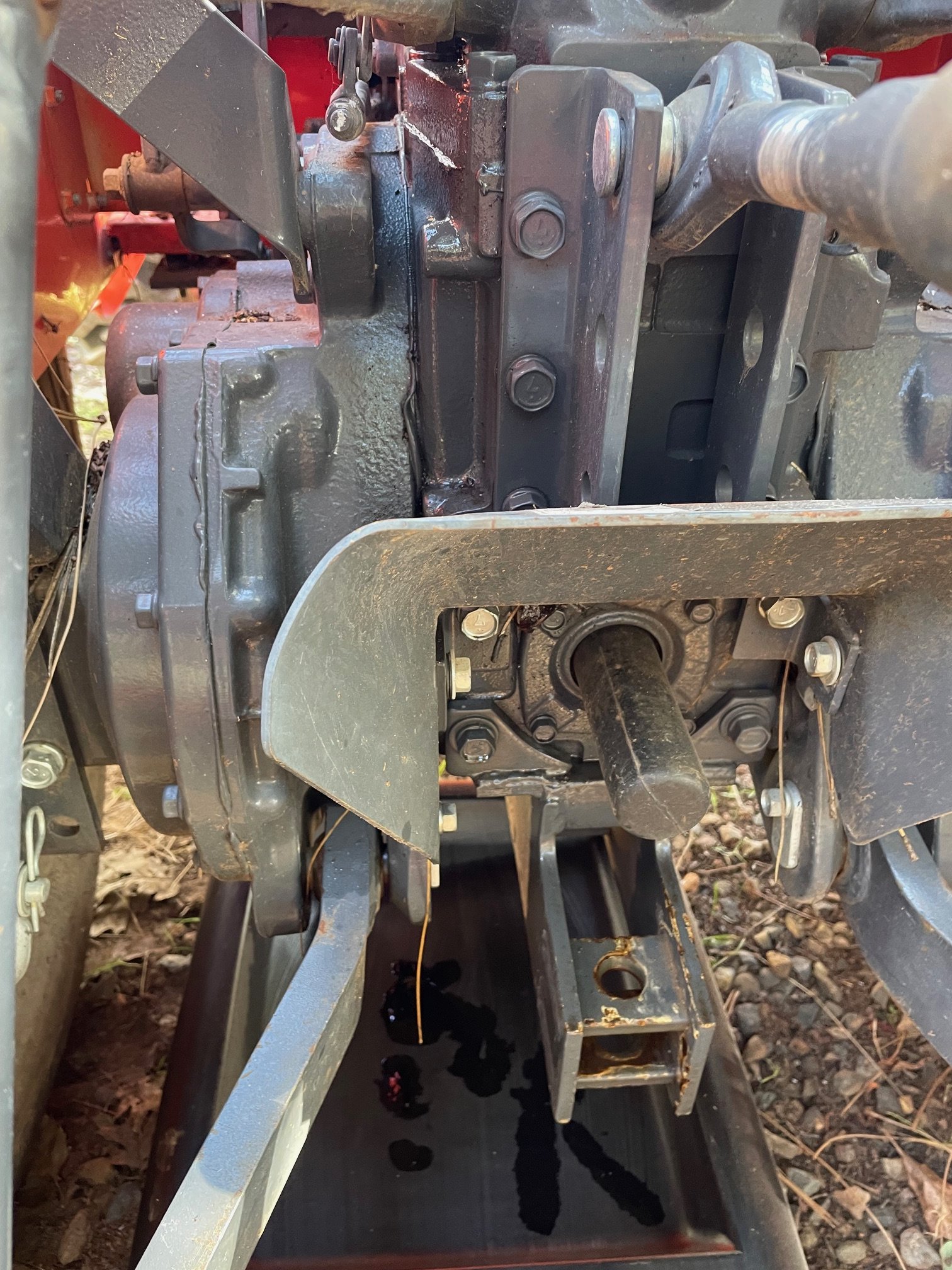

I have a L2501DT tractor that has a hydraulic fluid leak that appears to be coming from a bolt on the upper left side of the rear housing cover plate (differential/axle) under the seat.
In the pictures you can see the leakage from the top of the housing around the bolt, down the left side of the housing and all over the drawbar (removed for cleaning).
It may be due to me overfilling the fluid as I find it extremely difficult to see the fluid level through the inspection port, which just looks cloudy all the time. I suspect that as I used the tractor, the fluid heated up and expanded, creating too much pressure inside the rear axle/transmission housing...

From other sources, I now suspect I've definitely overfilled the case...as they pointed out the vent tube (a little black U-shaped hose) exits right in front of the bolt head that I originally thought was the source of the leak.
Another source said they used a bit of John Deere red hydraulic dye to aid in seeing the fluid level through the inspection port.
So I've got an errand to do and a procedure to slowly drain the fluid (while on level ground) to get it down to the correct level.
Any additional comments here are appreciated...since I'm learning. TIA.

On level ground, I would just suck out some of the fluid until you see a small area at the top of the sight glass without fluid. While your there, make sure that the hole at the end of the vent tube doesn't have any crud buildup in it. After that, you should be good to go.
31,802
7,595
You nailed your issue.
Overfilling is a bad thing.
