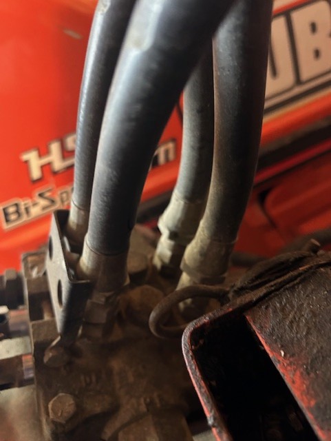

Are you sure you have the bucket and lift hoses connected to the correct ports on the valve? Sounds like you might have bucket and boom reversed.

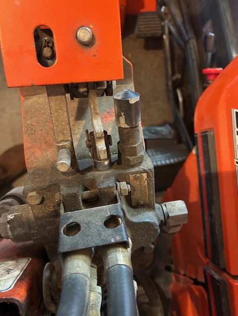

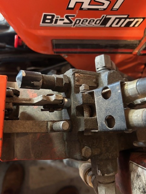

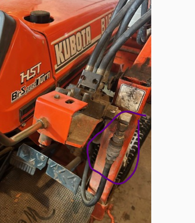

Dont see anything obvious in the (excellent) pictures.
Do you see the two rods that come out of the valve body? Those are the "spools" that control hydraulic flow.
Move the joystick handle back and forth from raise to lower several times while watching the leftmost spool. It should slide in and out of the casting and stop in the mid point when you let go of ths handle.
Now compare that movement to the movement of the right spool when you move the joystick back and forth between dump and curl. Both spools should move the same (more or less) amount and automagically center when you release the levef.
