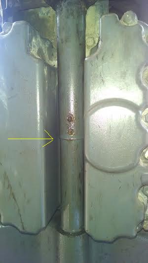

Hi all, I'm a newbie with a problem (imagine that!). Thanks in advance for any help. I have a l3540 and I was running the brush hog for a couple of hours with no noticeable problems. I had the FEL off for clearance between trees. I finished up and reattached the FEL. when I restarted the tractor after hooking up the hyd. hoses to put the pins in It started leaking a constant stream of fluid out of the spots the arrows are pointing to. After investigation I found the hydraulic cooler plugged with debris. It leaked well over a gallon of fluid but stopped when it cooled. The next day I refilled the hydraulic fluid and cleaned the cooler and underside of tractor. I ran the bush hog for about 15 min. checking the underside frequently. There was no stream of fluid like before but when i parked it a couple of drops came out. I bought the tractor used in January and changed all fluids and filters then so the fluid is fresh. i put 50 hrs. on it since then with no problems. It was hot out that day, I'm in southwest Florida. My question is is there a relief / safety valve causing the leak or did I cook a seal? Thanks again for any help!

Sorry yes you have a cooked seal!

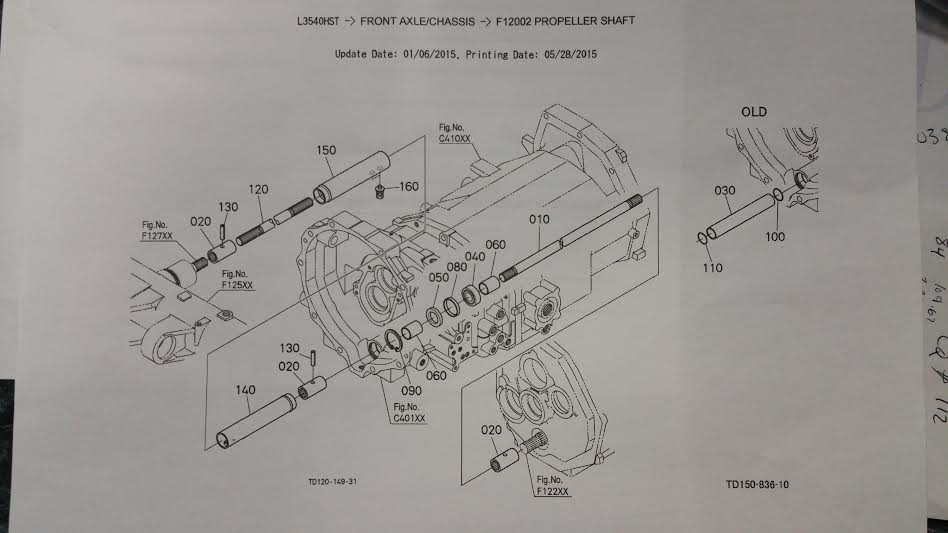

Thanks for the input shadow! I looked in the wsm and I couldn't find a good pic or info on that seal. I have the part diagram below. # 90 is a snap ring and #50 is the seal. From that picture it looks like it can be replaced by just pulling the propeller shaft and cover, unless the snap ring is set too far back where it can't be reached. Does anyone know if it can be done without splitting the tractor?
Thanks, Andy
Ps It just took me an hour to figure out how to post this image :mad::eek:

You're going to want to get 40, 50, and both of 60. 60 is a sleeve, that has rubber on the inside to seal the against, the shaft, then the seal seals against that sleeve. There is one behind the bearing, and one in front of. You'll have to split the tractor to remove it, it's not a hard job, but it can be time consuming. I would also suggest replacing the input seal, and if the clutch disc is wet from the oil, replace that too. Would hate to see a guy get it all done and have his clutch slip later because of the oil on the surface. If you catch it right away, there's a good chance the disc will be ok, but if you continue to run it, that oil will sling around in there and soak that disc. The biggest trick is, that coupler, 20, will not come out of the shaft hole, when you go to remove the shaft, it will stay in the transmission. You'll have to get ahold of it and either put it on the shaft by luck, or put it back on the output shaft in the transmission, again, its a trick.

I am confused about the issue with # 20. You say it will not come out of the case, is that because of its size or that it stays attached to # 10? How is it fastened to # 10? Will I need a new one? You also say when i go to remove the shaft it will stay in the transmission, are you referring to the prop shaft # 120 or output shaft #10?

#10 is the shaft that comes from the back of the transmission, to the front. 20 is splined and just matches with the rear shaft, which is pictured, but not numbered in that diagram. You won't need 10 or 20 new, 20 will stay in the transmission, THAT'S what you'll have to fish out and try to connect with 10 and the shaft at the back of the transmission. From what I've seen, the most common issue for causing that seal to leak, is when 4wd is used and not needed. It's like a pickup truck, if you don't need 4wd, dont engage it, it only wears out the components faster. The torsion that is applied to that shaft, when 4wd is engaged on a hard surface (ie, not necessary to use), is enough that over time takes out that seal. Rule of thumb, if you don't need 4wd, don't use it
