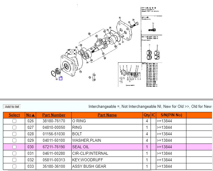

Hey Russell,
Thanks for this post, you may have just saved me a big headache on my L185.
However, I am looking at an exploded view of the pump assembly and am not seeing anything labeled as "Power Input Shaft" or "seals". Am I looking at the right thing? Here is the diagram, if you would, please verify I am on the right track and maybe where items are located (I assume between #1 and #6 positions of the diagram. Or is there an output shaft from the engine with a seal located between the pump and the mounting boss on the block, that isn't shown in this diagram?
Thanks in advance for your response.
Regards,
Gary

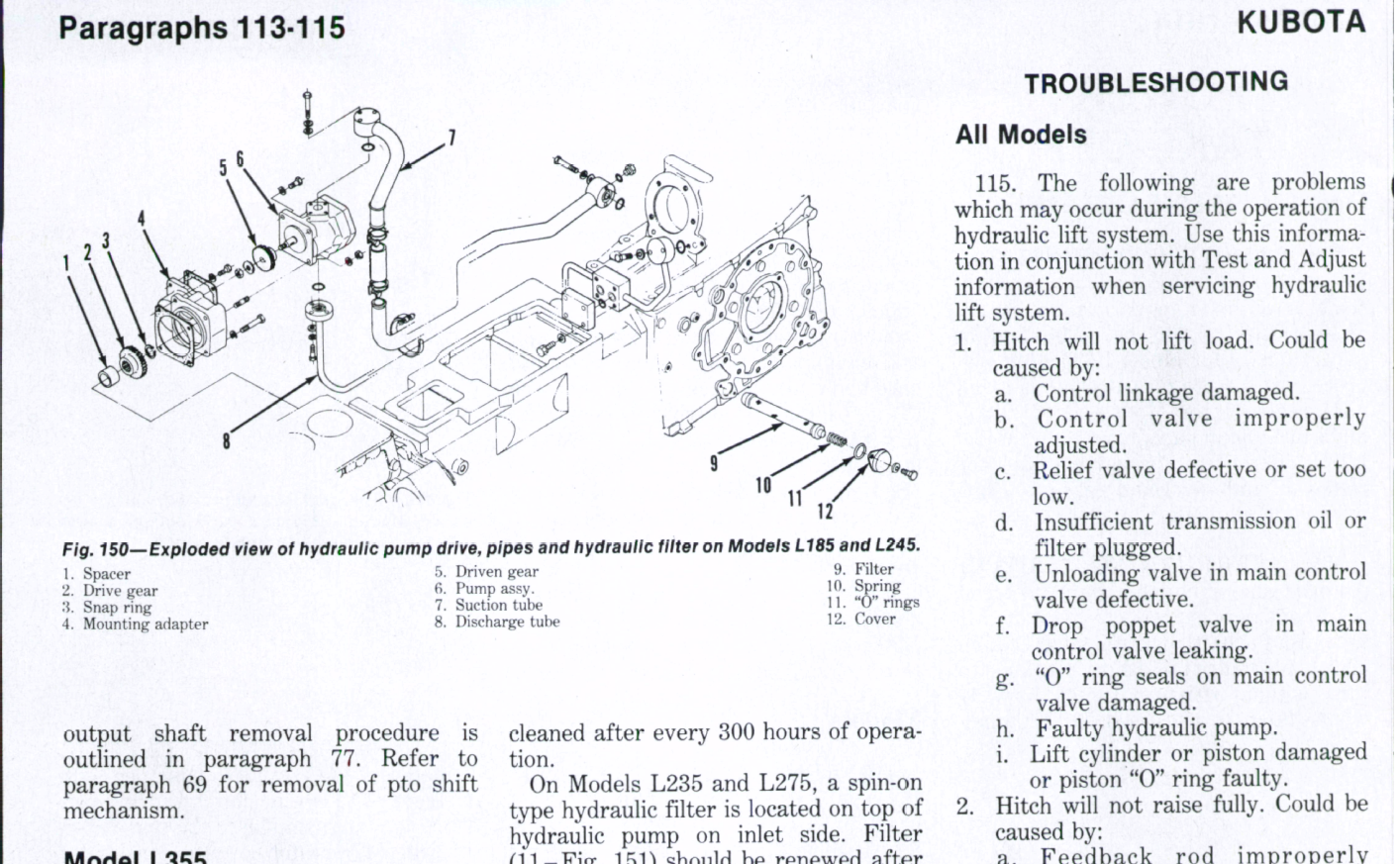

This is what you need to look at:
