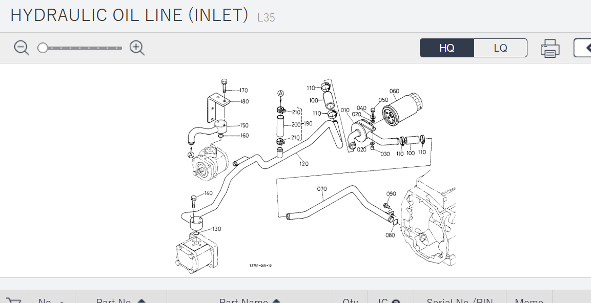

L 35 tlb, there is a leak in the hydraulic delivery pipe (120 on schematic). I have it disconnected on both ends. Does anyone know how to get it out? I'm hoping not to have to completely disassemble the front end to pull it out & replace it. Thanks
120 on this diagram from KubotaUSA is a bracket. Is the line you're referring to on here?
