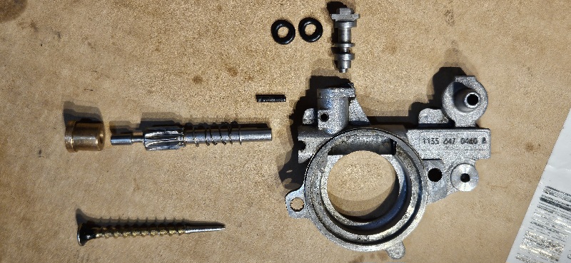

Chainsaw chain oiler pumps leak because b.) the pump shaft or seals are worn and oil leaks past, but mainly a.) the oil tank isn't completely full. When the saw cools, air in the oil tank contracts drawing fresh air in through a one-way valve. When the outdoor or indoor temperature warms up air in the oil tank expands and pressurizes the oil tank pushing oil past the pump shaft and out the chain oil port. To minimize this fill the oil tank completely and if possible store the saw somewhere where the temperature is relatively constant.
(oil pump, disassembled)
