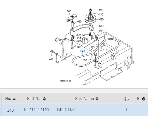

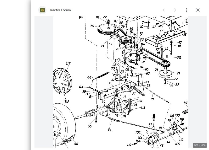

Nobody has yet mentioned that your HST's DRIVE BELT could just be worn or loose?
HST units usually hold up amazingly well (so do the newer bigger ones). On most Kubota machines the HST is driven directly by the engine but on your TG1860 it is at the back end of the tractor, driven by a belt from the gearbox.
The HST belt is separate from the mower belt. It can get worn and start slipping - which lines up with the symptoms of good grass cutting but intermittent motion. Another possibility is the tension idler pulley spring 130 (lower drawing) is weak or disconnected.
The No. 79 drive belt, (part 140 on the HST belt drawing) is Kubota part no. K1211-12120 and is widely available for about $13 delivered.
The HST belt is separate from the mower belt. It can get worn and start slipping - which lines up with the symptoms. of intermittent motion. Another possibility is its tensioner pulley spring is weak or out of adjustment.
p.s. On these diagrams - the No. 79 drive belt, (part 140 on the HST belt drawing) is Kubota part no. K1211-12120 and is widely available for about $13 delivered.
View attachment 126634 View attachment 126635
