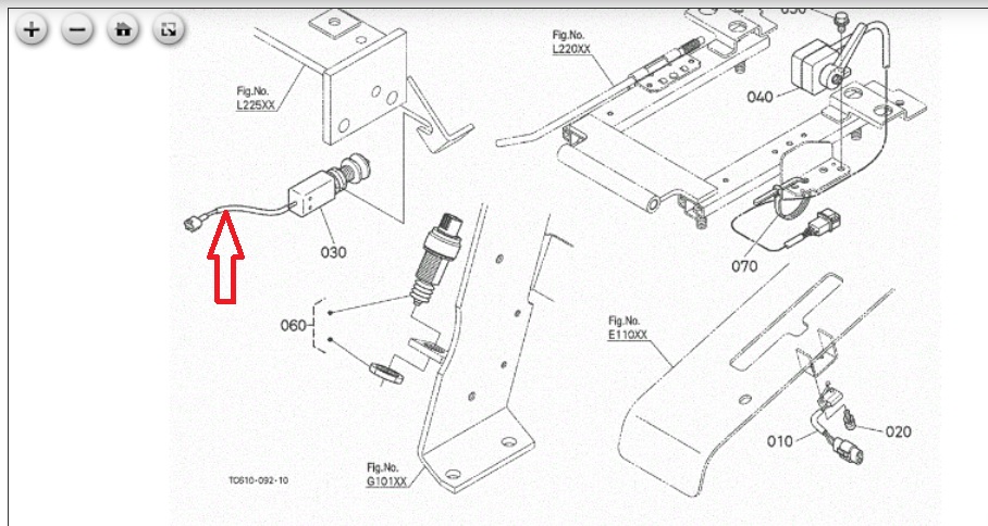

You may find that the switch has a wire pig tale and the connector you have to disconnect is located perhaps 6" away from the switch.
I am not certain the switch I have marked is the one in question. If not then on the connector to the switch there is usually a small lever as part of the connector you need to depress to free the connector.

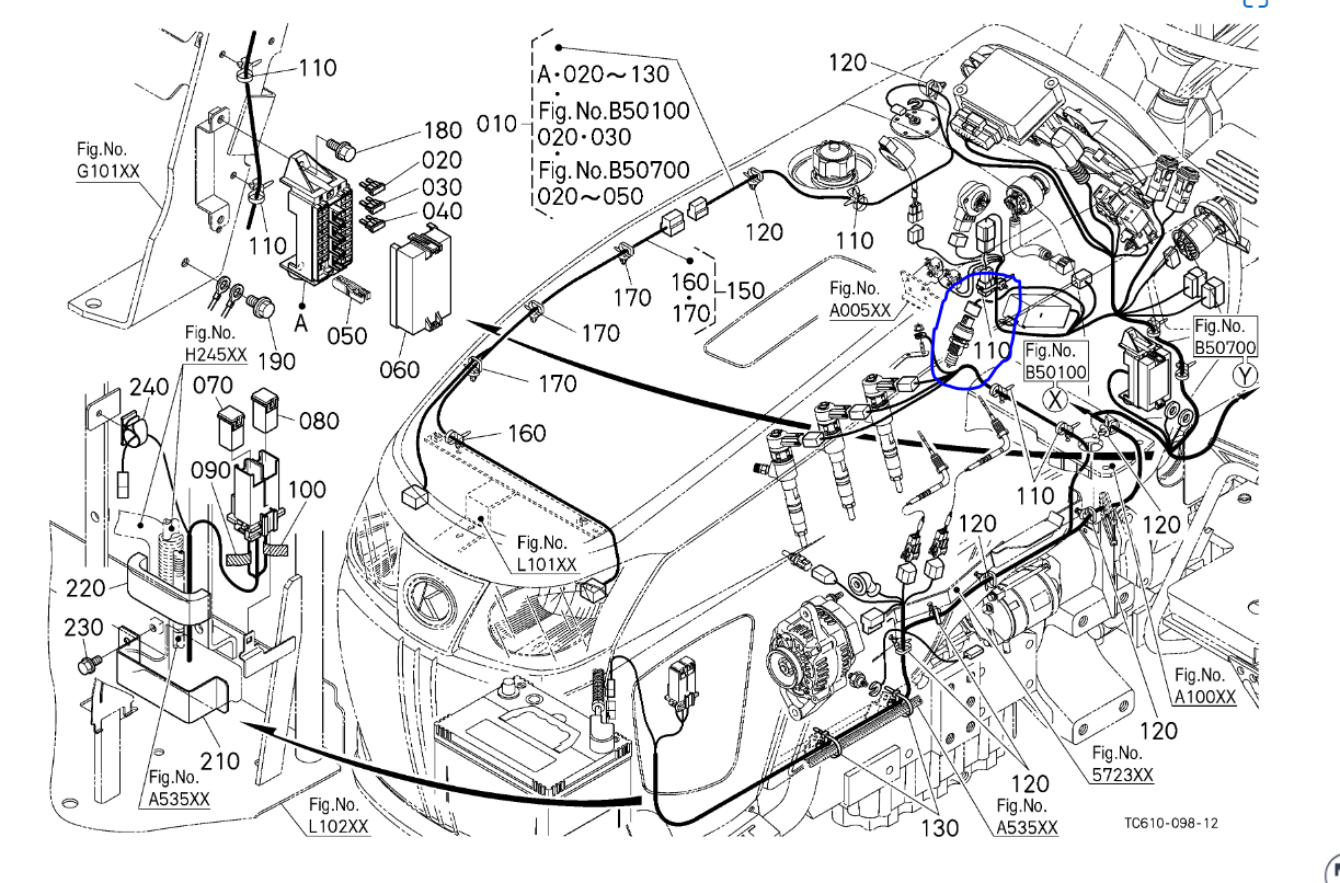

Thank you! I was looking at the bottom of the connector instead of the top for a tab. Like I said - stupid question. I was trying to identify the part to get a part number from the Kubota illustrated parts viewer, but having a hard time figuring out how to get the part number.
I can see the part, but I cannot figure out how to get the part number for it. Any ideas? Thanks again for my stupid questions.

That looks like the 'electrical wiring' sheet. There usually is/are 'switch/sensor' sheet(s) that show the items. Be seated when you price it.
5,632
1,561
Get to the correct section of the various illustrated parts lists and then below that is the list of parts and names arranged by the item number (110).
Probably need to be on a computer not a mobile device but Kubota may have updated since I tried using an iPad a couple years ago (did not work)

This should be the switch you are looking for if you have a hydrostat tractor.
Love this group! That's it. And that was exactly the part I was looking for. Just bought a new one and installed it and after about an 1 hour of getting on/off the tractor not one stall!
Funny story, the diagram shows the nut going under the bracket, but whoever replaced this switch before, left the lock nut on the switch and just screwed the whole thing on. This made it incredibly difficult to remove the switch as the nut was trying to lock it on, but you could not get a crescent wrench on it because the housing on top of the switch is bigger than the nut. What a pain.
