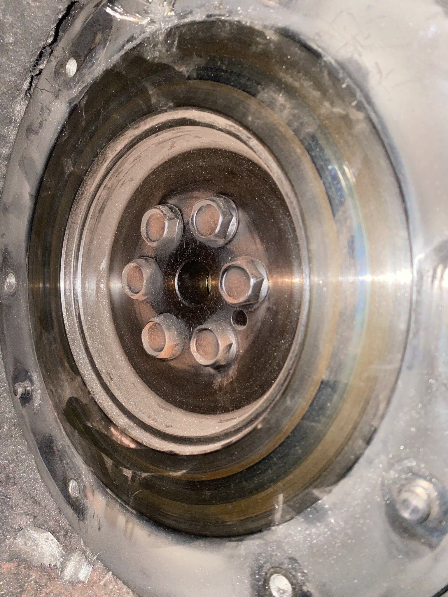

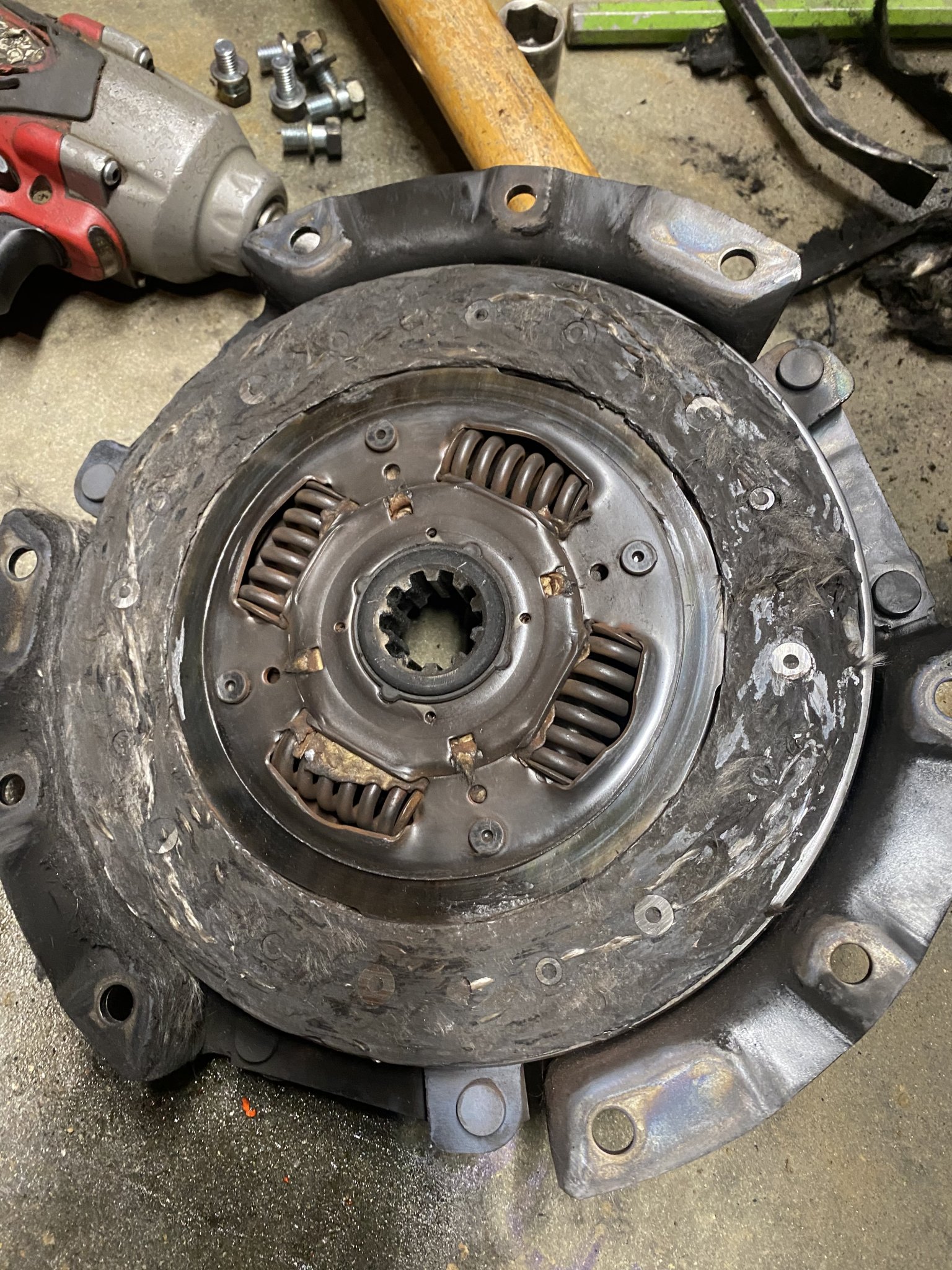

Finally got around to splitting it. She’s crispy for sure😂 flywheel definitely has some bluing and has some waviness on the clutch mating surface. No visible cracks that I can see. Any reason specifically not to resurface? B73A6679-8923-43AA-8ACD-D364E2757CE3.jpeg 82523F65-55F2-41E8-825F-2FFC68D8F93F.jpeg

The reason you do not resurface these flywheels is that any dimensional changes effects the clutch movement quite drastically.
clean it up then use a flat edge and check for warping.
If it's wrapped replace it, if not just rough up the surface and run it.
Make sure you set the clutch linkage up properly or you'll fry a new clutch disk in a quick hurry.
Awesome I’ll just break the glaze, clean it up and run it.

Finally got around to splitting it. She’s crispy for sure😂 flywheel definitely has some bluing and has some waviness on the clutch mating surface. No visible cracks that I can see. Any reason specifically not to resurface? View attachment 95447 View attachment 95448
I've never seen a disc worn like that one!
Someone never read their operating manual.
Bill
