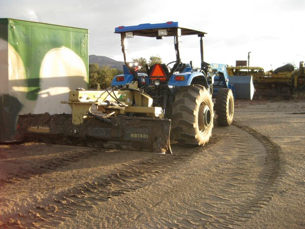

I don’t have top and tilt either but with my rear remotes and my RBT (land pride) back blade, it has the function to angle tilt and offset via the hydraulics. it’s all in the back blade itself combined with rear remotes…no top and tilt for me…that would be nice though. (I have three remotes).
I have done very limited grading(it can make a mess in a hurry though😉)…my tires are loaded (I also have wheel weights) and there is no issue for me other than my lack of use/skill to do grading work(pros are worth their price IMO as I don’t have that type of skill yet). Your L should have no issue to use that size IMO. If you have rear remotes, the blade is a great opportunity to use them. Depending on what brand you buy, might want to make sure the beam is long enough you can swivel the blade 180…then you have the option to push or pull….maybe they are all that way but I am not sure…I know I can do either with mine and I like that versatility.
I am not sure the models in The pic are current or not but you can see the hydraulics to understand what I meant with the functions. I believe you can order them per the number of remotes…they can omit one or two of the hydraulic function to match number of remotes you have and then you can manual adjust for the rest it you only have 1 or 2 remotes…if that makes sense. (The blade itself has offset angle and tilt capability).
