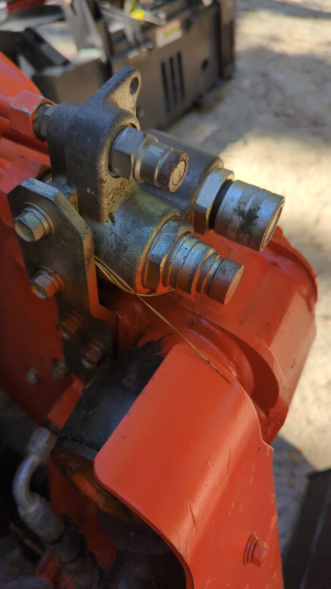

Folks, I'm at a loss her me. Bought a used 2012 Kubota SVL90-2 and was told by the dealer that it was high flow. But now some folks said it may just be standard flow as I'm looking at mulcher type attachments.
How can I confirm my machine is high flow? There's no real clear info online or in videos and each machine is a little different depending on year model.
I have the 3 ports basically male female and a smaller port for aux. I have an aux button inside. But not the newer switch where you hold down for high flow.
Is there another way to tell? It is it factory high flow by default?
Any help or guidance would be great before I invest in attachment.

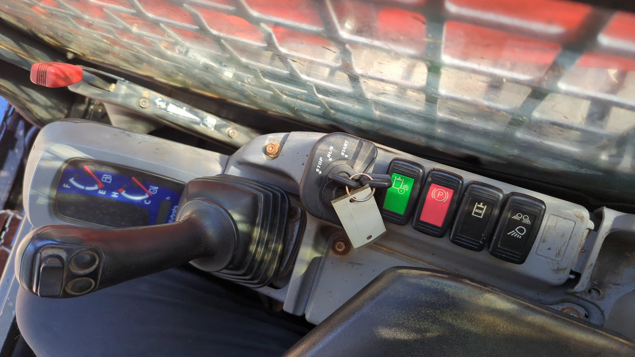

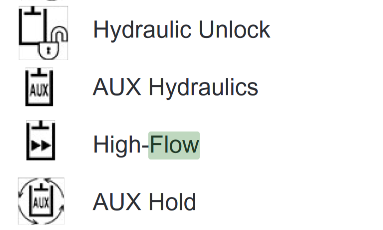

on your right hand control do you have an aux port variable switch? (a horizontal switch that can be depressed either left or right)
I was told this was the toggle for the flow rate on high flow systems and when depressed either left or right if active it should illuminate a light

I have that aux switch but whether I hold it down or try to toggle or push harder doesn't seem to be anything other than aux on off. I see the aux icon on display. But never flashing or anything different as I mess with the switch.

without further investigation I would suggested the variable/hi-flo option is not present or not working.
But please don't take my word as gospel as I no longer own one myself.

You have the Ports wrong,
The 2 large ports are flow, the smaller port is case drain for implements that need it.
Give me the serial number and I might be able to tell you if it's high flow.

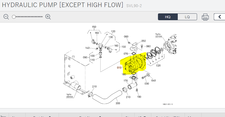

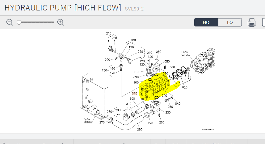

Look at the hydraulic pump
HIGH FLOW
NOT, HIGH FLOW

11,421
4,908
So, the 'easy' way to confirm what is there, is to SEE the actual pump and compare to the dwgs that NIW posted. Hi-flow pump is longer due to the extra 'section'. Also the lower big pipe has a smaller one. I looked in the Canadian website and yeesh..the hi-flow pump is almost 3X the cost of the regular pump.
Hopefully you'll be able to open a cover plate to see what's there ?

I have a newer high flow svl75, rocking the Aux switch to the right, towards window engages standard flow. To engage high flow you have to rock switch to left and hold down for some seconds. Good luck working things out.
