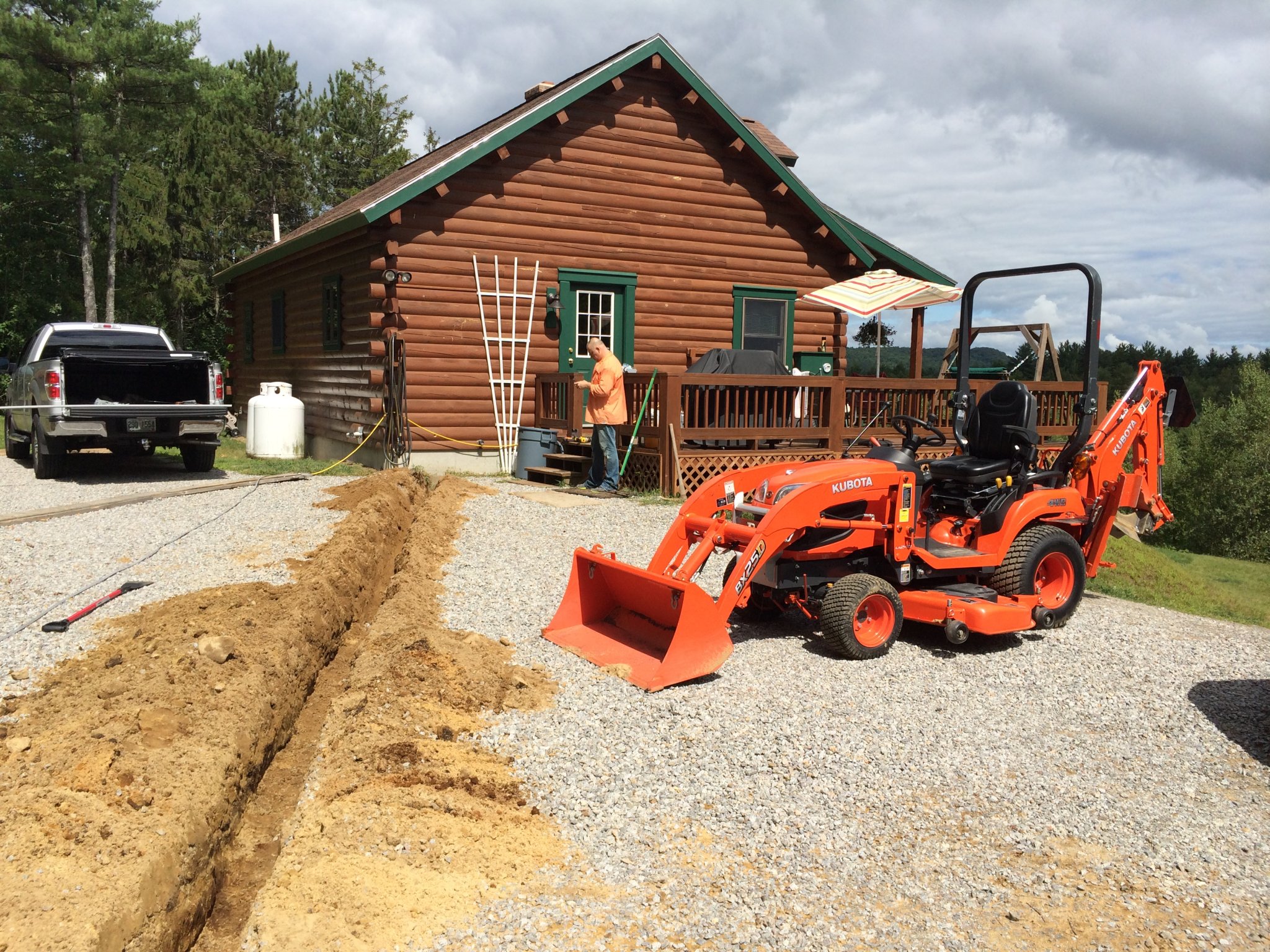

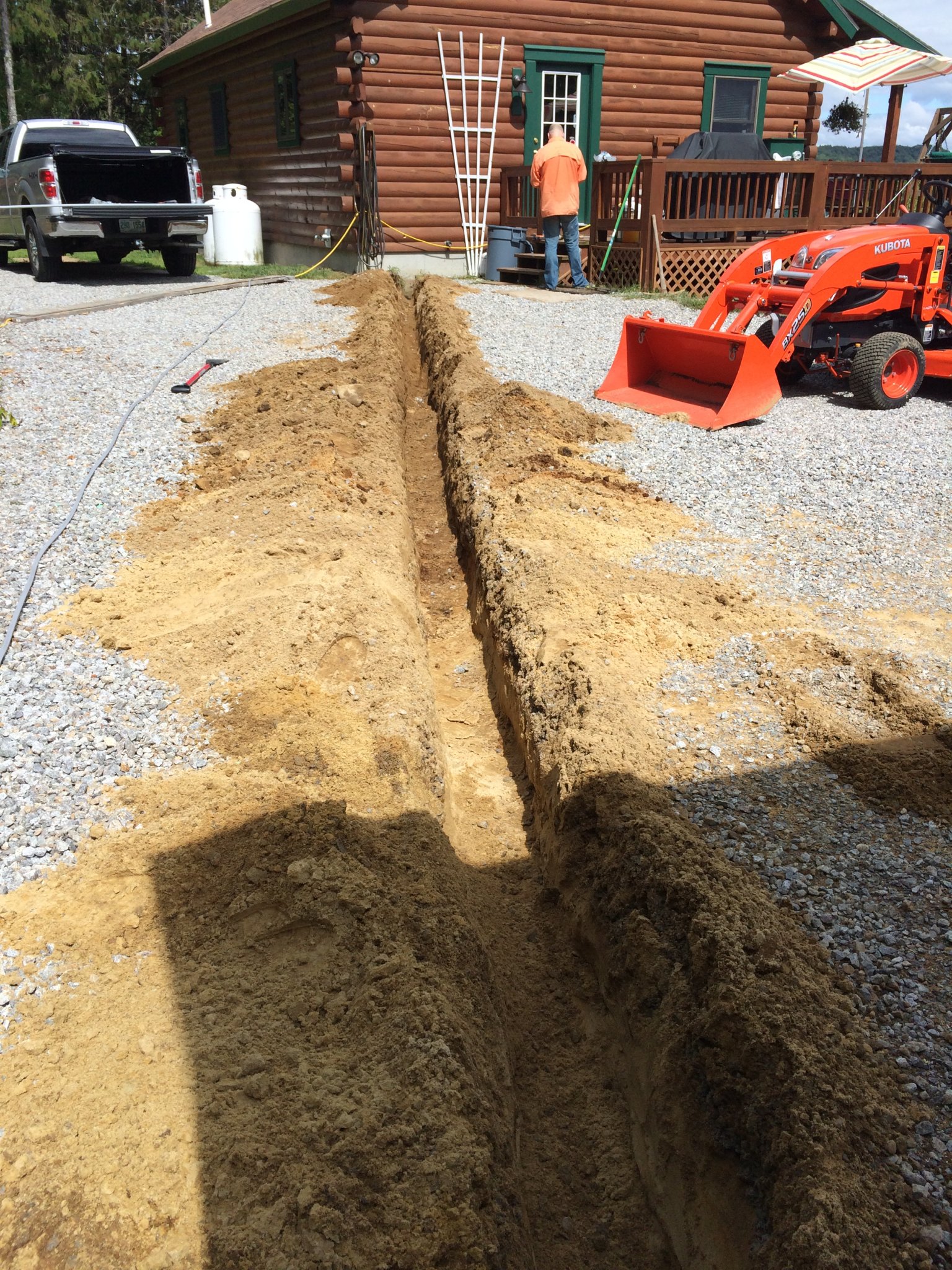

This is my power line trench from my house to new garage…yes the BX25D is a pain with having to keep turning the seat but the back saving work it did was more than worth a little annoyance. Just a memory now…
BX23-S,57 A-C D-14,
13,768
6,246
OK, where's the rocks, boulders and tree roots in YOUR soil ???? lol.
Nice job !!
On the next 'big dig', try the 'push forward using BH' technique. Yes, there is a learning curve,but it's faster than twirling the seat around, and around and around and.......

Mostly SANDY on my property…I failed to mention (as I forgot) I had used my ripper tooth with trenching attachment. Had to zoom my backhoe to see it…that was a product from BRO-TEK. Still have it but have not used it since that day in August 2014.
