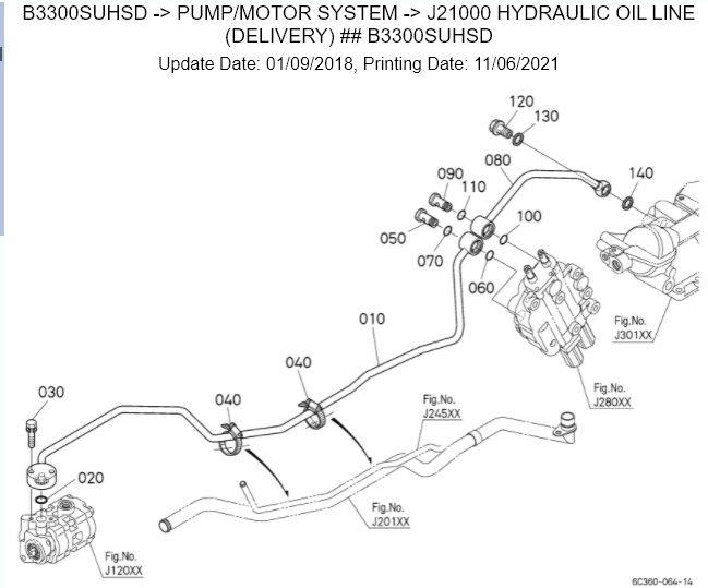

You have a little work to do. Here is the hydraulic line routing on your tractor. Pipe number 80 is the power beyond going from the loader valve to the 3pt. The PB connections to the valve and lift cover are both banjo bolts - probably metric. You will need to replace that pipe with a loop out from the loader valve to the IN port on your add on valve and from the power beyond on your add on valve back to the lift cover. You will also need a new tank return from the add on valve to the sump in the tractor. I can think of a few ways of doing that. The easiest way to deal withthe power beyond loop would be to ditch the pipe and buy two metric banjo to JIC adapters of the appropriate size(s) for the ports on the tractor.
Use the old banjo bolts and the adapters to run hoses out from the loader valve to your valve and from there back to the lift cover.

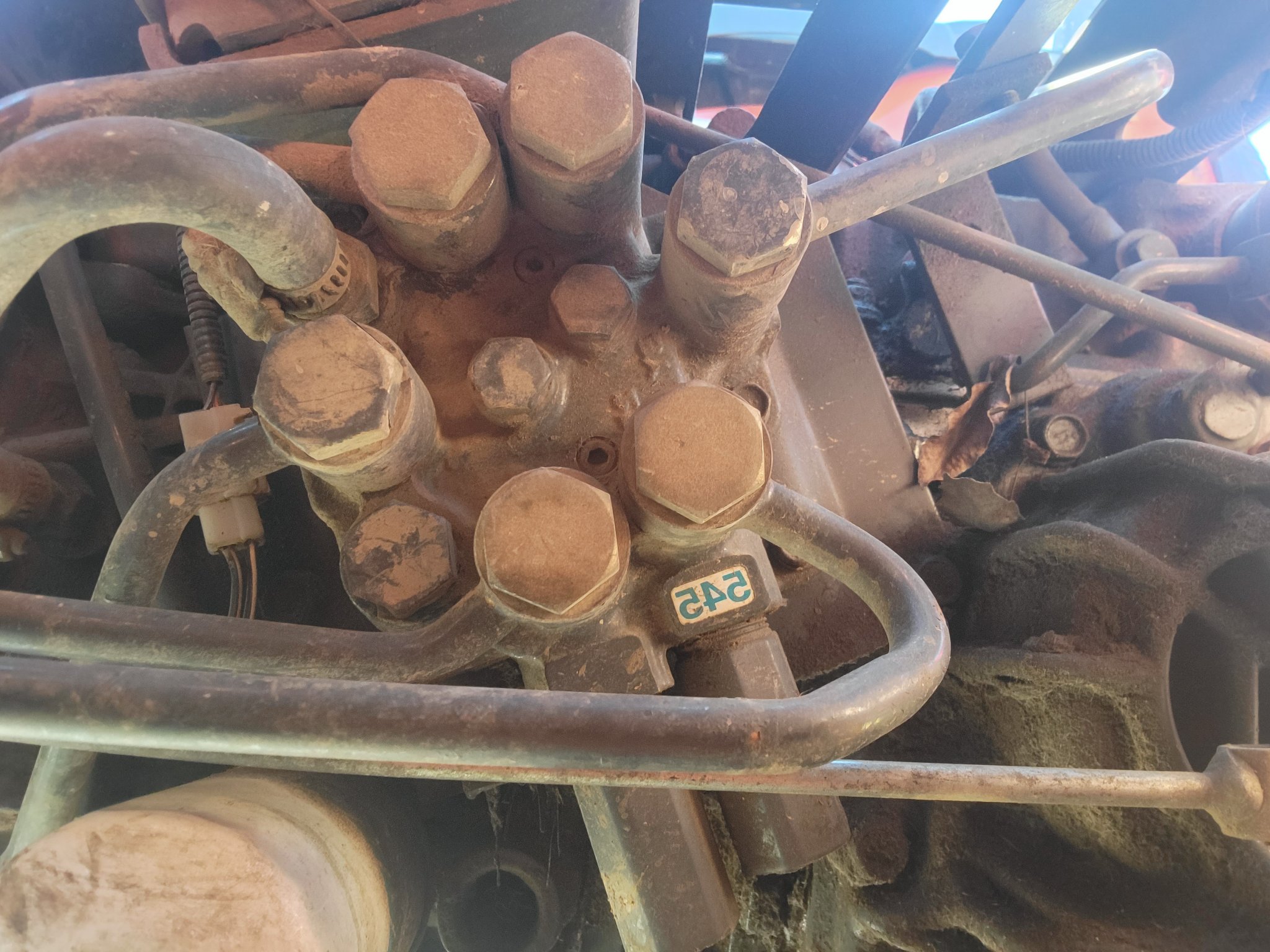

Sorry for the late reply.
Attached is the picture of the block looks like 6 lines. Soo it looks like the PB is the 6 o'clock position?
The "block is your valve. Here is your picture with the ports labeled. I can only be about 99.9% sure of the ID.

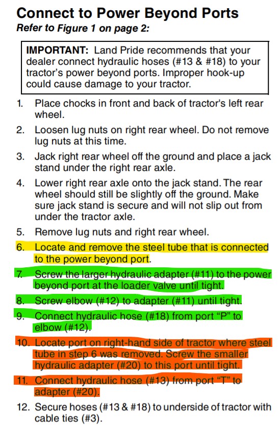

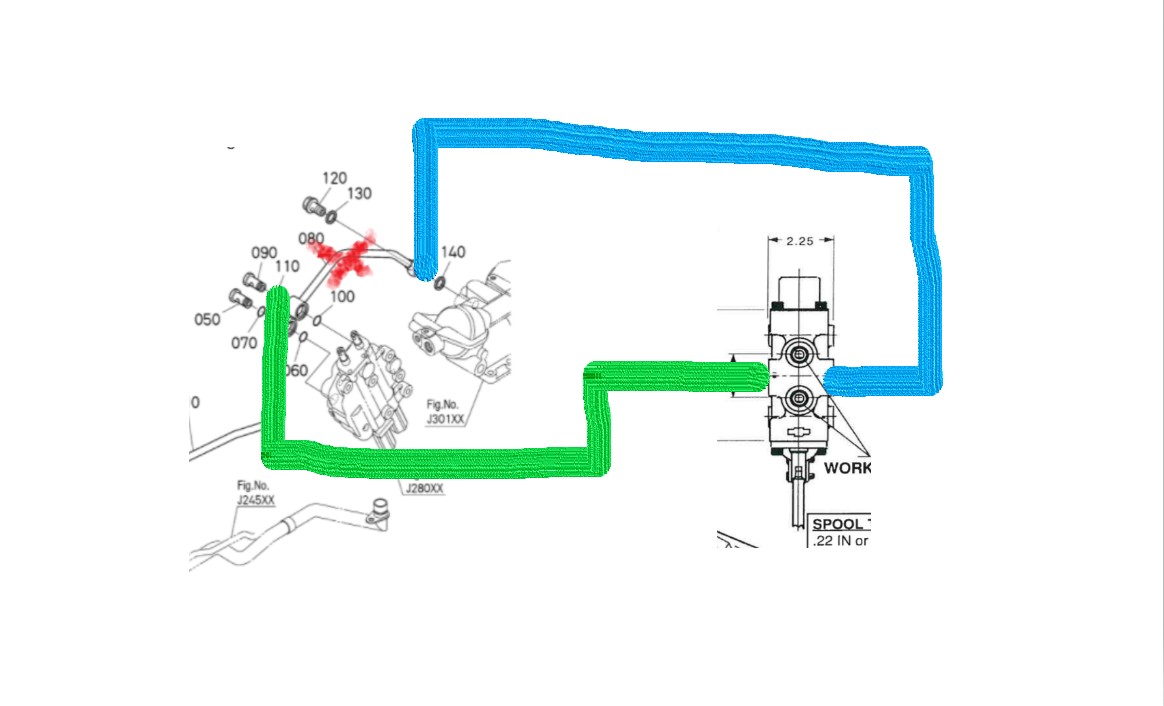

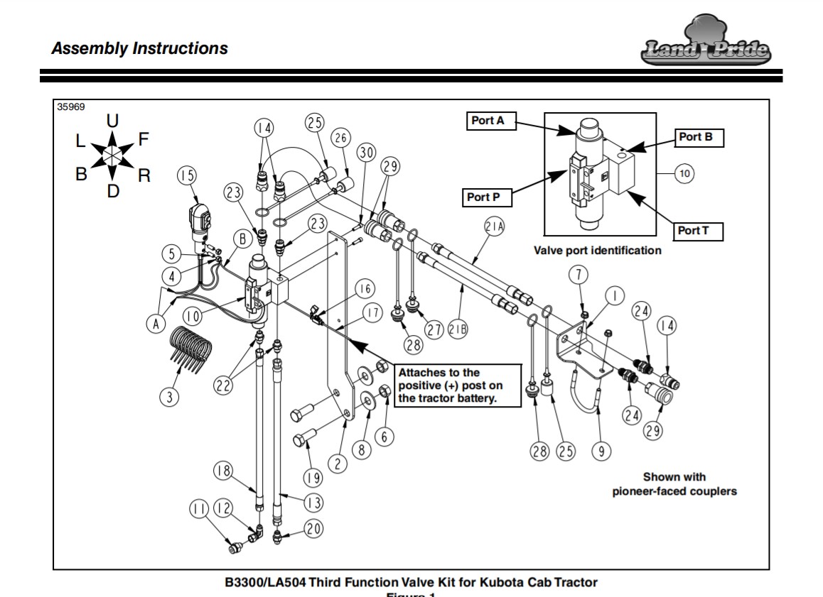

I found this from the landpride website for installing a 3rd function kits I believe it says the same thing you are saying. just to confirm
(Yellow) discard Line 080
(Green) Connect the PB to the Inlet
(Orange) Connect outlet to end of line 080
the above diagram is my interoperation
(green) inlet
(Blue) outlet
Am I understanding this correctly?
8,647
4,413
(green) inlet
(Blue) outlet
Yes. Keep in mind the 3rd function valve is "special" and only has two ports. If you are using a commodity valve for your remotes it should have 3 ports - IN, Power Beyond, and tank. The IN and Power Beyond are connected just like the third function valve in your diagram. The tank port has to go to the sump on the tractor.

What's so hard about removing the pipe that has been identified in the parts drawing and connecting a couple hoses to the ports?
5,768
2,955
