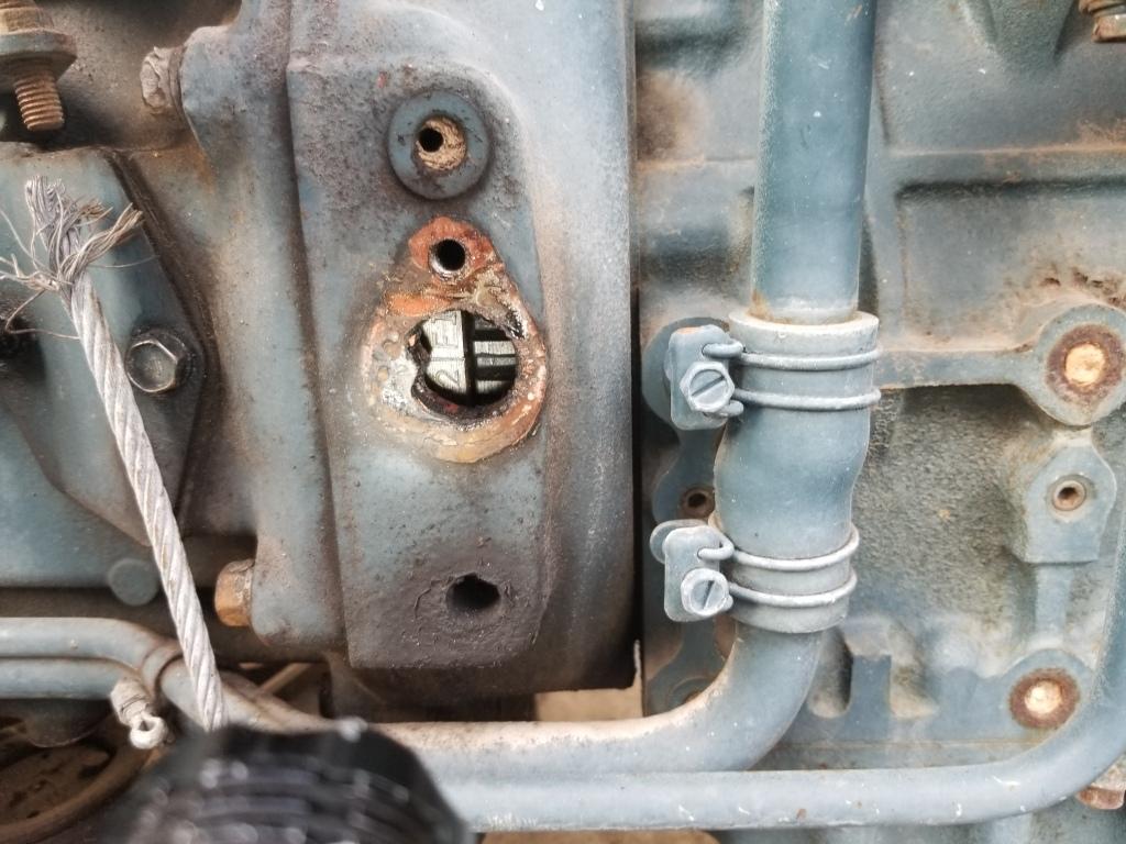

I found the Timing Marks View Port. Moving the flywheel was easy and not too tedious.
All of the valves were a bit sloppy. I would say 0.004 - 0.005 over spec. I can't wait to fire it up. Until I get the Decompress fixed, it will have to wait. I have posted separately on that.
I am curious though. What are the alternate marks that are not marked TC? The one in the picture was market 2 F. Is this a fuel timing mark? I can't find a reference in the WSM (at least my pdf text seach does not find it).
