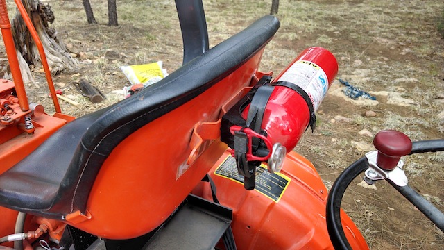

Put mine on the tabs on the back of the seat.
(seat is facing rear for BH use)

I push the metal pull pin thru a small piece of 1/4” rubber on the back side to help retain it.
Excellent mounting idea.
BUT: ....Cheap big box store extinguisher.
Plastic valve head, and plastic discharge lever are TERRIBLE ideas!
The plastic valve/lever will snap/break when you REALLY need it!
Sun and age are the enemies of cheap black plastic parts.

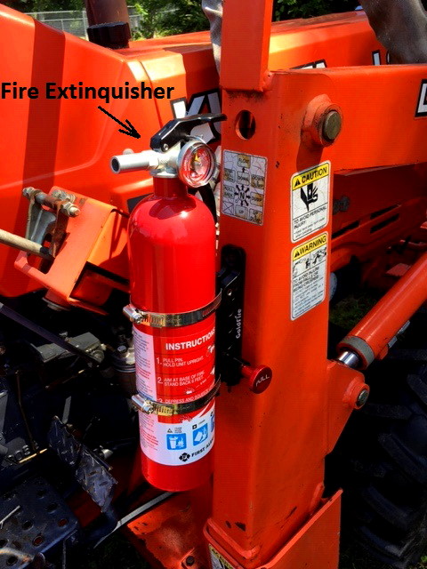

Flint
you drilled two holes into the loader arm ?

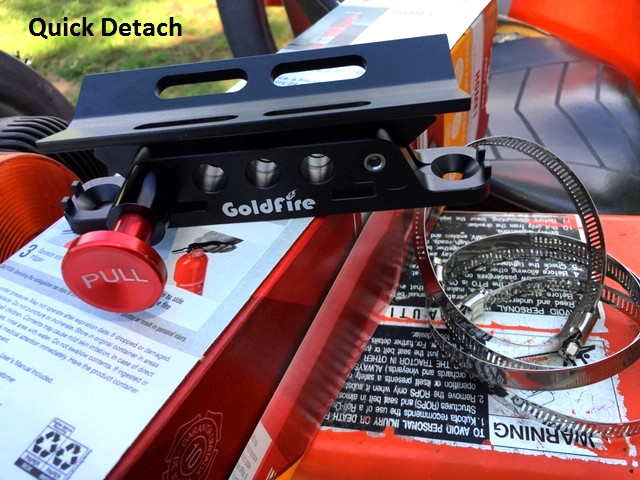

It’s worse than that. I’ve ordered the same mount for myself. Probably mount it the same place and way (thanks @Flintknapper, lots of good ideas to plagiarize here, and some to stay away from). Anyone want a nearly totaled tractor in a month or so?
Well, actually, I’m going to see how I like it mounted on the outside of my Kolpin basket, probably on the right end. I do try to avoid modifications that are permeant, but I design them so they can be unless I undo it, in which case you won’t likely be able to tell.
7,843
5,066

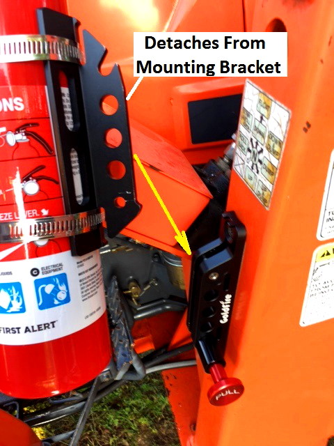

No.
The loader 'Mount'. Its HUGE and very thick.
So, yes.....I drilled and tapped (2) 1/4"-20 holes in the FEL 'Mount' and bolted it on there.
Danger......!
Please tell me .....it ain't really so! 😭
