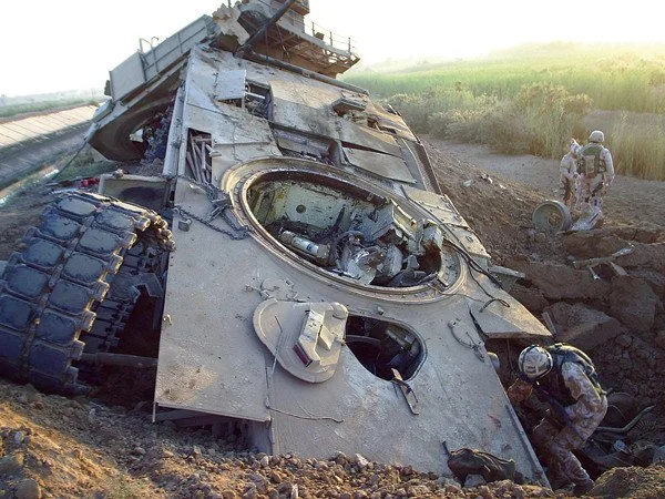

I think on the M1A1 Abrams, there are two sets of carrier bearings as the turret is all in one unit, the floor rotates with it. An IED blew this one off.
