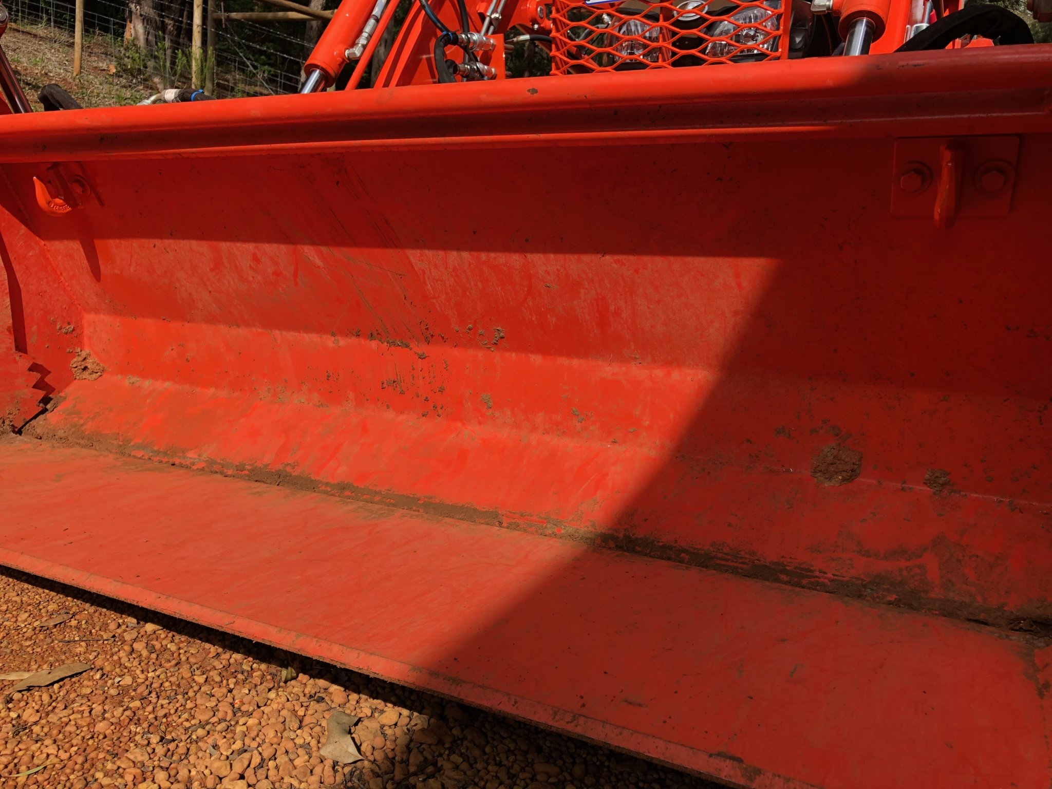

What about a skid-steer 4 in 1 bucket? I'm about to take delivery of my new MX 5200 with 4 in 1 and wondering where I can mount hooks?
Hooks welded inside my BX 4in1 bucket, also the tooth bar installed at the time of the pic
The lines on top of the bucket for the clam cylinders get in the way of them going on top anyway.
Also when inside they are welded on two faces.
Another thing with the 4in1 and having them inside is you can lift a load under the pins by opening the clam so your sling drop straight down rather than over the lip of the bucket

The hole sizes are to suit a 4.7t shackle (standard 4wd recovery shackle)
I normally leave some attached
I can then run the drag chain though shacle or attach a slink or strap
I also have some clevis ends with a few links of chain to go on the shackles.
Works out nice a flexible but if the truth is known at the time I just welded on some steel from my scrap bin
