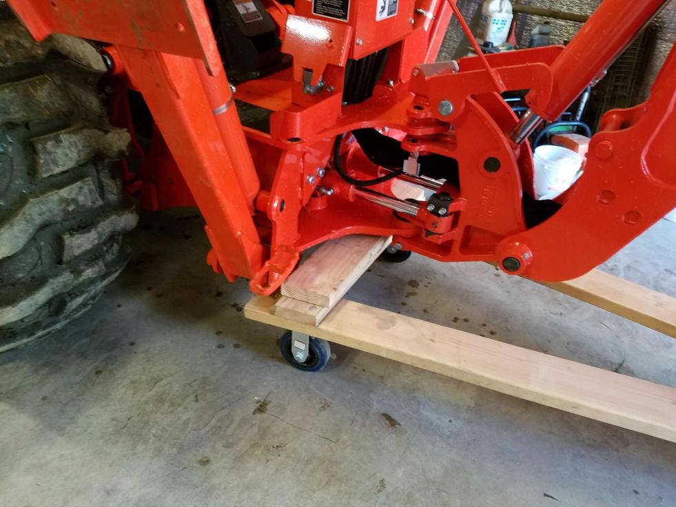

Can I trouble you for a picture of your BH92 dolly design when you have a moment? Many thanks.
Ron, Finally made it up to Washington. Here are some photos for you as promised:

I love it! Excellent solution. I'm currently using four of Harbor Freight's wheeled auto platforms, but l believe I need to frame them together as you have, vs depending on the BH weight to keep the rolllers in place.

My furniture dollies from Lowes work perfectly for my implements. I can move them around easily, even including the 550 lb Kubota 72" rock bucket. Putting them on and taking them off is very easy with the SSQA quick attached loader. I haven't done a backhoe dolly yet but have seen lots of ideas for that on the forum.
You'll find that in a short time the weight and heat will flatten out those style dolly wheels.
You can go on Ebay and get the nylon coated steel rimmed wheels that won't flatten.
Thanks for the heads up.
