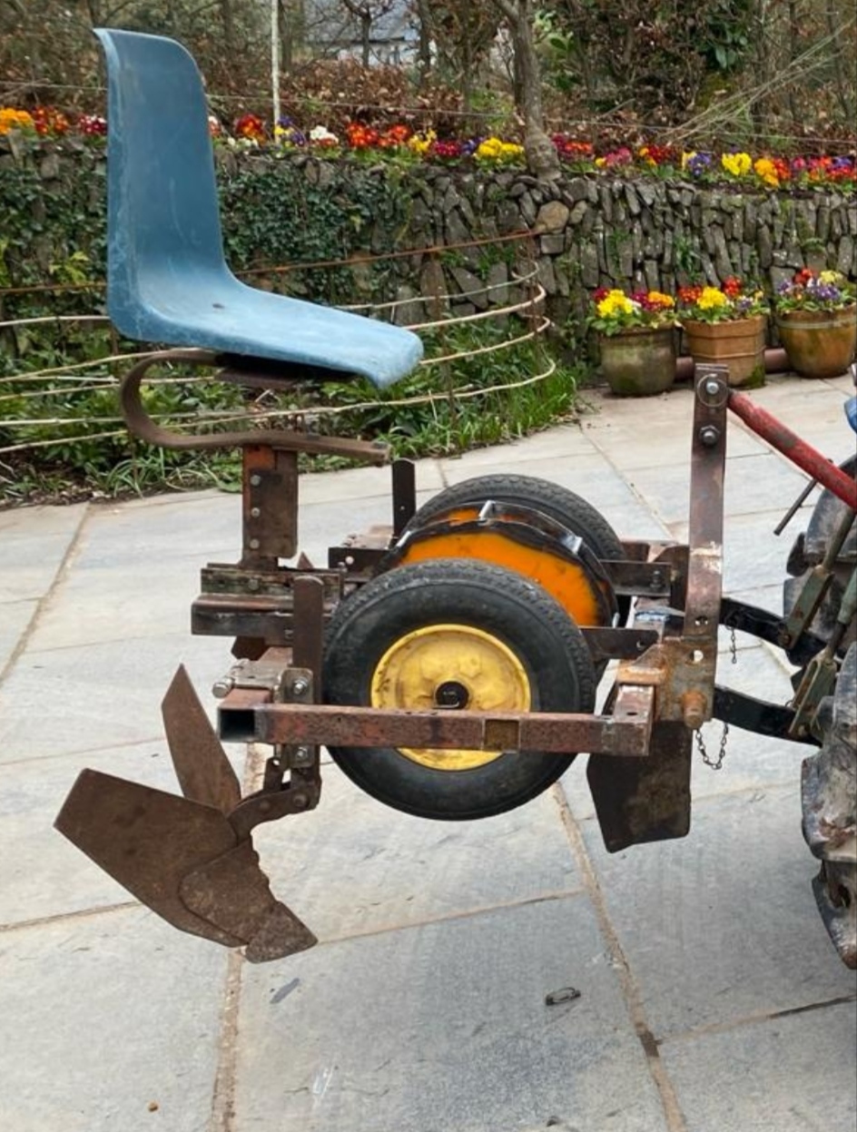

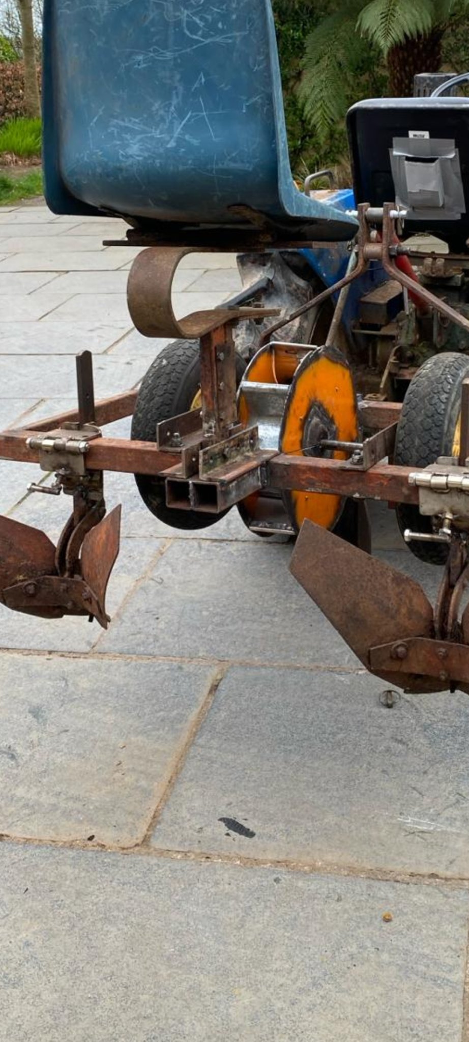

Yeah maybe something with a hopper. This year i made a very crude plough with ridger and a wheel that delivered a spud every 12" loaded by hand but the wheel didn't rotate consistently for me so had to drop by hand.

you've got yourself a good base all you need to do is ad a motor, hydraulic or electric to the planting wheel and a hopper.
Or drive the planting wheel off the planter tires?

Yeah it's ok but I want to be self-sufficient rather than roping in someone. Think Im going to call to my local motor bike repair shop and pick up some old chains and gears see how it comes together with hopper and chain...i might then strip down my existing unit and see can I blend the 2
