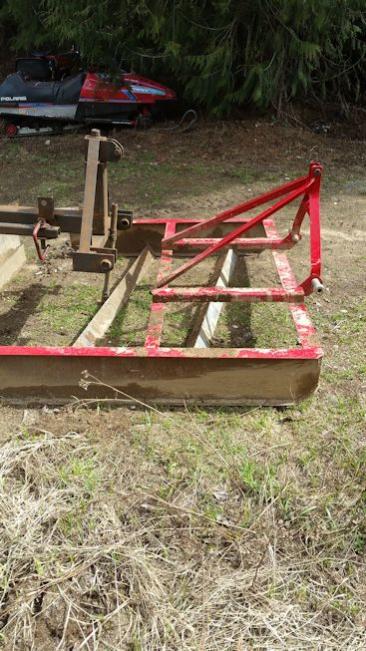

Here is mine:

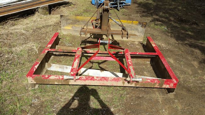

I copied WM's land plane, after borrowing it to grade out my driveway and private road. The AR steel was half the cost of the metal, but it shows Zero wear after a couple seasons of use. The one I built is lighter than Wolfman's, and it doesn't dig too deep, but you need to play with the adjustment. I use my BX, and he has a larger tractor, so a bit heavier is fine for him

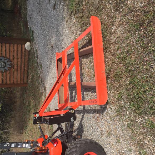

I only want to level out my lawn so I'm thinking light duty. I have lots of decomposed leaves to spread. I have 3" channel from heavy duty relay racks, so 6' long. I also have some 3" angle for cross pieces. I would look around for retired snow plow cutting edges. Does this sound too light duty.
2,617
864
Decomposed leaves may clump instead of spread. The materials sound strong enough, but you may want to add some weight if you ever use it on a harder surface. I welded a steel box on top of mine that I can throw a few concrete block in when I do the driveway.
