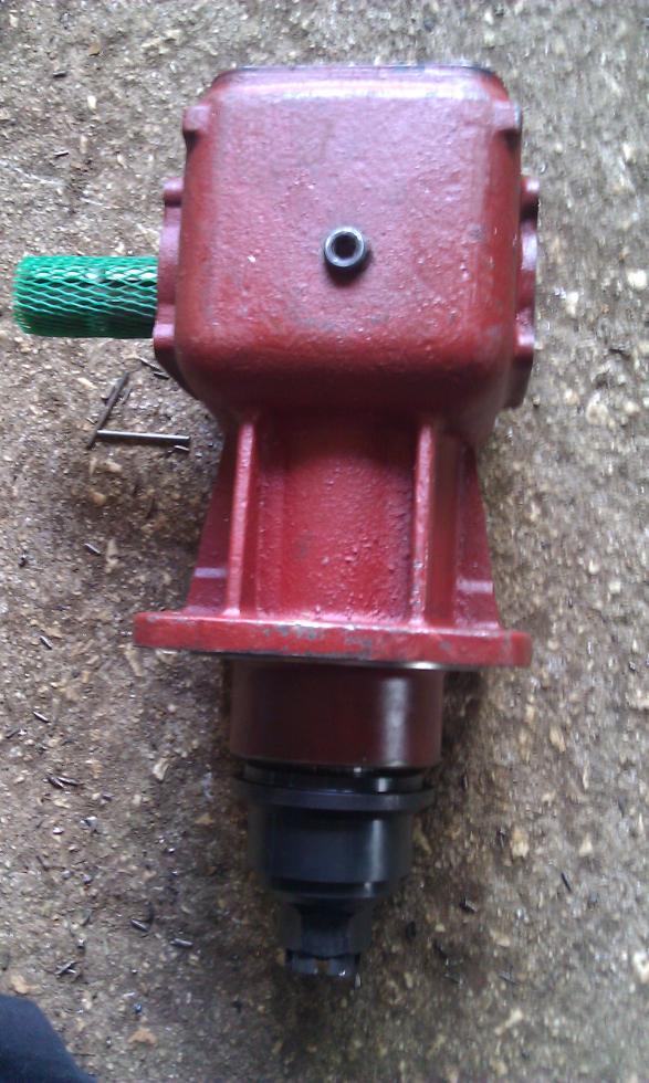

Today i order the (Group) i don't know the name of it, the thing that gives the movement to the chains or the knifes.

That would be called the gearbox. ;)
Alexisferos
L-1501 DT
Oct 24, 2013
245
Greece
Thanks wolfman, in Greek we have different words for the "gearbox" and the "group" because are different things, :p .
That's why i call it group.
the group is only one gear.. :)

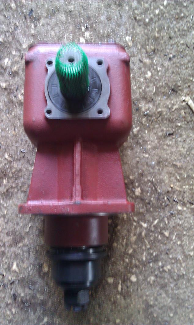

ok small updates, the gearbox is in my hands and i take measurements for the sheet metal, with 5mm thickness and 100cm x 100cm ordered today..

I saw your group? has a spline drive input. You have to have a shear pin/bolt or a friction clutch in the drive line, or you will break something for sure when you hit a big rock or stump. You don't want that something be in the tractor...

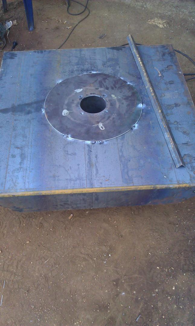

yes i bought the sheet metal, not exactly bought because i had the metal plate but i sent it to the press to create the 2 drops from the sides.
i have read and learn all the posts about how big must be the cutter, that's why i decide to make it smaller, 100cm x 100cm not to load the tractor, i have no problem to make a pass one more time because of smaller cutter,
(i'm gonna do it movable to the side so i will cut next to the tractor and from behind)
i thing that this week im gonna start building it and post the photos.

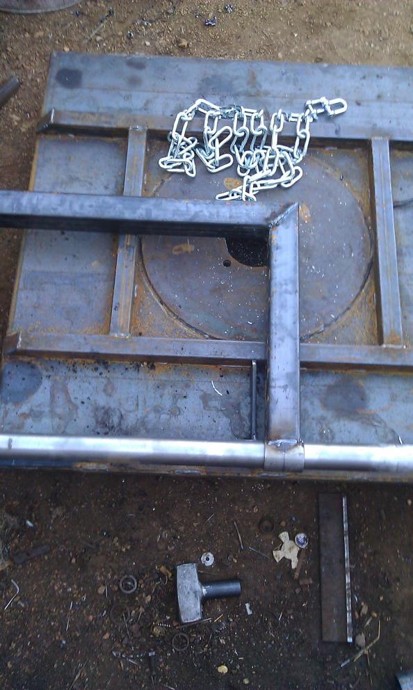

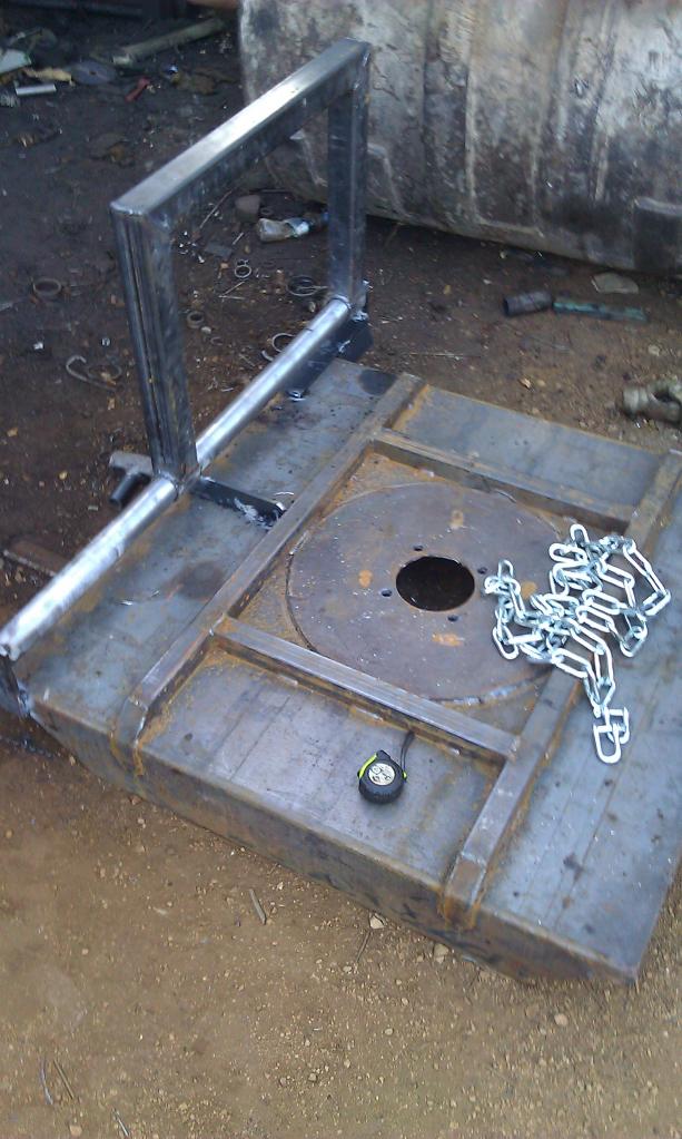

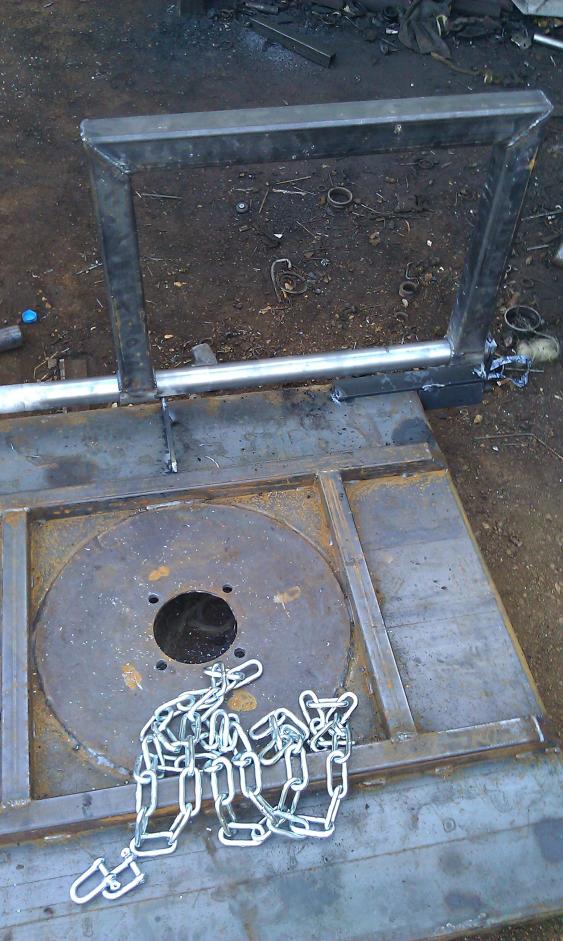

a small update,
i have create the bar that support and moves the cutter from an old hydraulic press, and i buy the chain for the upper support.
as you can see i can move the cutter 40cm out of the tractor and with the chain i can folow every ground..

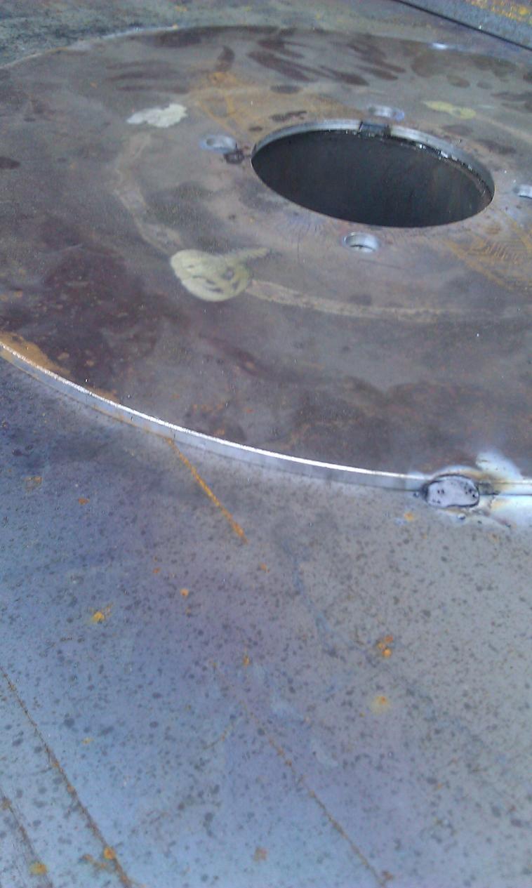

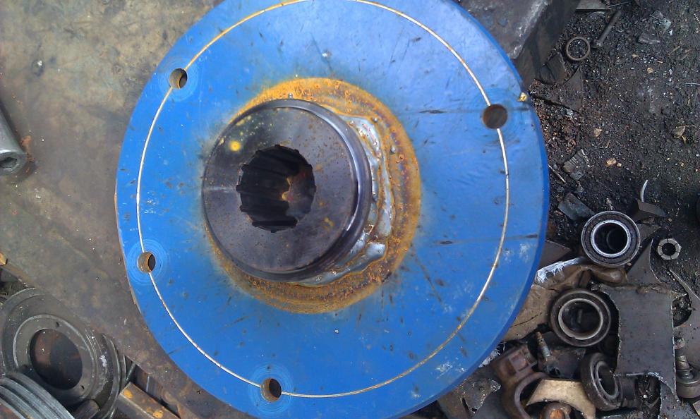

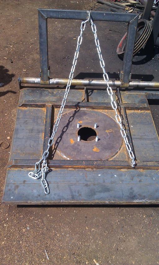

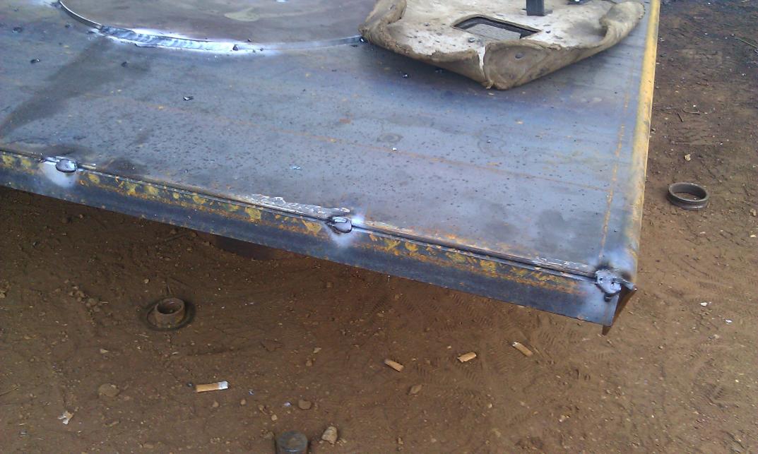

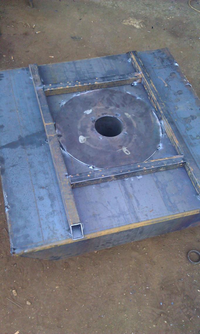

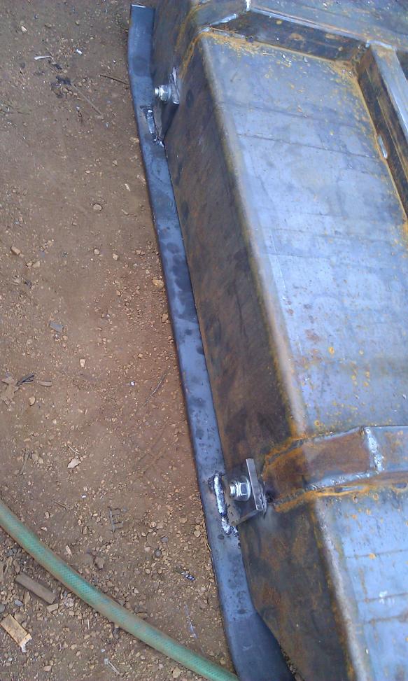

finished product.
well yesterday i finish the cutter and today im in the painting part of it.
3-4 coats of primer and Monday the kubota orange on it.
here are some other photos with the cutter and the under plate where the chains will hook up. i made a combo of 3 and 2 chains, you can see at the holes, if i need 3 i will put 3 and if i need 2 i put 2.
the side slides are removable as you can see.

Alexisferos, is your design so you can slide your 3-point hookup to any position behind your tractor, to make it an offset mower if you need to?
Smallest offset mower I've ever seen was a 9' Bush Hog brand. Nice for mowing ditches or along tree rows.
Nice work, I can see you are detail oriented!!
Smallest offset mower I've ever seen was a 9' Brush Hog brand. Nice for mowing ditches or along tree rows.
yes i can move the mower to every place i need. to a dead zero behind the tractor or even 40cm out of my left wheel..
the pto shaft has more angle to give and the chain will let the mower flow the ground.
until now with the price of the pto shaft i have spent 240 euro~326 dollars.

It looks great so far! Are you going to use chains or blades? Are you going to fit on a tail wheel?
Alexisferos
L-1501 DT
Oct 24, 2013
245
Greece
im going to use chains 3 or 2 (look at the blue metal blade the holes) and it depents of the load.
no tail wheel for now, i will drug it to the ground..
