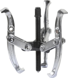

Aaarrrghh…. Borrowed the smallest gear puller they had at AutoZone, tried the smallest one they sell at Advance Auto, Looked at ones at Harbor Freight, even looked at a faucet puller at Lowe’s - all too big. The arms won’t fit between the gear and the pump housing!?
8,685
4,441
Go back to Harbor Freight and buy one of these.
They are junk but they will get the gear off. If you are not in a hurry shop for a better quality set.

Well, the HF puller did work - thanks. Now I just need a few hours of daylight when I’m not at work so I can get it put back together!

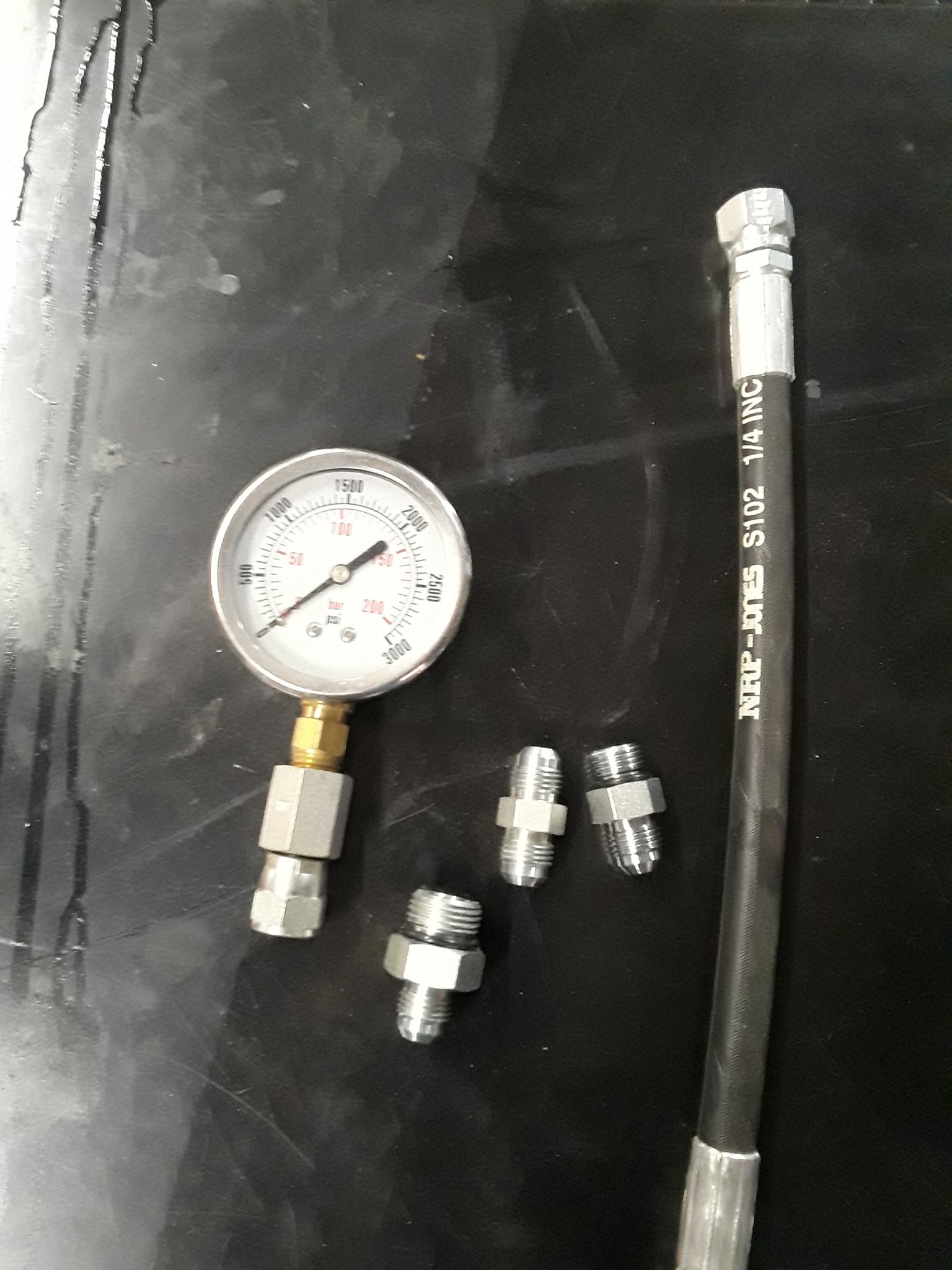

Quit guessing and throwing expensive parts at the problem. Buy a 3000 PSI hydraulic pressure gauge, a short hose, and some hydraulic adapters. Then start checking pressures in the circuit starting at the pump and working towards the rear until you find the failung component.
Thanks. I replaced the hydraulic pump because I paid the dealer for a diagnostic and that’s the work they quoted me needed done.
Assuming I’ve never done anything like this before - can I get this at HF….or Amazon? Will this only work where there are flexible hose fittings? Start at first fitting I can find on outlet side of pump (is following lines pretty intuitive)? What should the pressure be?
On some of other posts, I read about cleaning mesh filter and a certain valve that can clog… thought those were maybe easy places to check?
I wasn’t able to prime the hydraulic pump - if I tried to pre-fill it with fluid it would just run out of the pump before I got it connected to the engine - and once it’s bolted to the engine the hard line to the top was in the way of putting in any hydraulic fluid.
8,685
4,441
Unfortunately dealers and shops like to guess at customer expense.
I doubt HF has what you need but you can buy gauges online for $20 or so. Hoses are the easiest hookup points but with the appropriate adapters you can screw the gauge into ports on pumps and valves. I have most of the items you need for putting together a basic test kit including the gauge. I also make custom hose assemblies for a lot less than most places charge
When testing you need to be careful you dont deadhead the pump against the gauge. The gauge wont like it and neither will the pump. The system pressure relief on your tractor is located in the 3pt valve which means you need to use a flow control setup for testing pressures upstream of it. That's just a couple hoses, a high pressure valve for restricting flow, and a tee for the gauge hookup.
Get a copy of the WSM - it has hydraulic circuit diagrams and pressure test procedures in it. Ask questions here when in doubt and post pictures of the plumbing at your proposed test point. It will become crystal clear once you do one or two tests.
