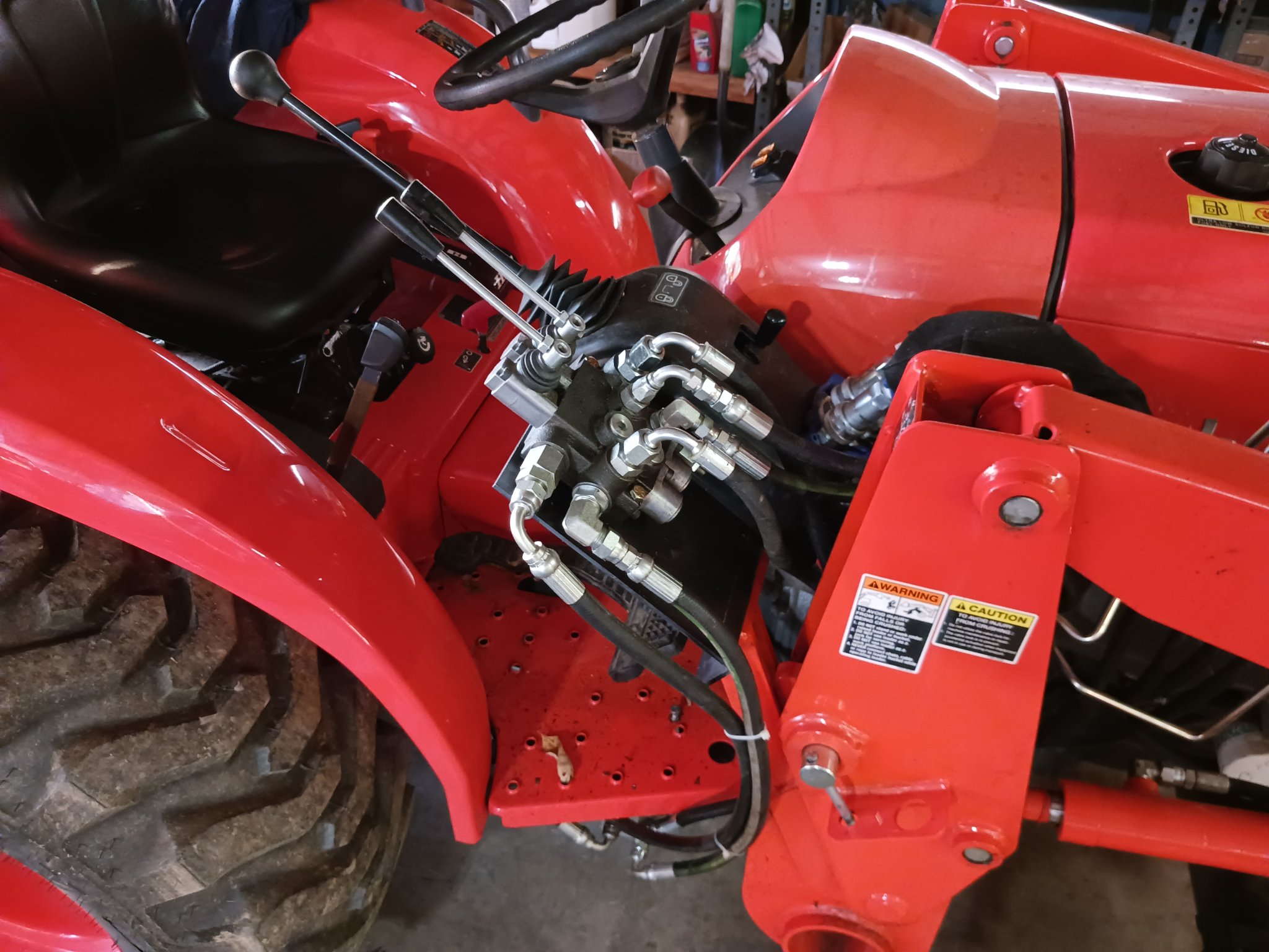

First photo, is NOT mine... it was done much nicer than mine but same location.

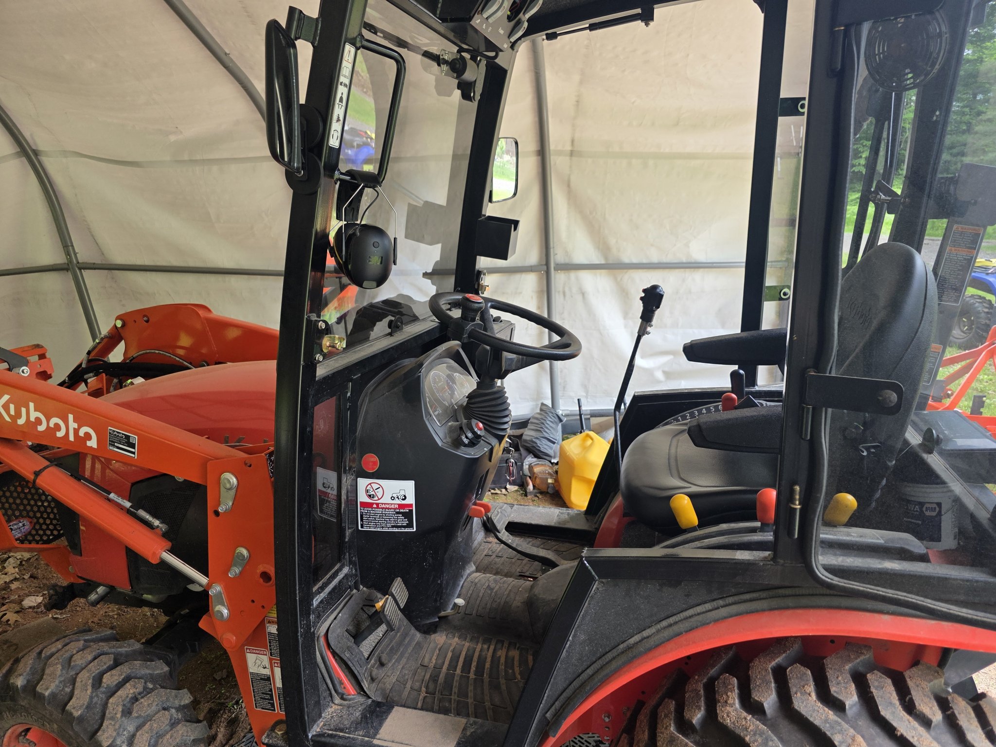

Significantly in terms of placement of the valve and outlets. It will also modestly increase cost. Can you post a picture of tge right side of the operator station showing the control console and sides of the cab? Take it from a distance rather than close up.
I took the doors off for the summer but you get the point...
