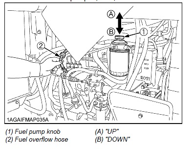

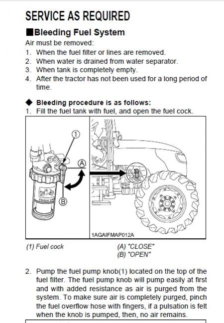

When fuel is dumped into the filter you are risking getting contaminants into the injection pump, since that fuel hasn't gone through the filter.
Never been an issue with me since I bout my first M in 2004. It's SOP to fill the fuel filters on a Class 8 diesel with fuel prior to starting it, I do the same.
When and if it pukes I'll be sure to tell everyone. Up to now, not an issue.
A friend who owns a very large diesel fuel repair center always said that changing a fuel filter and pouring it full of fuel was one thing that had greatly expanded his business. I always wondered why if its a good practice to prefill the filter, why not just bypass it altogether.
Just think of the money one would save by not buying fuel filters!:D

When and if I have an issue, I'll let everyone know.... I do filter the fuel through one of those membrane filters when I add it to the filter. Been doing that for years now. The shop I worked at always did it too. In fact, on the newer Tier 4 final Cummins engines you have to fill the primary and secondary filter or you'll never get the engine started.
Besides on a Kubota, the path of the fuel in the filter is down through the center hole and up and out through the radial holes so filling the filters through the center hole is filtering the fuel.
I have serviced many of them, always install the filters dry, prime and bled the system. They always start immediately.
You can do as you please to your equipment, but you should refrain from telling others to do things that could cause them a catastrophic failure.
