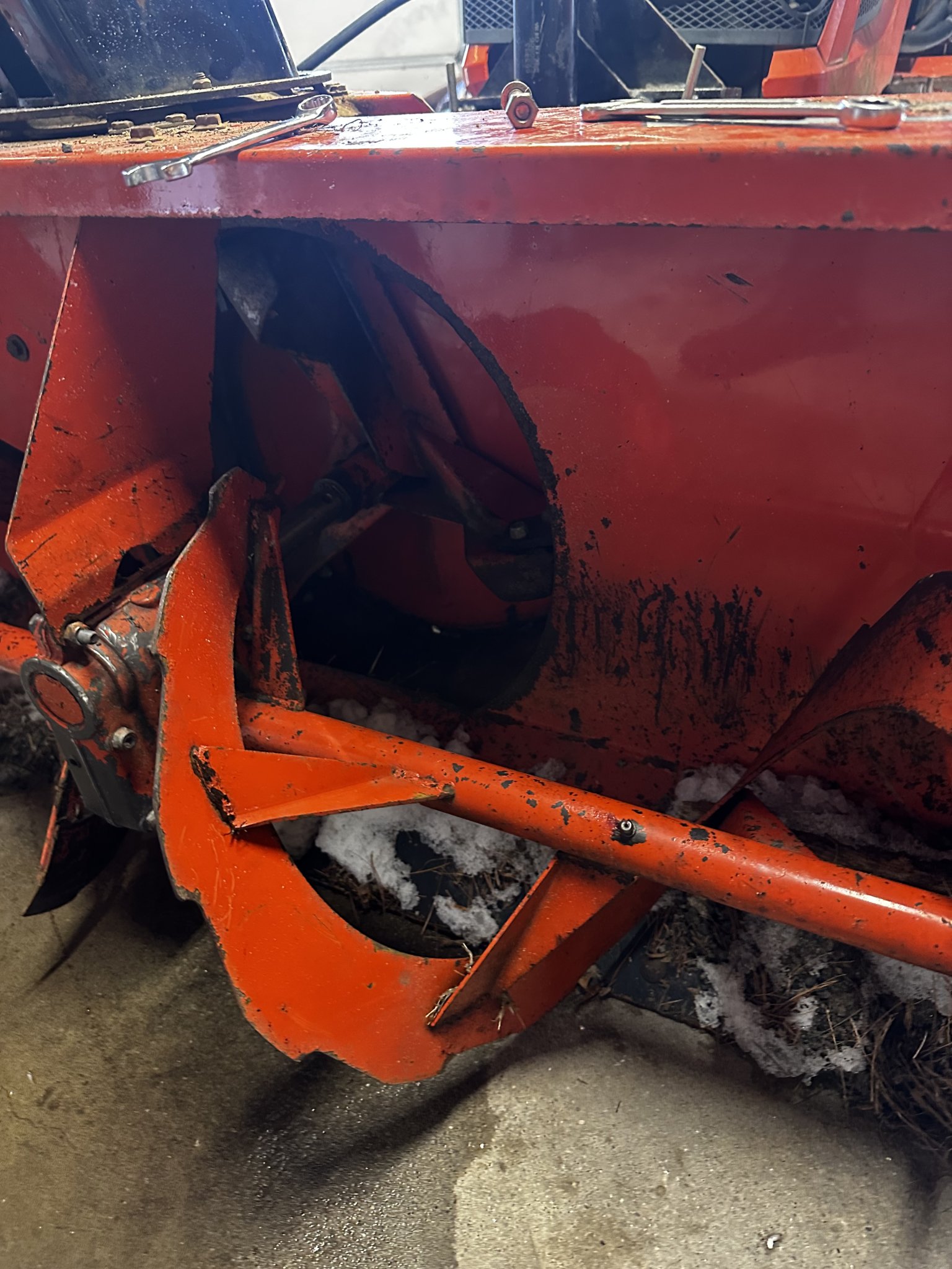

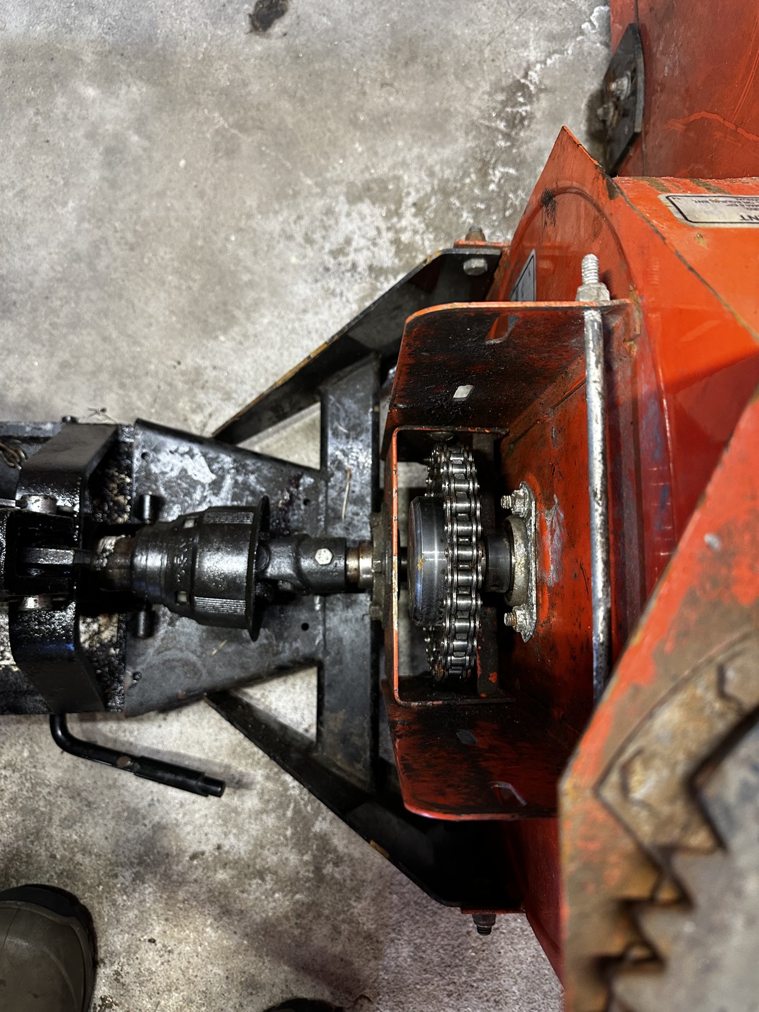

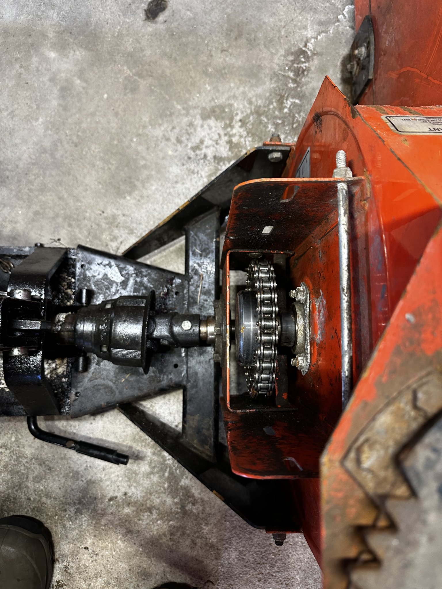

Post some pictures of the snowblower snowing the augers and blower portion. It will help with giving advice. Check the gear on the chain drive to make sure it is Not slipping on the shaft. Should be 2 set screws and a key. Could be the key has sheared off or missing allowing it to slip on the shaft.
RealMainer
BX2350
Dec 4, 2025
New England
I checked and the key is in place with only one set screw. I've just ordered the second set screw but I can't imagine that missing screw (not the one on the key) would cause bad performance but hey, I'll try it! I'm not sure if these pictures help but this is where I am.

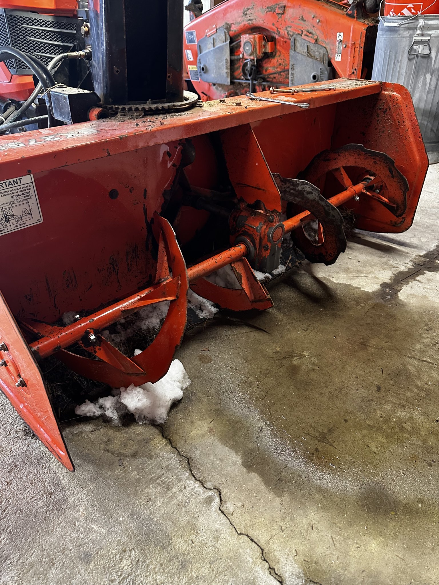

By looking at mine, both augers are in the same orientation on the shaft. Your right one looks off about 1/2 turn in relation to the other.
Would that make a difference ???
That's how it should be- one 180 degrees from the other.
Yours is incorrect and you should rotate one of them.

Augers are alternating on the manual cover page and in almost every BX5450 image found on Google and YouTube. Someone assembled yours incorrectly. It's not about shearing a bolt- it's about efficiency when transferring snow from the augers to the fan.

Curiosity got the best of me today, so I looked at the manual and your right. Mine was assembled wrong . Either at the factory or dealer. Never shearing a auger bolt, I just never had to pay any attention to the orientation. Been running 7 yr like that. Worked fine too. It'll get changed now.

" 'alternating' augers keeps too much snow from plugging up the blower section"
The "alternating" augers is to keep a constant feed of snow feeding the blower. If they are in the same state, you would feed a lot of snow to the blower, then no snow, then a lot, etc... Alternating them should provide for a more even feed all the time.
