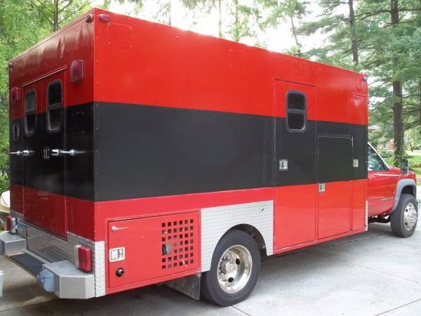

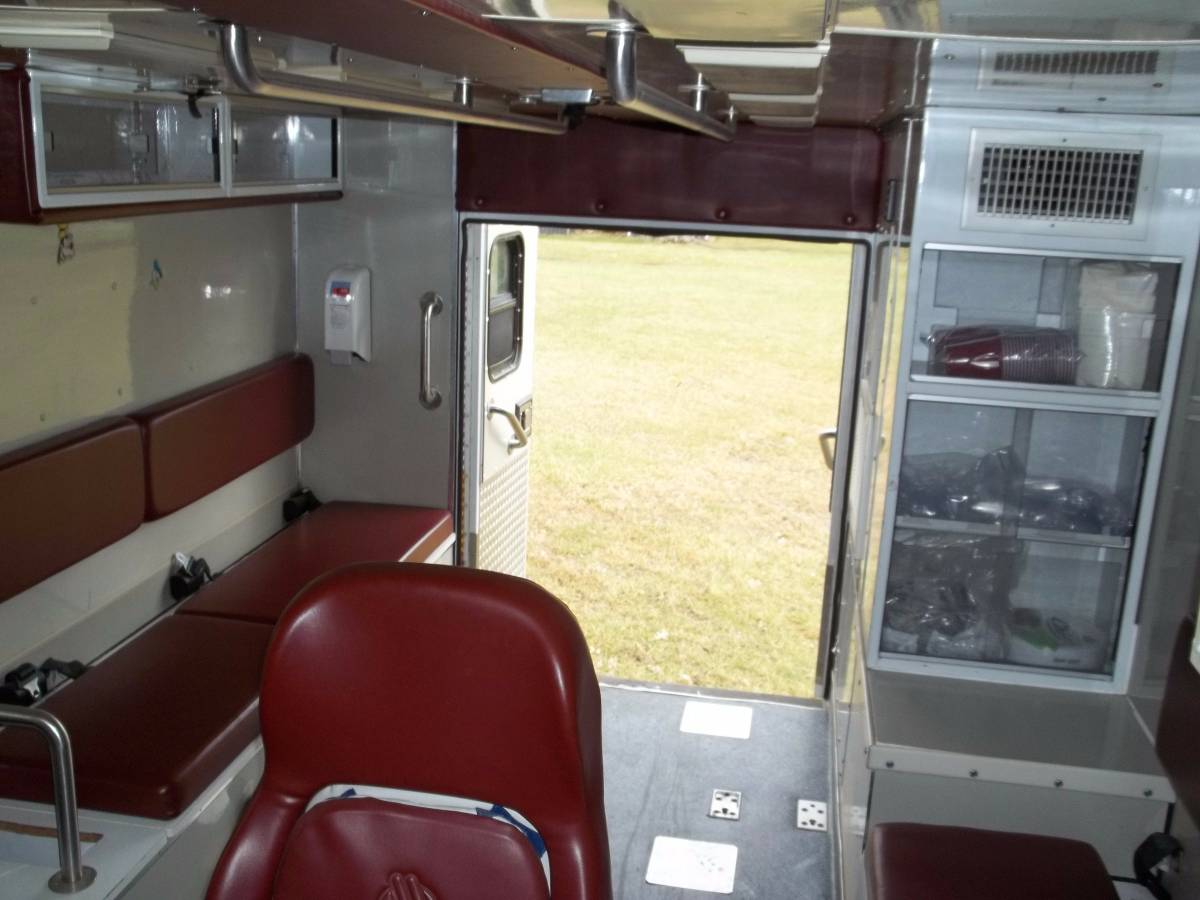

Finding it will be cheaper to buy a box someone has already lifted off or about to do so from their truck who is willing to set it down on my trailer. so might end up with different box than originally planning. ....
Well..... went this route. While looking at Cargo Boxes off back of trucks.. in same price range found an ambulance box....... pre- wired for a Generator, Generator runs Heat or AC... sound insulated Generator cabinet on slider, Ambo shelves still intact. There is lighting.. TON of storage on outside too. All these together along with the seller will help get it on my trailer......... will save a bit of $$. Paid a hold (55%).

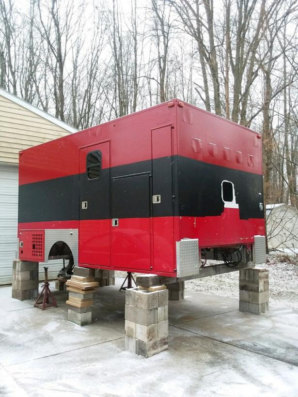

Took about 12 hours total..... but got the Rolling tool box on the trailer. The 12hours all added up from driving 40miles at 45mph there, jocky trailer under Ambo on its stack of cement blocks, build rack of 4x6's* plus for Ambo-Tool box to sit on trailer, strap her down, then drive back home at 40mph....... But she is home. Well sorta... Parked her on the road for now cause it's complicated jockeying the trailer in and out of my spot at home so left that up to tomorrow before work.
Pics to follow soon.
*rack simulates a truck chassis so Ambo Box is supported as designed just as if it was sitting on a truck.

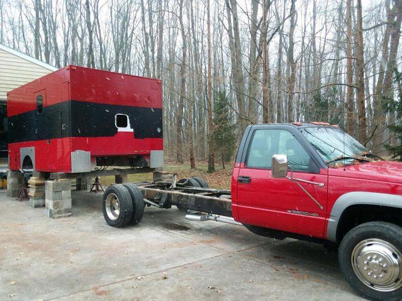

here we go

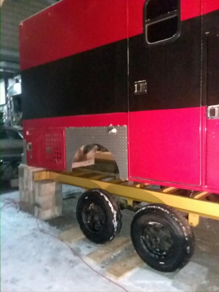

Roger removing ambo body
Brick by Brick
picking up more wood at HomeDepot

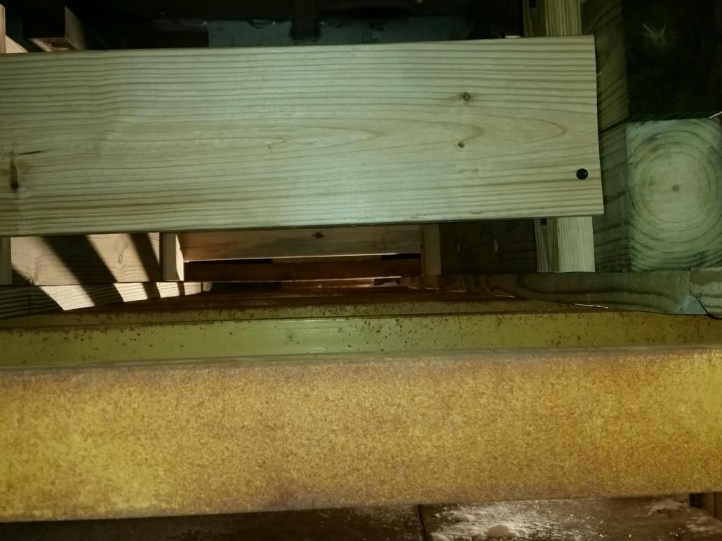

As you an see there is no deck on this trailer. We built two stacks of 2 4x6, and 2 4x4 to rise above trailer's cross members to support the Box as if it was a chassis on a truck. Boxed these stacks in for strength. More to do.. but it was enough to get me home. Didn't plan on needing second 2x4 in the stack but had too to clear the air conditioner's condenser on bottom of an outer cabinet at the back driver side outer storage cabinet. With it's fan removed we have only once inch clearance. I'm going to redo fan mounts. Probably will sit vertical on the inner wall of the former wheel well. That is ifff I decide to keep AC working.
trailer backed under. We removed trailer from my truck and used a hand jack to finite controll the trailer. had only mm's to clear bricks

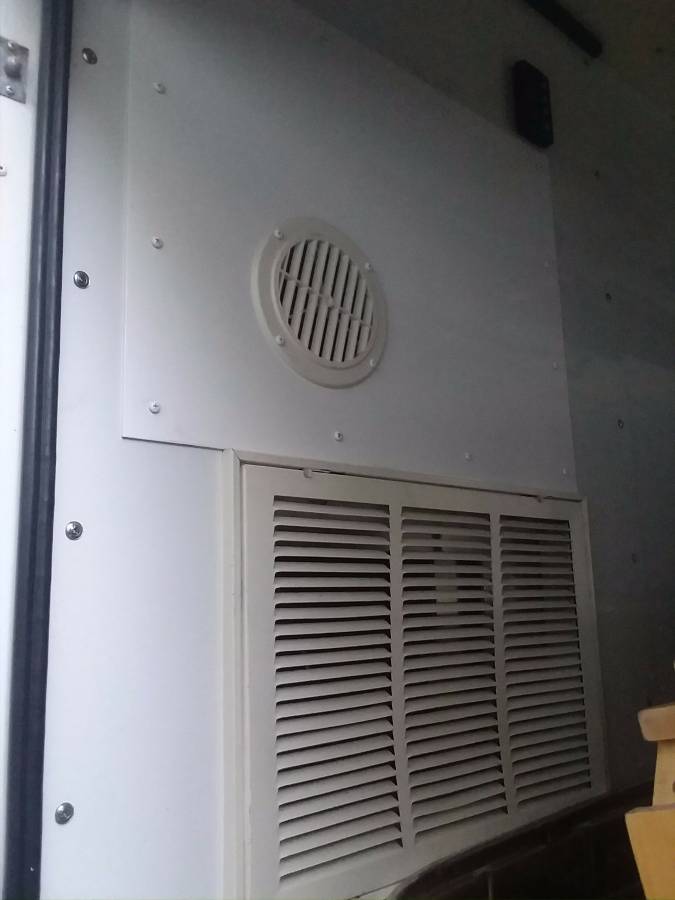

Finally some good weather. Starting back to work on this toolbox on wheels and run into a snag. Was hoping to start clearing out my sheds with tools randomly stuffed everywhere and put into this ambo today to start organizing my tools. grrr but it is too wet. Need a few sunny hot days to air it out.
The benches inside have a good bit of water inside them. Could this be built up condensation? Leaks? Most the lights on the sides and back were removed and there is a metal plate covering them but after speaking with Roger today (seller) they were siliconed pretty well. While not on outside edge of the cover plate but right next to the opening in the body where the light use to sit. In the conversation he said he had same issue and this was why he replaced the lights with the plates.
There is no water anywhere else though. Rear windows are broke out but covered. Front cab to truck window/crawl thru for now only has a plastic bag taped over it. What to yall think? Roger things it might be the clearance/running on top edges.

thanks.. but this area had inch of water on the low end. Will need more than than beads there but for other places.... GREAT idea
34,119
9,302
Silicone make a horible seal on metal to metal where they have the ability to flex at all.
A much better way of sealing any plates that cover holes in the body would be polyurethane (windshield glue).
