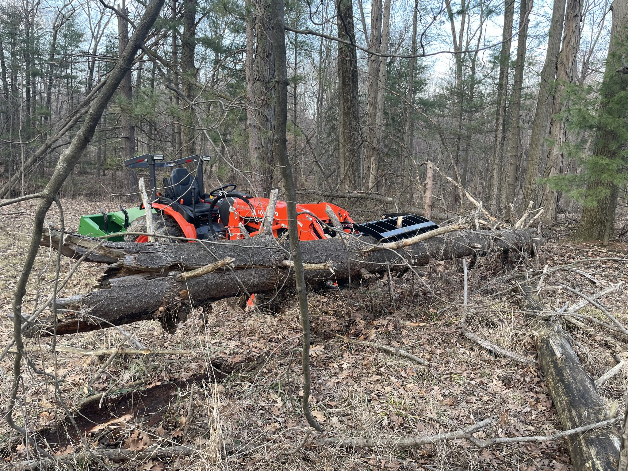

The 60" bucket has the same steel thickness as the 54" bucket. Kubota calls it "light material' because if you were to load it heaping full of wet sand the loader would not lift the load as it would be too much weight.
I got a quick hitch from the local farm & fleet store was $199 on a black Friday sale last year. made in India welds look good it weights 81 pounds and has an adjustable top hook.
I have the Kubota 3rd function on mine. The thing I like about it is the hard lines for where it runs along the loader arm. Also really like the control knob. What I'm not as fond of is the hose from the solenoid valve to the hard line is outside the loader frame. I haven't snagged the lines yet but that was the chief reason for not getting the swift tach option for the loader is my woods are pretty tight and my LX2610 is on the big side for working in the woods.
The rear remotes are pricey but I would get at least 1 so you can use a hydraulic top link. I have a 2nd remote but I do not use it near as much as I do the 1st one.
Also consider getting the tires loaded with RinGuard it makes a big difference in traction. I have the bigger Std L size 15-19.5 R4 tires on mine but you can only get them with a ROPS tractor. They will not clear the fenders on the cab version I am told. I got the ROPS because of all the tree branches I have to deal with. You might want to consider spacers with the Cab version as they tend to be more top heavy.
