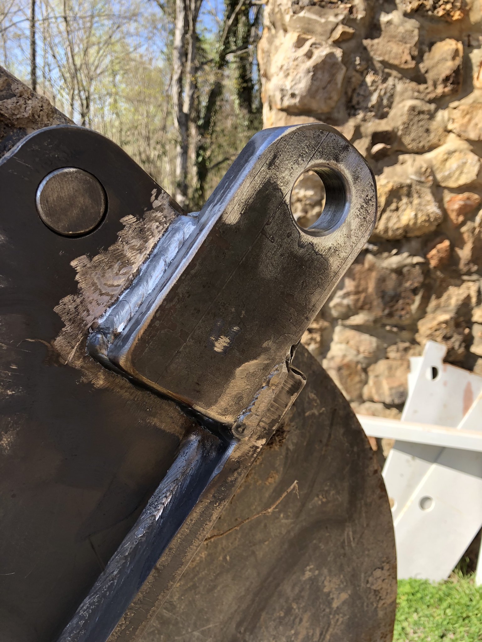

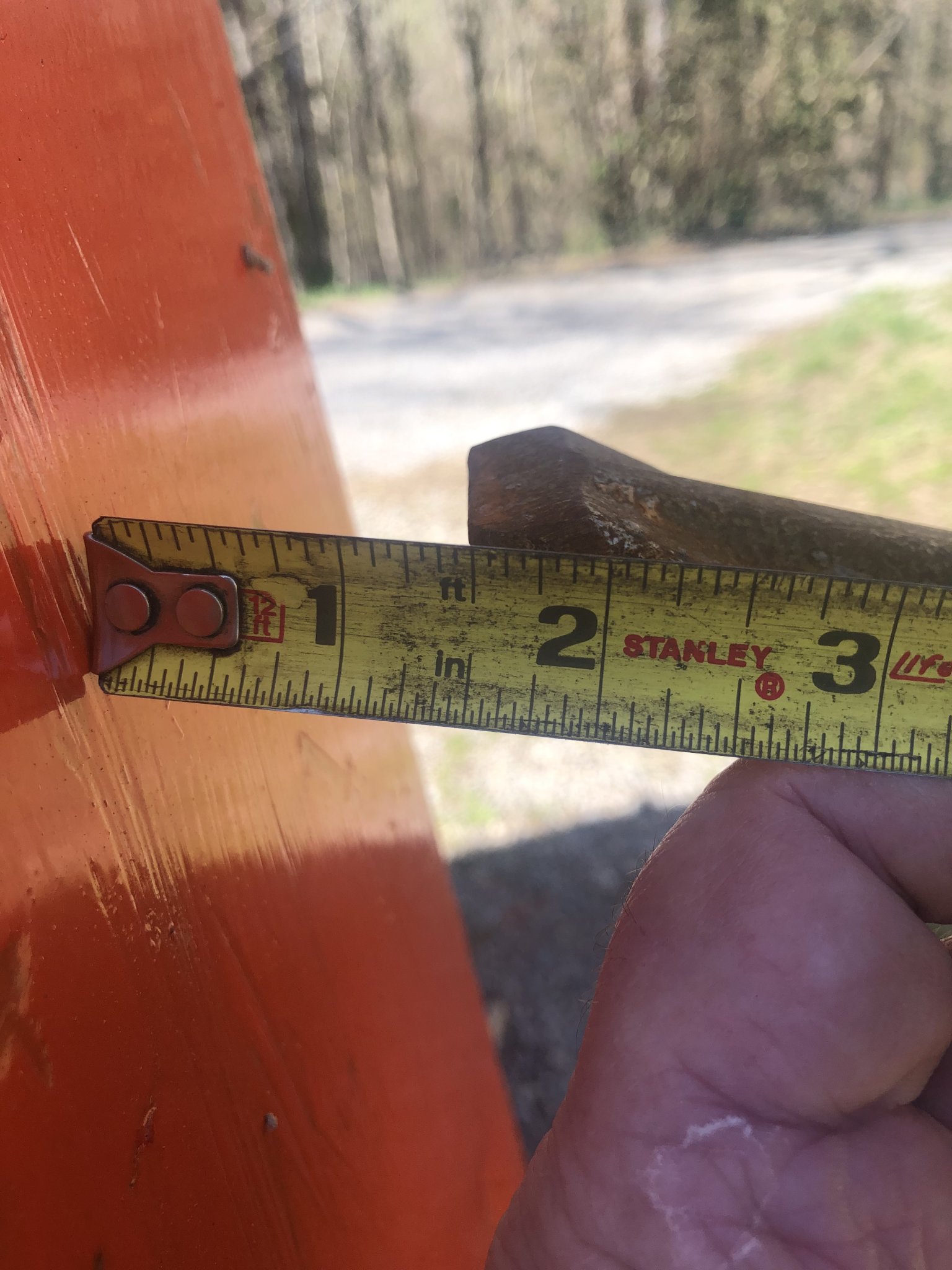

Might want to check your dimensions if you don’t want a longer ripper to hit your boom. B6878887-0718-412B-AF8E-E3ADA4442329.jpeg
Welded on shackle mounts to tripod the ripper up when off the backhoe so it doesn’t flop on its side. Also handy to attach rigging. Dealing with tree there is always pulling and tugging.

Might want to check your dimensions if you don’t want a longer ripper to hit your boom. View attachment 99155
Not sure what you mean.
With the ripper hanging like the bucket does, how could it hit the (boom?) dipper?
It will hit the thumb, but the bucket hits the thumb too, and that is Ok with me.
The "Manca" rippers ($1,700 + ship) are even longer at 31", and are made for the same Kubota Mini Ex Q/A system.
The OX ripper that I am considering is 28" long.
If it were to hit the ( boom?) dipper somehow, I could just create a physical stop.
The boom is the first, usually curved, attached to the tractor section of the backhoe. Not the dipper, not the thumb.
Longer might work for an excavator.
Good luck.

Unfortunately the L48 boom is only very slightly curved.
I doubt that the 28" ripper will curl up far enough to catch the boom though, but if it does, I think I could make a mechanical pin stop for it, or cut the ripper length down just a bit.
The OX ripper that I am considering, is a bit different from the style that you have, and the length could be easily modified.
Thank you for the heads up!
I will take some measurements when I am at the tractor next month.
