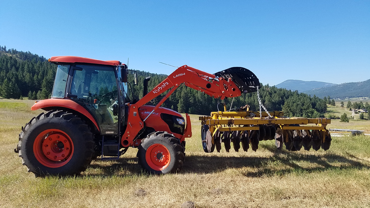

You need to use a weight on the rear of the 3 point. If you stop to figure the amount of weight that you are adding to the front axle when used as shown you will quickly realize that you are overloading the axle. The rear weight will transfer some of the weight to the much stronger rear axle.
Yes it will pick up the load but at what cost? Weighted tires and wheel weights improve the stability of the tractor but they do nothing to reduce the strain on the front axle.
10,847
5,957
The tractor and front axle are designed to handle a loader and nothing in the Kubota docs says you need a counterbalance to unload the front axle. I think this is a total red herring.
One could speculate that by adding a counterbalance you are doubling the effect of the loader and overloading the rear axle.
Why would you want to argue about physics? The weight hanging off the three point will reduce the weight on the front axle. Look at any tractor with a front end loader. All the weight is transferred to the front pivot that holds the axle to the body of the tractor no matter the brand of the tractor. Now move the tractor and drop into a hole or hit a bump the shock load is transferred to the small load bearing surface. The result is wear and tear on a machine that could easily be avoided and prolong the life of the machine.
The additional weight also caused wear on the FWD gears and the weight bearing surfaces of the front spindles. In addition the weight of the 3 point attachment improves the braking ability of the tractor in 2 or 4 wheel drive.
10,847
5,957
I am not arguing about physics - in fact it was my major in college. I am suggesting the Kubota engineers designed the front axle to handle the additional loads that come with a front loader. Why would you think otherwise?
