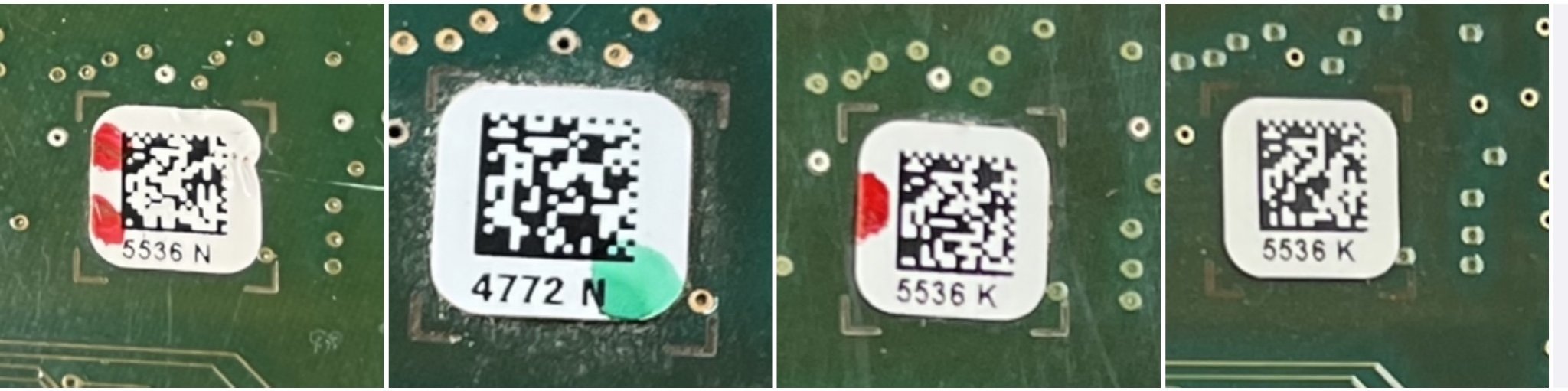

Would the following stickers on the control boards refer to firmware?
Two on the left are for the 2 TB drives (old and new) and the two on the right are for the 1.5 tb drives (again, old and new). Red dots are the new drives. Both new drives work normally. Even after playing the swap boards game.
edit: the 2 TB are different but the 1.5 TB are identical…

yes, probably 'firmware' stickers ..you can probably read the QR code info with a 'smart phone'.....
