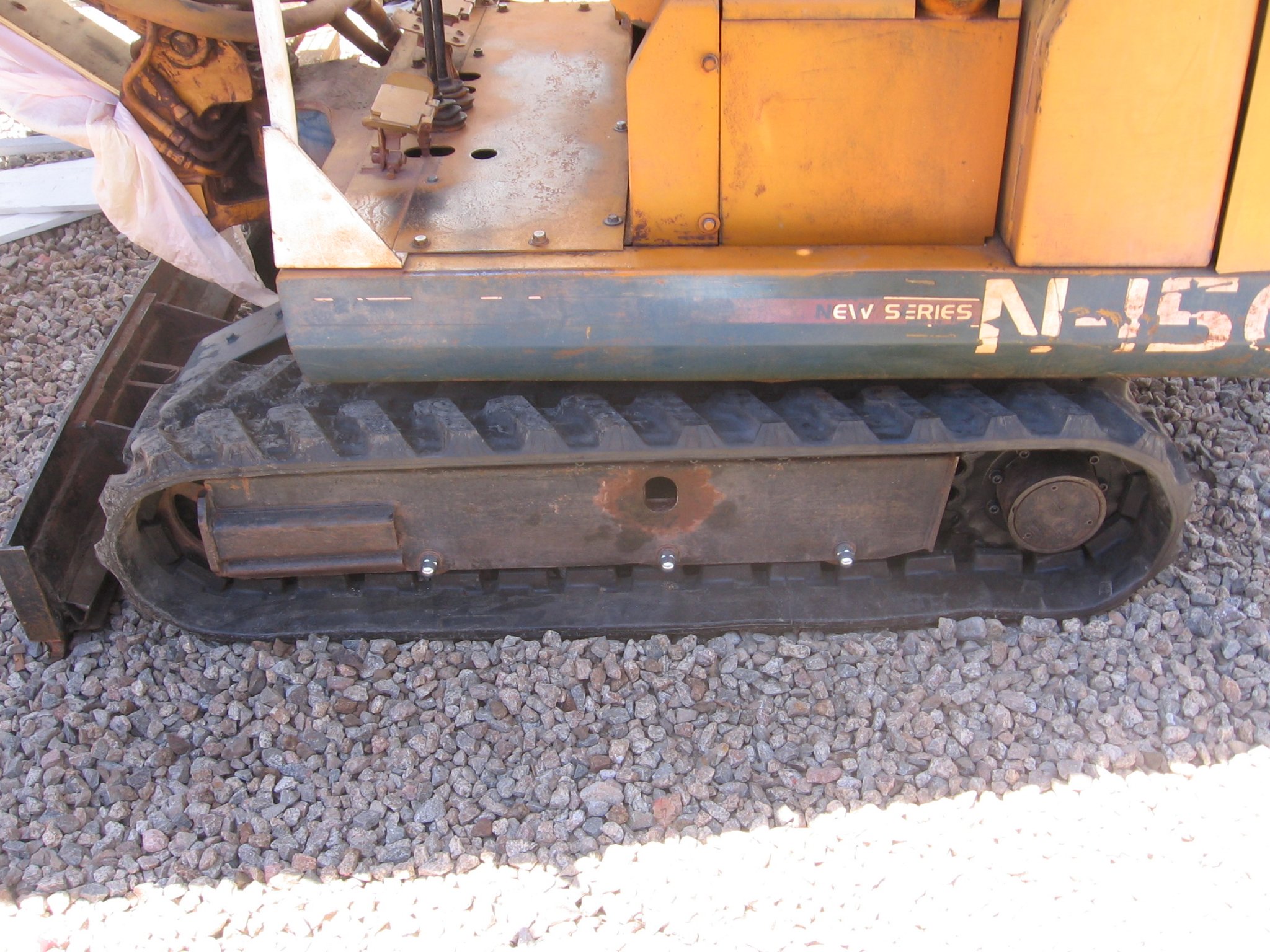

Finally got the new rubber tracks mounted! :D
Kinda tough in 108F heat, but not too bad once I had the method figured out.
1st one took maybe 30 minutes of wrassling, second one maybe 10.
(these things are heavy & stiff!)
It took 28 grease shots on one side, and 30 on the other to tension the tracks.
Didn't get to drive it much, but it is way smoother, and way quieter!

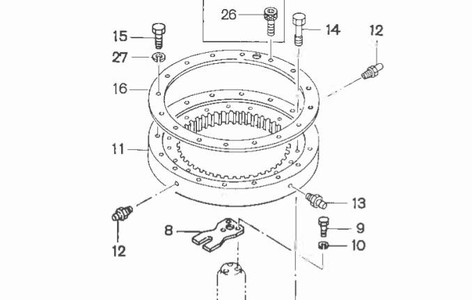

Making slow progress.
Thought I would grease the three zerks on the ring gear, but could only find two.
Manual clearly shows three.
So I spent an hour+ underneath in 105° heat scraping the outside of the ring gear, revealing the two recessed zerks I already knew about, and a non-recessed allen set screw.
I could replace the set screw with a zerk, but it isn't recessed, so it would be sheared off when I swing the house.
Must have been a design change that the manual doesn't cover, so two grease points will have to be enough.
The (2) #12 are there, #13 is missing.

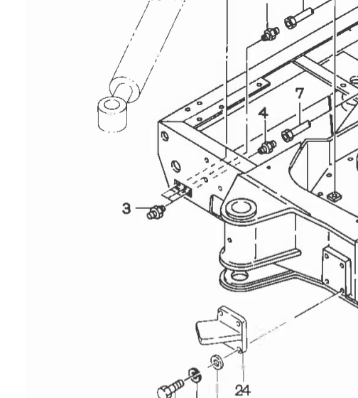

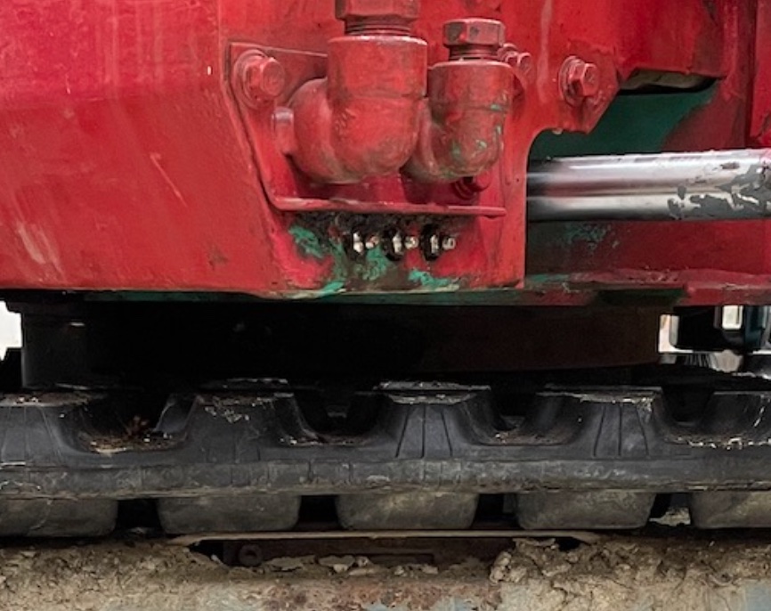

8,206
3,590
Then I attempted to grease the last zerks for the undercarriage, only to find them missing.
These are (3) zerks on the front of the house directly under the connections for the jackhammer lines.
I thought they were just hidden by grease, dirt, and dead possums, but they have been removed. (or lost)
They connect to 3 plastic flex lines that feed grease to the swing gear, the swing ring, and the inner bolt swing cylinder.
The zerks were threaded from the outside into tapped holes in the frame, and there are brass compression fittings threaded into the inside of the frame, with the flex lines attached.
Thankfully, the dirt & crap only entered about 1/2 way through the compression fittings, so the lines are clean.
None of the zerks I have on hand appear to fit, so when the compression fittings come out of the ultrasonic, I hopefully will be able to ID the thread and get some proper zerks.
The adventure continues.
1st pic is from the manual, (zerk is #3, x 3) 2nd is a blow-up of groundpig's machine.

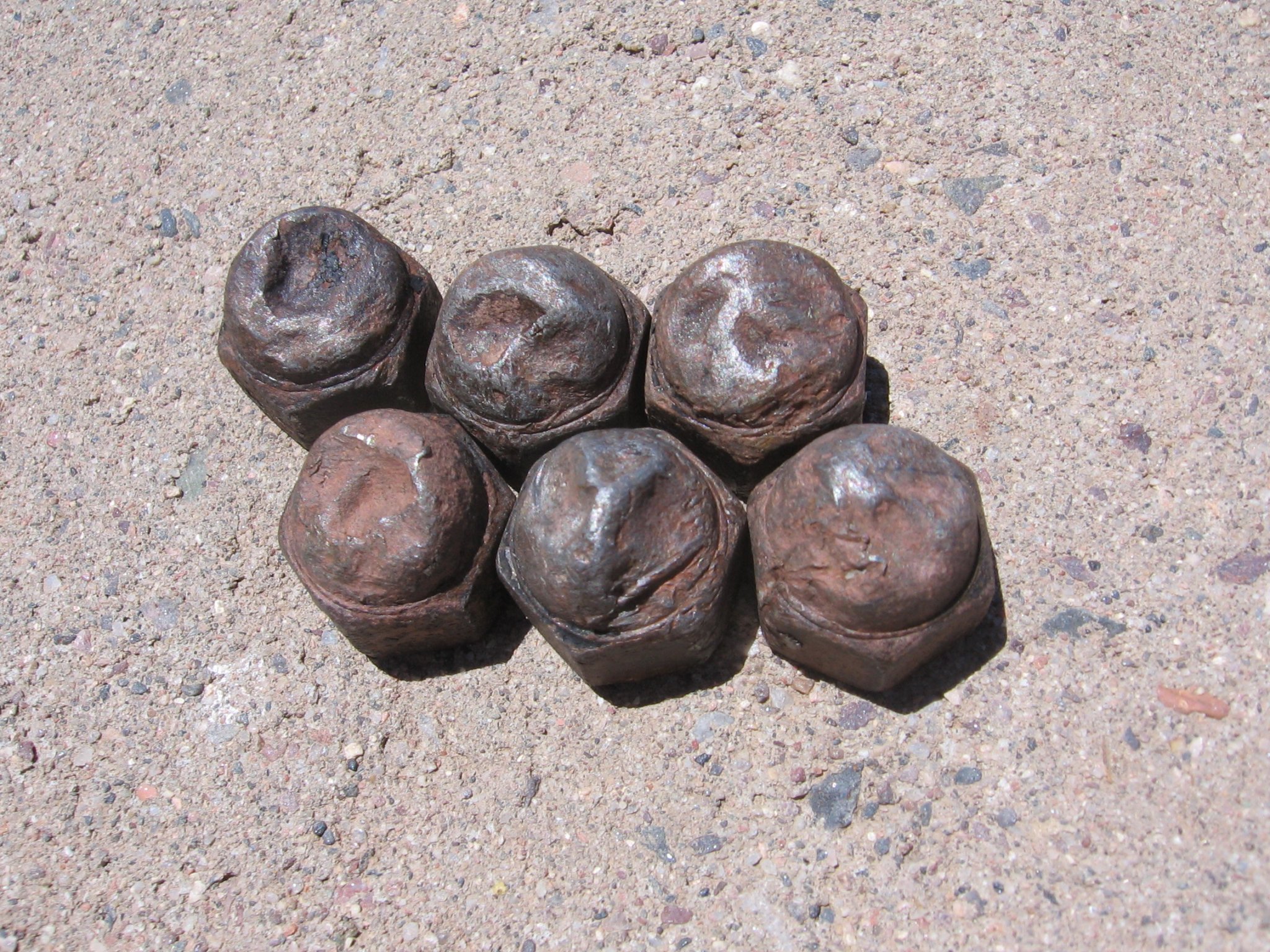

Crushed acorns:
(tried to type "crushed nuts" but it just sounded too painful)

8,206
3,590
1st pic is from the manual, 2nd is a blow-up of groundpig's machine.
View attachment 82358 View attachment 82359
It appears after much cleaning & inspection that the original zerks were all sheared off.
Nothing remained of them, or the first & second threads in all three holes.
(plus a couple more threads bunged up)
Threads are 1/8-28 BSPP.
I have the proper zerks on order, and even found the correct tap to chase the threads from the inside out.
Hopefully everything will be in in 2-3 days.
Flexible plastic lines are 6mm. :confused::unsure:

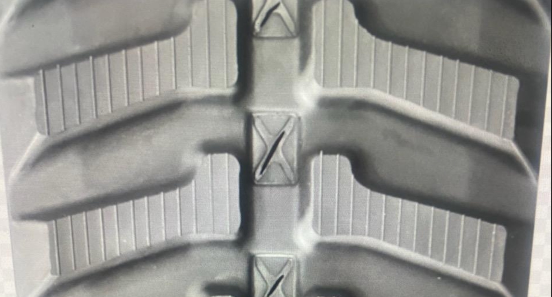

Mounted the left track today, pretty tough by myself, but it went right on with the better half operating the stick, and me wrestling/prying.
And yes, it fits! (y)
Excuse my ignorance...but I have been loving this thread and your wonderful ability to bring this back to life better than original, in my opinion. But I have a stupid question....
The new track looks like it has rips in the middle. Am I seeing things? Is this normal?
8,206
3,590
You are not seeing things, completely normal, although not technically "rips".
During the casting process, there are "X" shaped slits purposely put in. These allow the sprocket teeth to poke thru slightly, but more importantly allow any rocks, dirt, or debris that get trapped on top of the teeth to be pushed out thru the slits, keeping the track in close contact with the sprockets.
Some brands have a single slit, some a round flap, and some are completely open holes.
