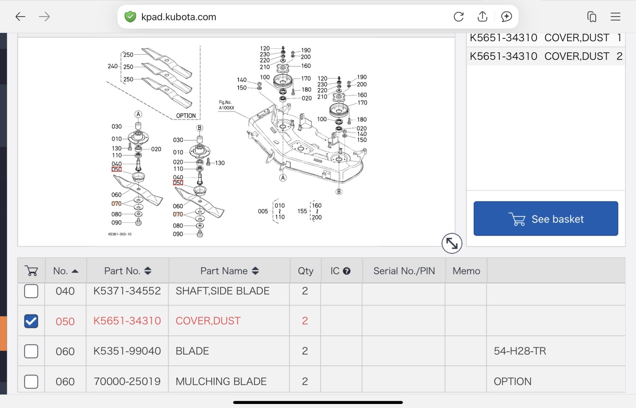

Is that black cylinder on top of the blade what you’re referring to as spindle?
That black cylinder is probably called something like a dust shield or cover. It is there to protect the spindle bearings and seal from dust and stuff while mowing. The “stuff” can range from grass, vines, strings to barbed wire. If something gets wrapped around the shaft it will destroy the seal normally.
You can look at illustrated parts list at Messicks or Kubota USA dot com
Messicks is better but a bit more difficult to navigate but will link to parts price and availability easily. Kubota is easy to use since you are forced to type in the model number of the equipment.
Here is an example of one of the decks that fit your tractor model (as you state it). I have no idea if it is even close to what you actually own!
