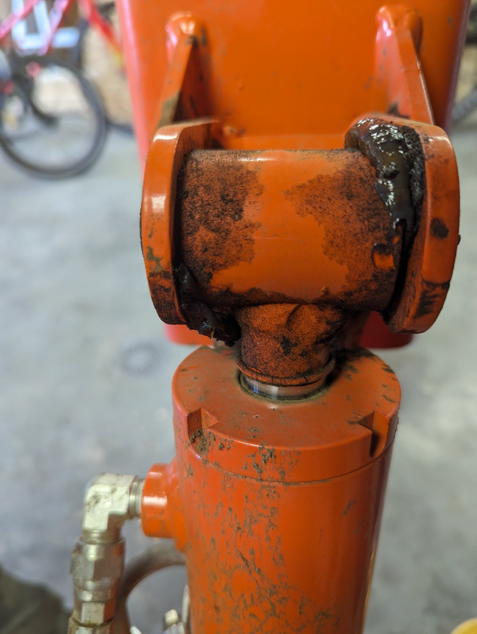

It's like this on a few joints on the BX23S. Here's a picture of one example: on the backhoe stabilizers (from further away and close up).
5,365
1,415
On that one I would grease it in different positions and move it around between each pump of the grease gun. Then extend it fully and retract it fully.

Nope, that's fine. As you move that joint, it'll get smeared around. You could go crazy and take the stress off of it by letting it rest in the ground and move the thing around but it's not necessary.

Most of those pins have one grease hole on the 360 deg surface. The purpose is to place it in the joint without disassembly. Use moves it around. If you want to make sure grease makes it to both sides, inject in each max up/down position.
