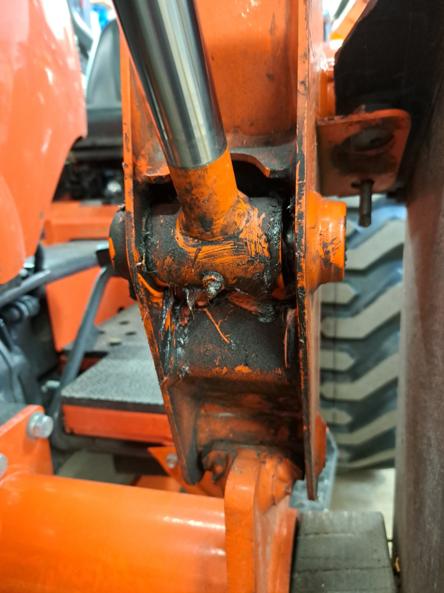

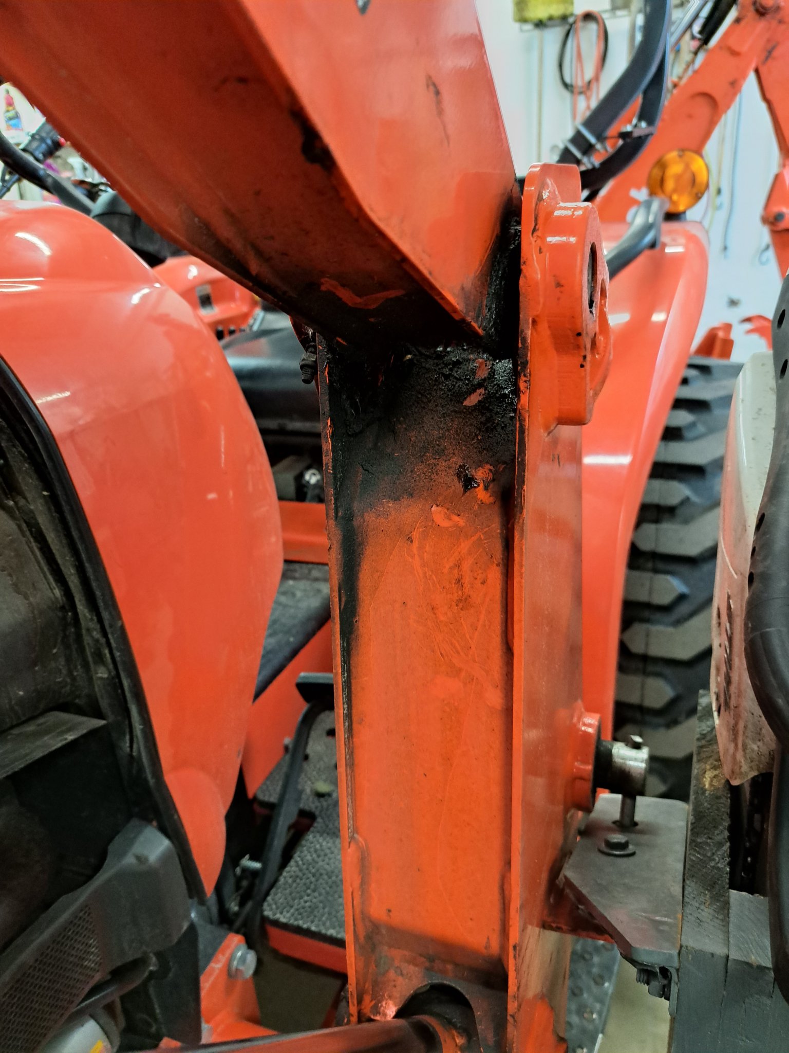

I loathe greasing my machine/s: However, I do it all the time due to the 'voices in my head'.
The thing I hate as much/(possibly more) is cleaning up, and lately I have been neglecting the "clean up" part.
The over arching question here is : What do you use to clean heavy amounts of grease off?
"Back in the day" I/we used "trike" (trichloroethane or trichloro-triflouronethane???? possibly both?) and it worked great from what I remember.............. Best of all it was free ;) ......
About 15 gallons ended getting "accidently" taken home with a Marine that I knew, but 'he' has long since run out and therefore, "we" have had to find alternatives.
Currently I use a butt load of rags and "brake cleaner", but was wondering if anyone has a better solution?
Here are the before and after pics of my most recent "cleaning spree"....

I use old rags damp with diesel fuel. Gets the gunk right off. Wear rubber gloves!

I don't use brake cleaner on painted surfaces. After wiping, I'm partial to citrus degreasers. I like the stuff sold for cleaning bicycle or motorcycle chains, if you can find a bulk-size quantity so it's not overpriced.
