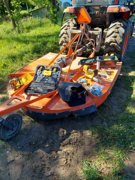

That shield got the best of me and I decided that I no longer needed that shield. I figured no one was going to be riding on my rotary mower nor would they be anywhere near it while the PTO was engaged, so it was a useless shield and I wasn't going to fight around it anymore to get to that grease zerk. Now I can get to it without an issue.

Jesus, is that a rotary cutter or a tool cart?! :LOL:

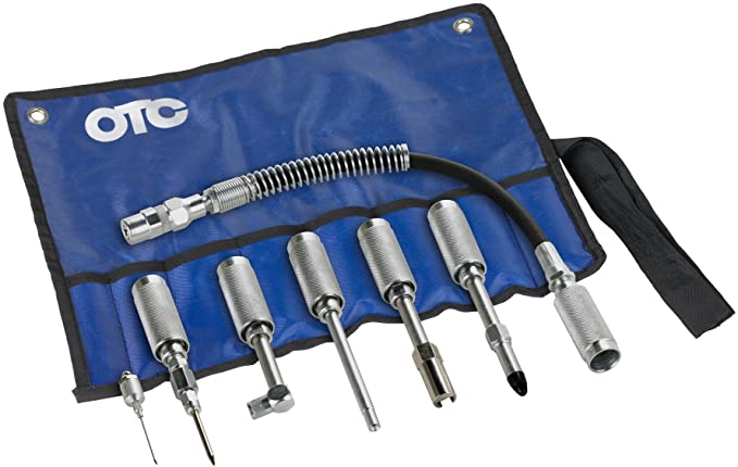

I serviced the RCR1884 yesterday prior to mowing and was able to grease the u-joint nearest to the gearbox with the cover in place. I used one of the adapters in the OTC kit that I bought a couple of years ago. I used the one third from the left in the image shown below, the one with the 90 degree head on it. I rotated the pto shaft and pushed it over to the far left (if facing the tractor) and was able to get grease into the joint with little difficulty.
When I loosened the fill plug on the side of the gearbox to check the oil there was some pressure built up inside the case which makes me wonder if the vent on the top of the gear box isn't working properly. Not a lot of pressure, but enough to hiss a bit and push out some oil. The oil looked new so nothing to do there.
