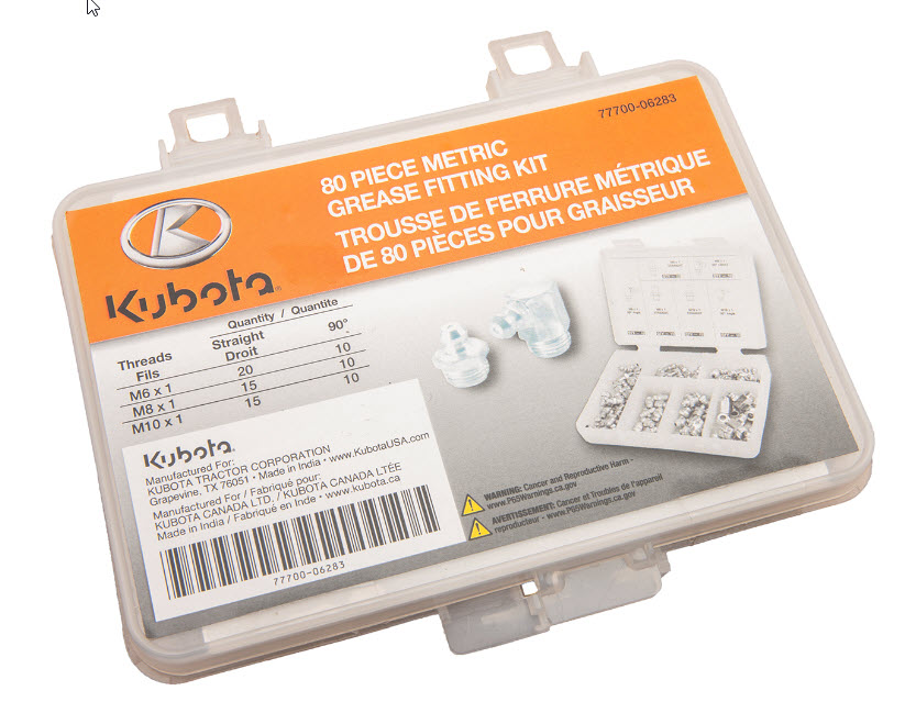

New need: QUALITY Zerk Caps and grease fitting kit. Someone have a good link to them???
(The Kubota looks great but I'm thinking there are more fitting options so the kit is more generic and works with other stuff also, plus some hard-to-reach fittings can be replaced with non-OEM fittings.)
