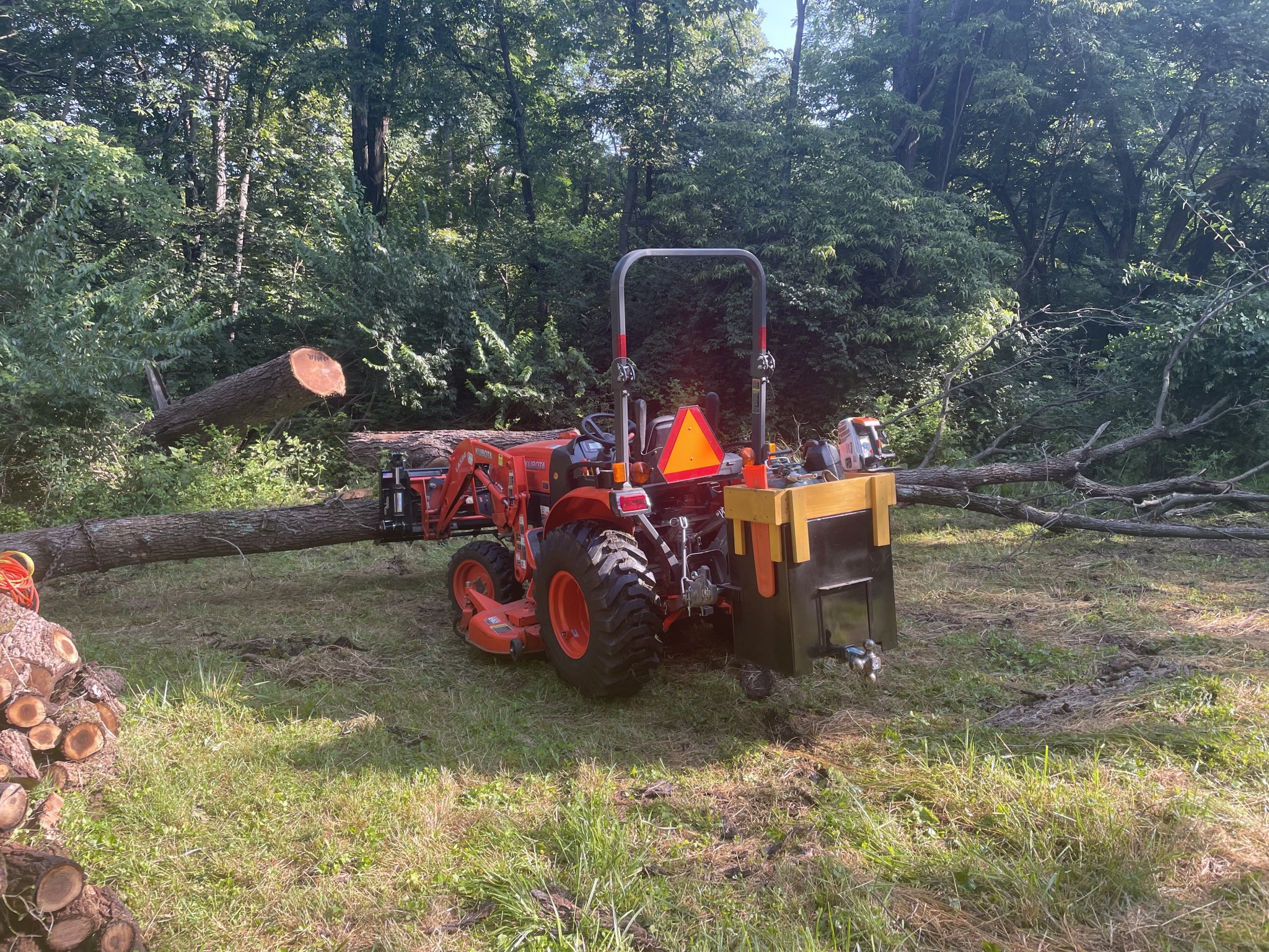

You can see that full curl in the second picture.

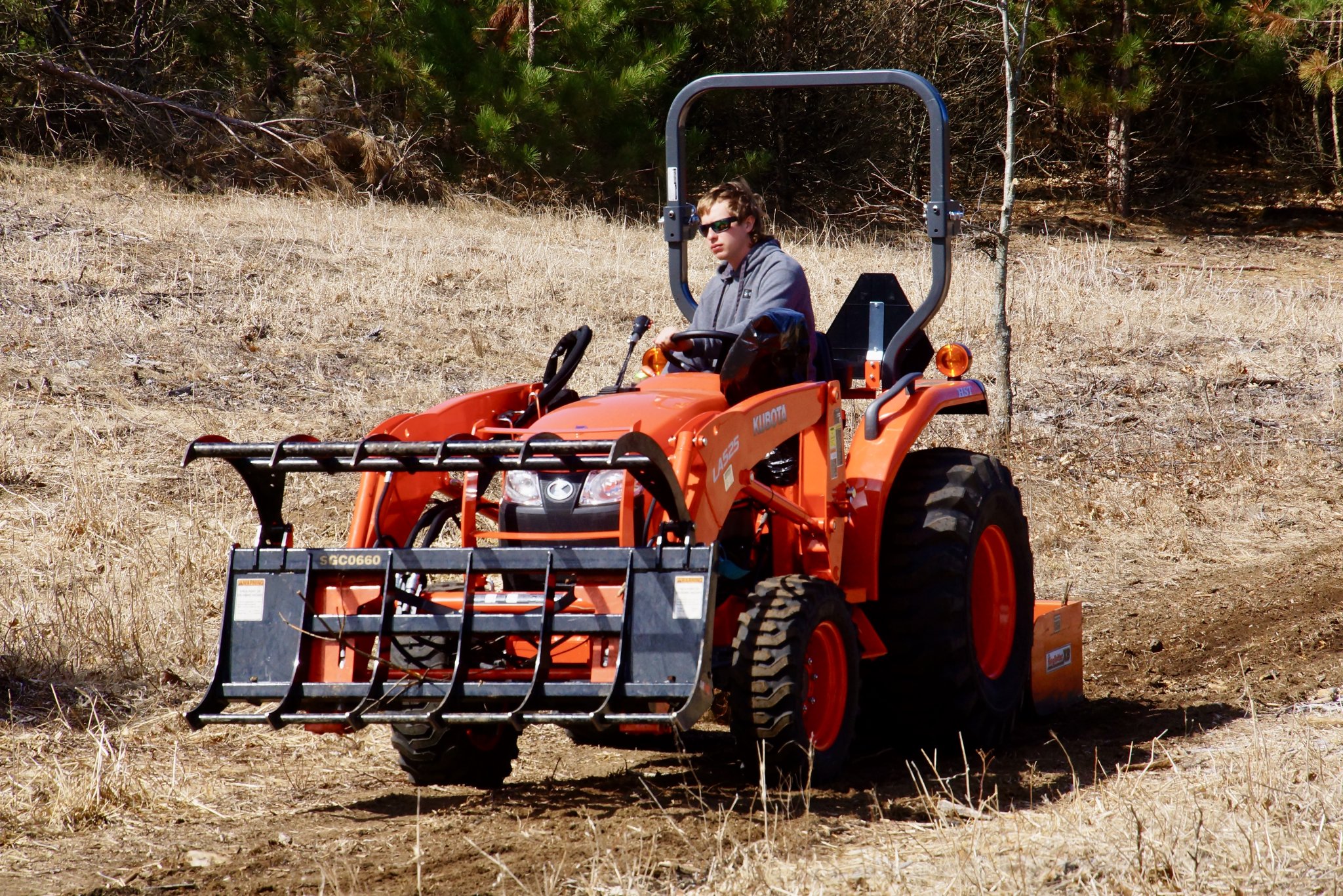

The first picture is something I do not know how well a rock style grapple could preform the back dragging operation as I was smoothing new trails.

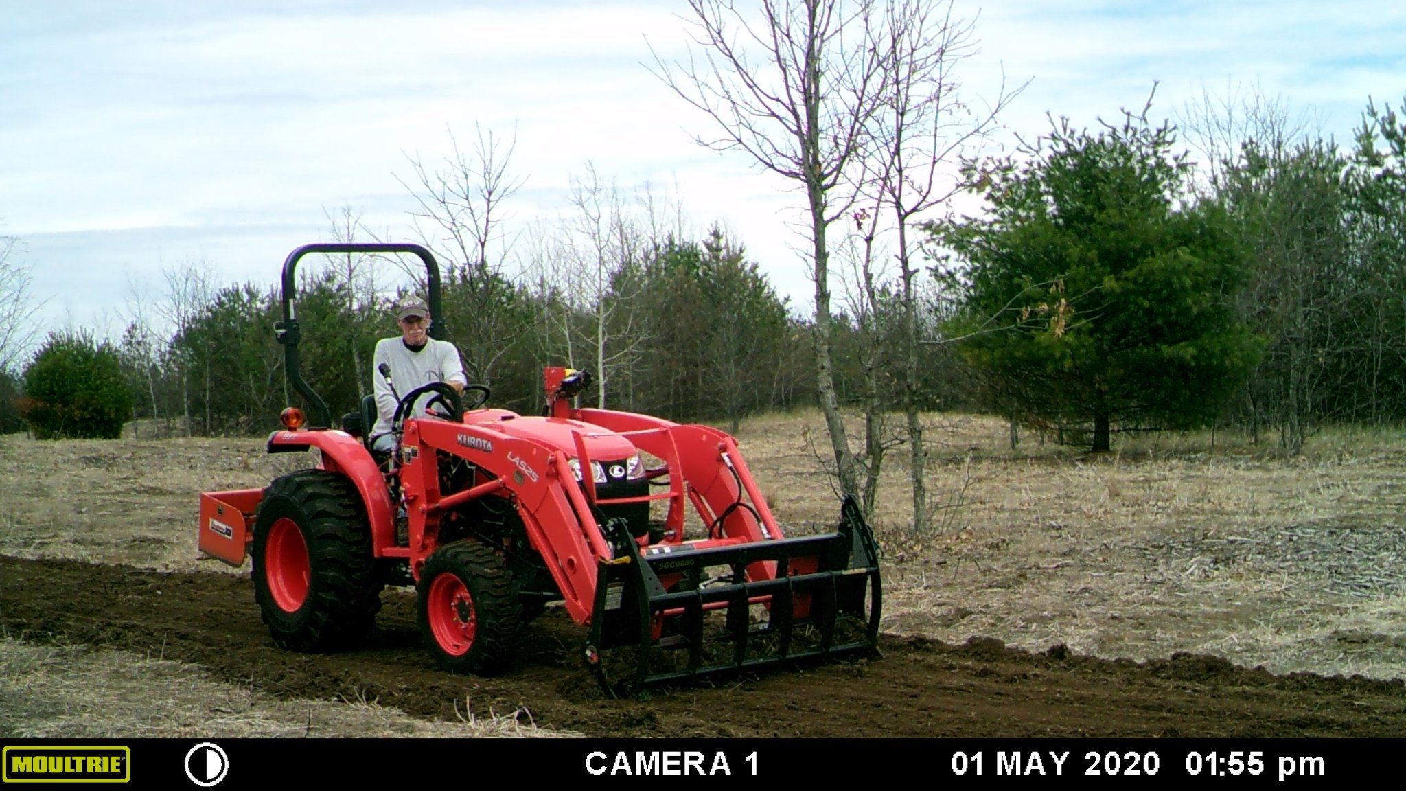

Third picture is one of the live red pines I dug out. At the base , maybe 10 to 12 inch diameter.

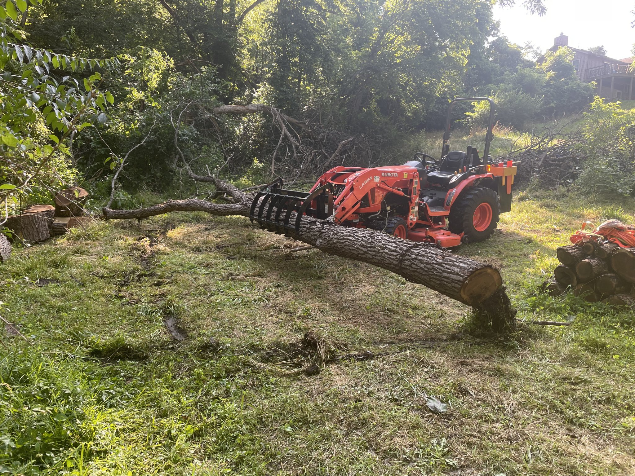

2. The grapple will probably be able to hold more weight than your FEL can lift. It's easier to bite off more than you can carry - the sycamore log in the photo is a good example of pushing things almost too far. Note, the lift was to see how high I could go on flat field - no way did I travel with it at that height!
