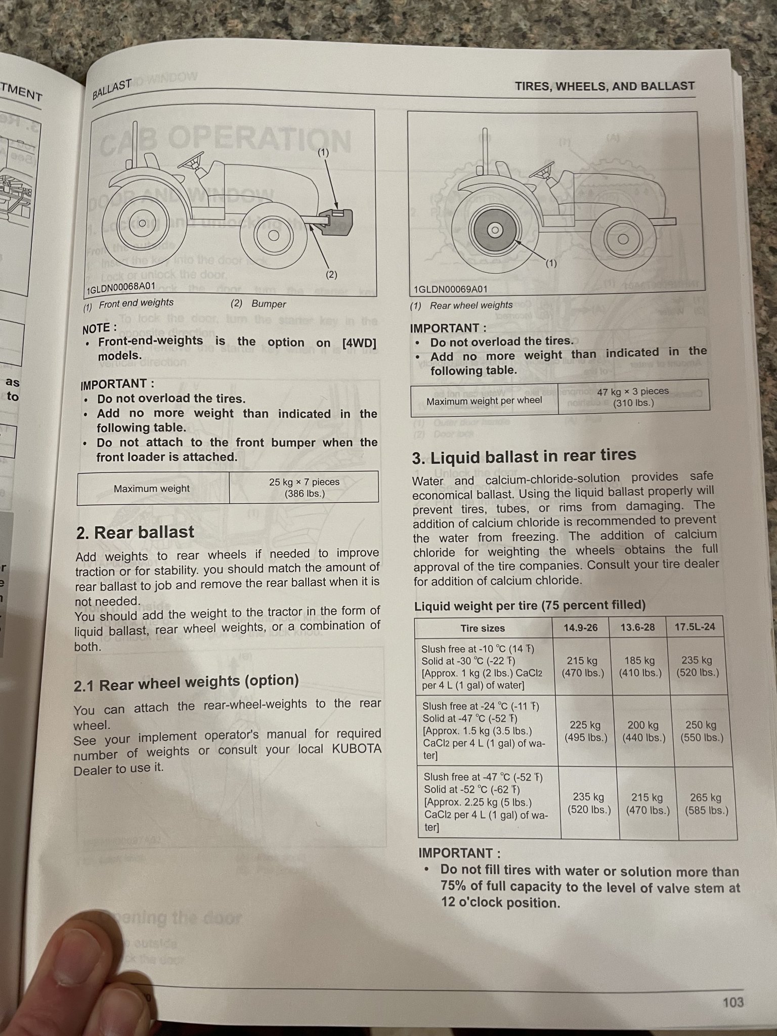

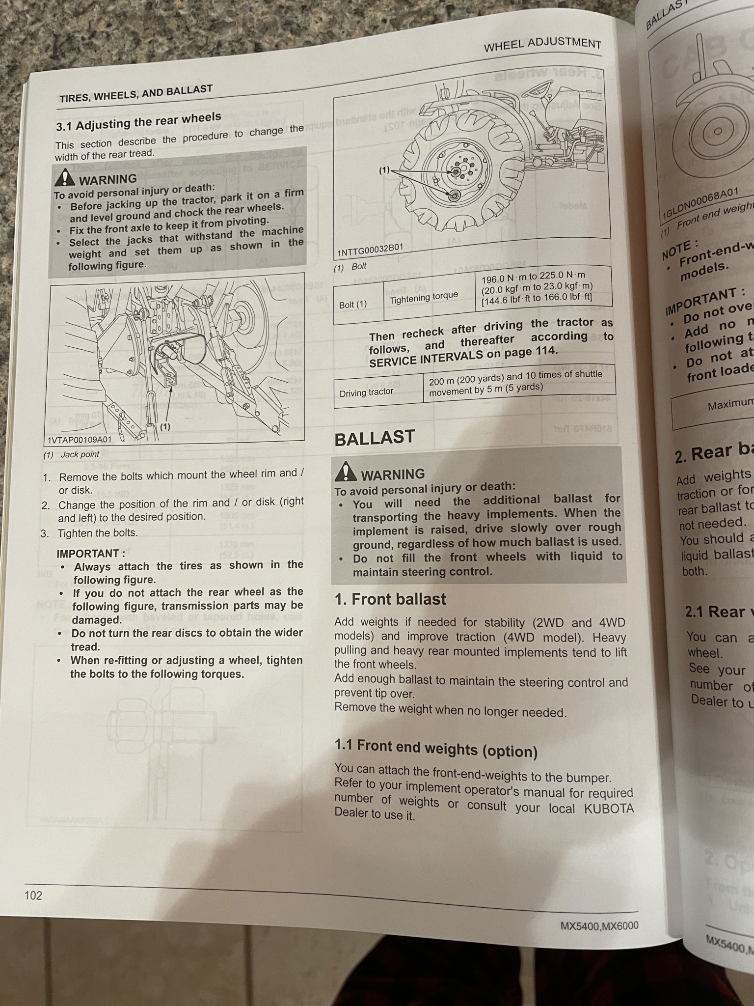

Thanks for your response. I like the idea of getting the wheels/tires out as far as practicable. I have received some conflicting information from dealers about whether the MX or Grand L wheels can be flipped to a wider stance. I also inquired with my local dealer about approved wheel spacers and they gave me a “we will follow up” response. I expect, like changing wheel or tire sizes, it is something they (or maybe Kubota) generally don’t want to do.
I would be surprised if your dealer responds to wheel spacer question. I enclosed page from my owners manual on how to set rear tire width. In my case it was swap Tires side to side and spin 180* to get the directional tires set.

Very informative, thank you.
