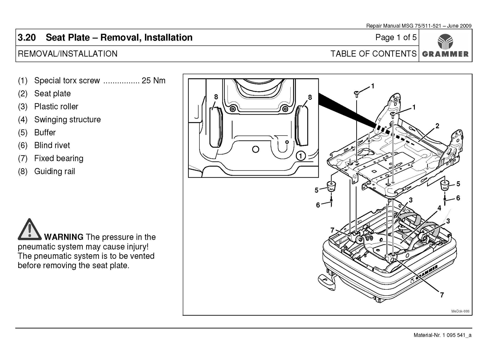

On second thoughts, here's the Grammer seat that's in my MX. If you order L6023 (vinyl) or L6026 (cloth) this is what you get. The seat plate bolts to the low profile air suspension system so it'll be interesting to see how that works with your standard seat.
I don't see any suspension "kit" offered like there is for the M tractors. You can buy replacement parts that make up the air suspension but not as a kit that you can bolt to any seat, as far as I can tell. The entire seat shown below bolts to a sheet metal pedestal in the cab. Anway, keep us posted if you don't mind.

On second thoughts, here's the Grammer seat that's in my MX. If you order L6023 (vinyl) or L6026 (cloth) this is what you get. The seat plate bolts to the low profile air suspension system so it'll be interesting to see how that works with your standard seat. Keep us posted.

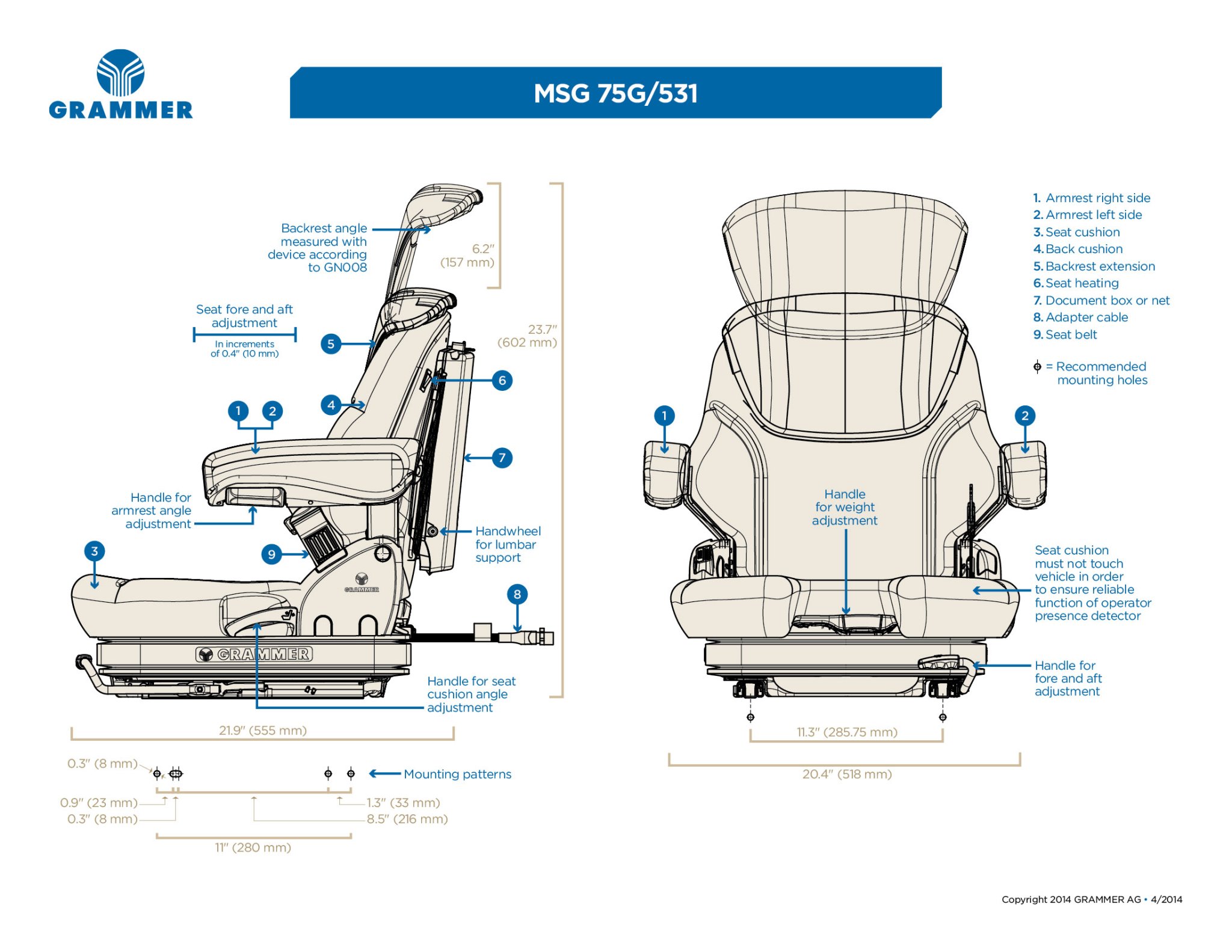

Not to beat a dead horse, but here's the M9270 air ride kit that's available to convert a standard seat that comes in M series tractors to an air ride seat. If you order an air ride suspension seat when ordering an M series tractor it's about a $700 upgrade since it's just the addition of the M9270 kit. I've yet to install the kit shown below but will get to it this spring. The entire seat has to come out the rear window as part of the swap so I'll be needing some help with that. :ROFLMAO:
If you order the air ride seat upgrade on a new MX or L60 it's $1,100 because it comes with the seat and air suspension as a unit. I haven't found an MSG75G/531 suspension kit that can be ordered like the M9270 kit.
