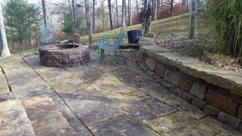

I installed a retaining wall and patio and have always thought it was one of the best investments I ever made. My house is just out of frame to the left. With the wall I built, I got the added benefit of seating.

Nice work there, and i do notice the two comfortable chairs and then the stone bench for keeping the rest of the guest visit short term [emoji15]
Hmm, didn't think about that. Maybe a subconscious Freudian thing... Seating for the in-laws! :)
