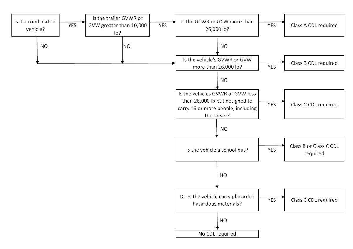

Ok. Here's my take in PA.
You need a CDL if:
1) the GVWR of tow vehicle is in excess of 26,000
2) GCWR (tow vehicle GVWR and trailer GVWR) is in excess of 26,000 AND the towed vehicle (meaning trailer) is in excess of 10,000 lbs. The operative word here is "AND". Important to note here that it's the combination of truck and trailer that trips people up.
example 1- F550 rated at 19,500 GVWR pulling a trailer rated at 7K GVWR is in excess of 26,000 but the trailer is not over 10K GVWR. No CDL required.
example 2- F350 rated at 14K GVWR pulling a 14K trailer. CDL required.
Keep in mind that you may also exceed the GCWR of the tow vehicle when pulling a gooseneck. It doesn't matter if the trailer is empty. That's the whole reason why they use Weight Rating, not actual weight.
So, pulling a gooseneck rated at say 15K can easily exceed the GCWR of many 3/4 ton pickups (typically rated at 10K GVWR, 24K GCWR). Loaded or not.
Additionally, DOT registration is typically only required for Interstate commerce/travel (not intrastate) and also depends on what you are hauling.

Here's a good article about towing and the requirement for a CDL.
I made a clearer version of the flow chart since it might be useful to some, me included. These are Federal regulations and as the article states, you need to check on state and/or local laws.
Edit: I made a change for clarity re the GVWR/GVW greater than 10,000 lb.
