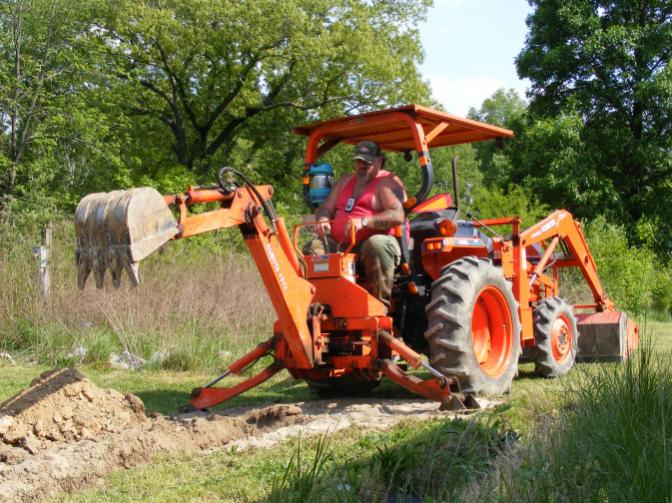

Finally I have new pictures to share. My tractor should be home by the end of this week with any luck. It's been a long road to get here and I had to buy a 7 x 16 trailer to get it where it needed to go, but the loader is on and the tires will be weighted and the backhoe mounted this week.
Now, finally I might be able to get some of my work done, and I really need to if I'm going to have things the way I want them instead of the make-do way they are now.
Here's a good picture of my tractor before the "operation" and three after the loader is on.
Now with the loader.
Woods LS84 Loader and genuine Kubota ROPS.

That's going to be a nice setup when you get it all mounted up. I had a woods backhoe just about like that one. Yours is a lot prettier than mine was. I would like to give you a warning about it so you can keep an eye on it. It was a little hard to tell in the pictures but it appears the outriggers will stick straight out to the side when lowered. If so you should watch them close. That is their weak point. I put mine in a bind digging a stump out and broke both of mine. When the first one gave way the entire machine shifted and bent the other side. I could raise the bent one enough to load it back upand the other was hanging by the hydrolic lines. Total loss of my backhoe. After checking it out further the frame had been damaged as well. Had to scrap it. That design is why Kubota stopped using woods backhoes and now build their own. The outriggers on my 4672 are angled to the rear just a little and they make a big difference being done this way. The harder you pull the more they are planted to the ground.
Just thought I would pass that on to you so you could keep a check on them. It cost way to much to replace.

Bulldog, thanks for the heads up. They do come straight down to the sides. I'll keep an eye on them. Is there an adapter to change the attitude of the outriggers or any other "fix" that you know of?

I don't no of any upgrade to fix this. I'm sure it wouldn't be to bad to either make a piece or just simply change the angle of the factory mount.
Honestly, I would just watch what I did and take care of them. If I had been warned ahead of time I could have watched mine better. I had no clue they had a problem with that.
