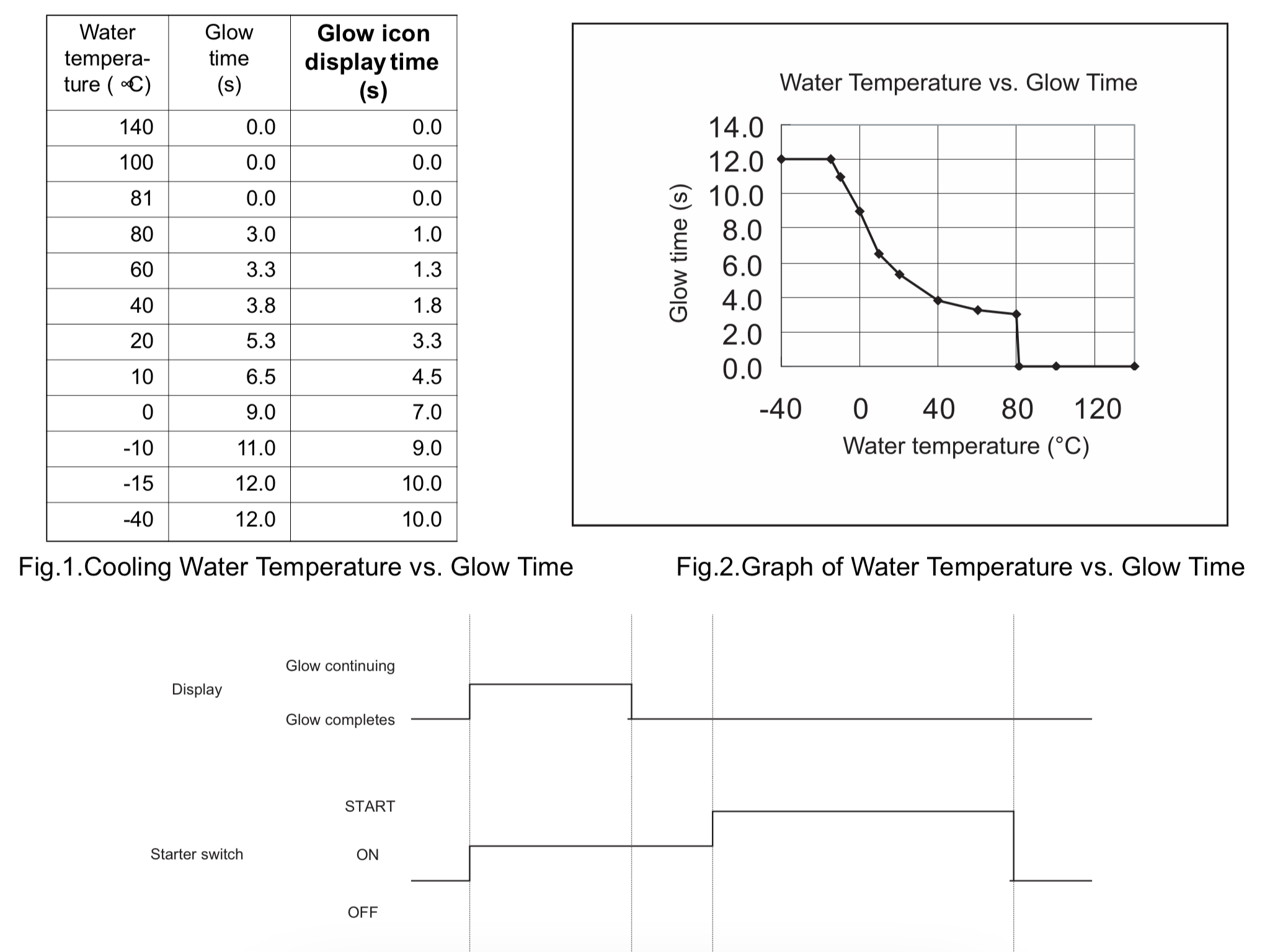

This chart must be for those tractors that have an automatic glow timer. Still, it could be useful as a reference to how long one should hold the glow for those that do not have an automatic timer.

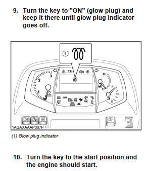

I checked my manual, it states to turn on key, wait tell glow plug simple goes off, start tractor.
Yeah, then yours is an automatic timer. Mine is manual. You turn the key to the 1/2 position and look at the glow plug light on the dash to be sure it is on and you count a few seconds and then turn the key all the way over to the start position. I never tried it but I bet if I held the key in glow position the light would just stay on until I released the key. I think the glow plugs would ether burn out or just stop glowing without any way for me to know it at he time. I think all of my vintage BX's are the same.
Here is what is in the manual for the BX1870, BX2370, and BX 2670. I don't have a pdf of the operator manual for my BX1860 but the procedure is the same.
Turn the key to "PREHEAT" position
and hold it for about 2 to 3 seconds.
For the appropriate preheating time, refer to the table
below
Maybe so, but it makes no difference really, whether a timer does it or a human does it, the recommended time would be the same in either case.
