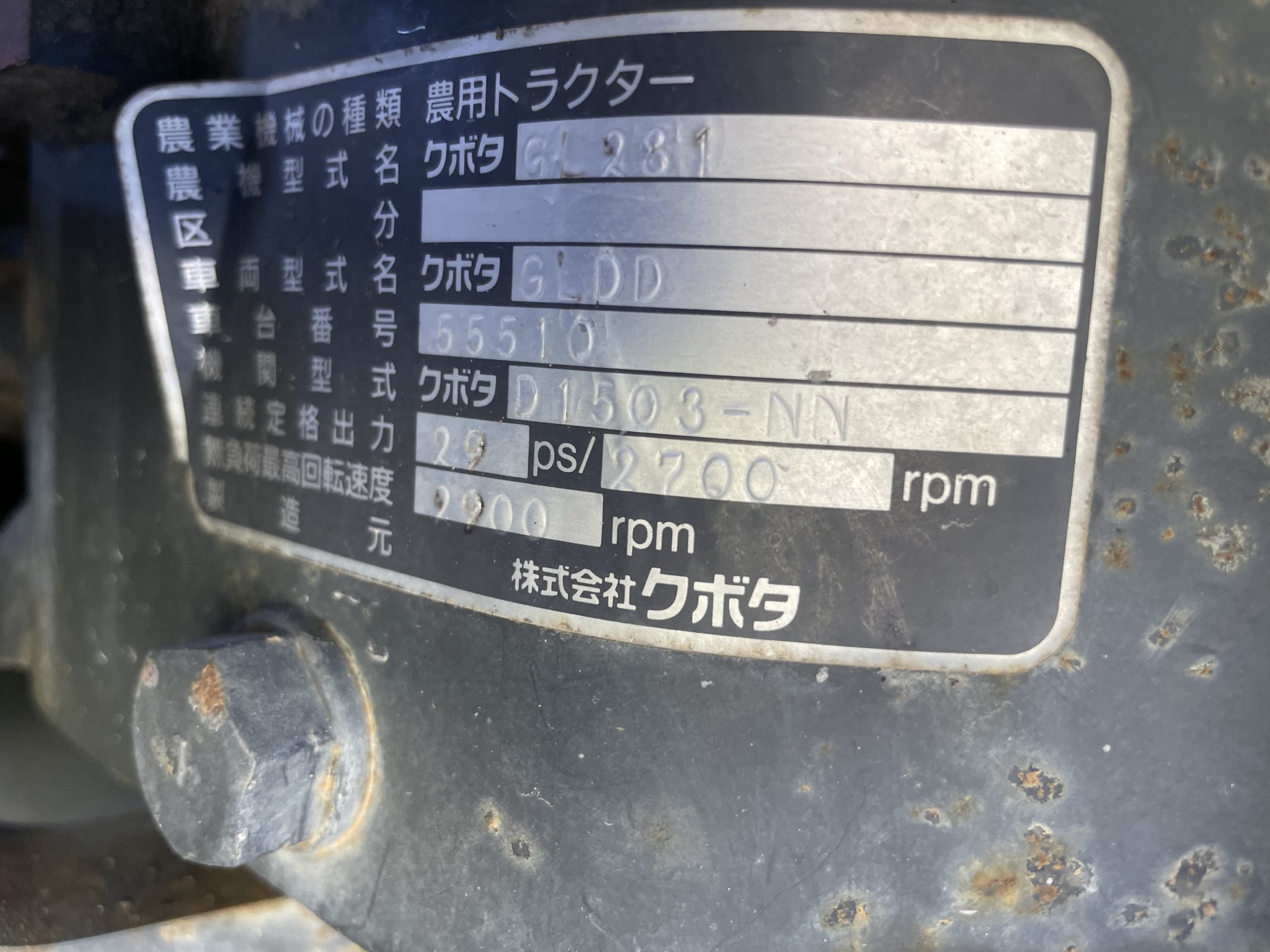

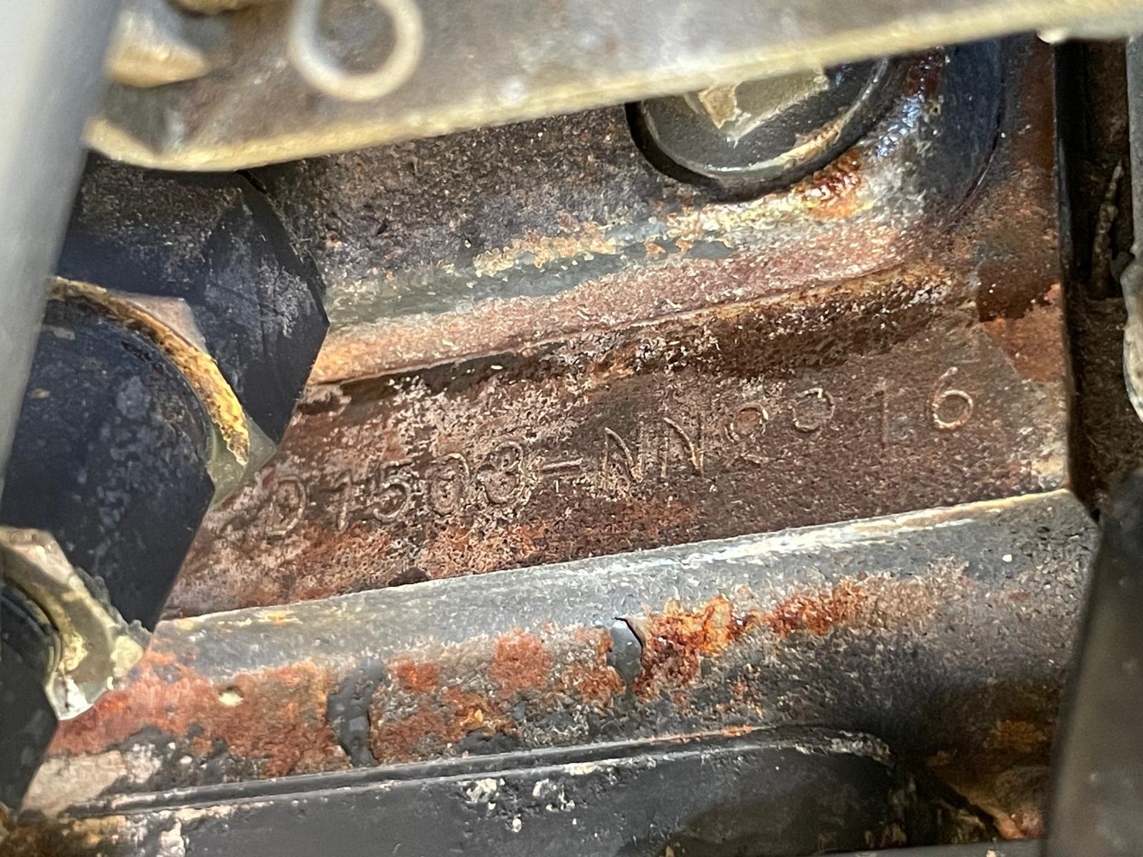

Give me the model and serial numbers,they are stamped on the block facing up just to the outside of the Injection pump.

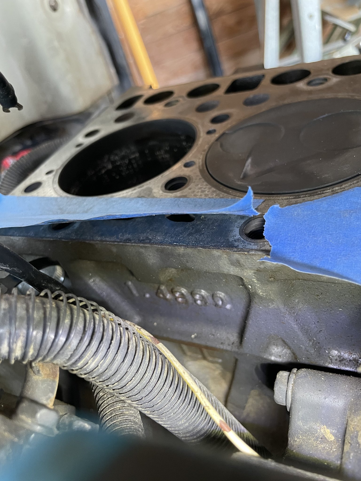

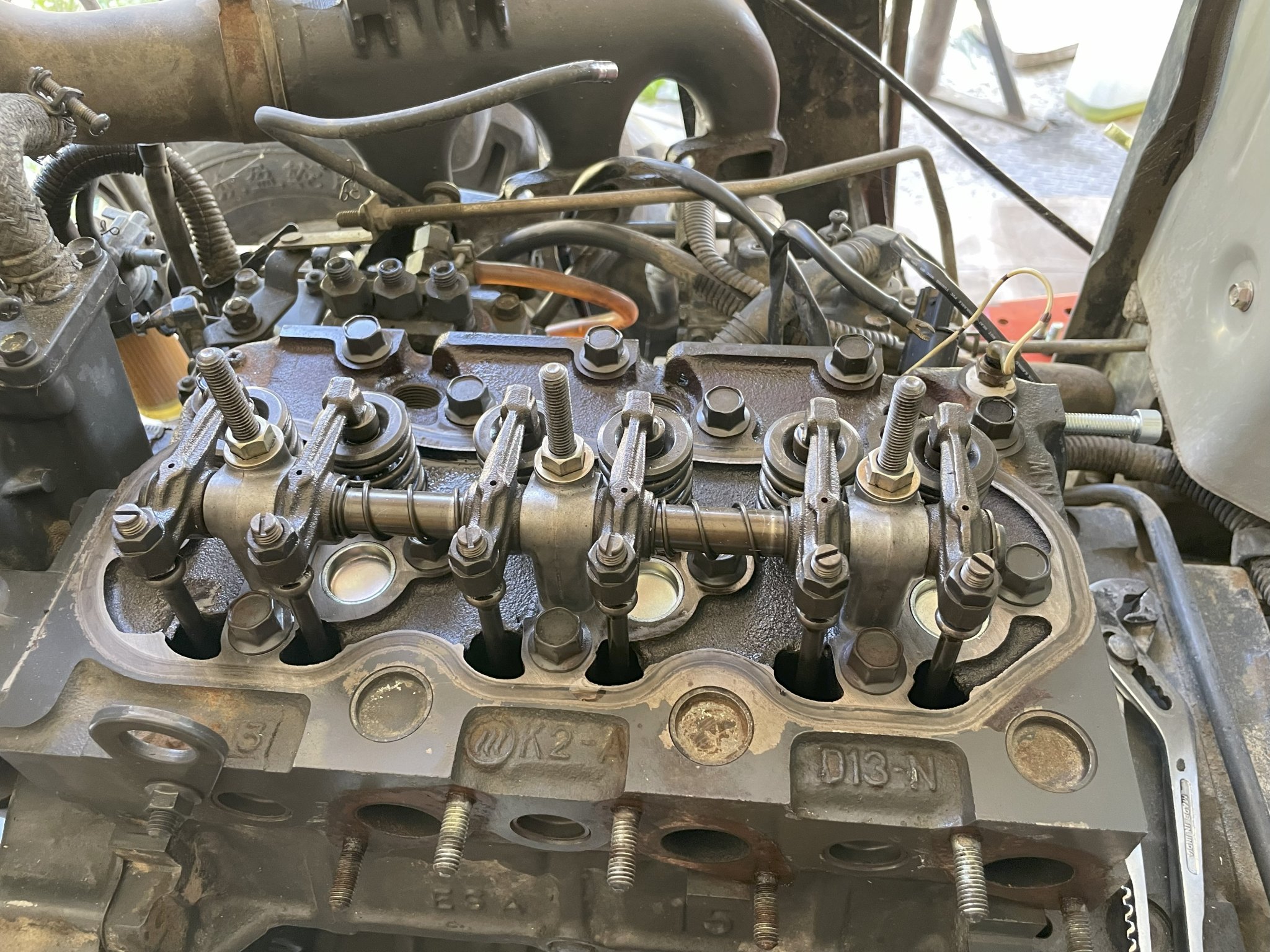

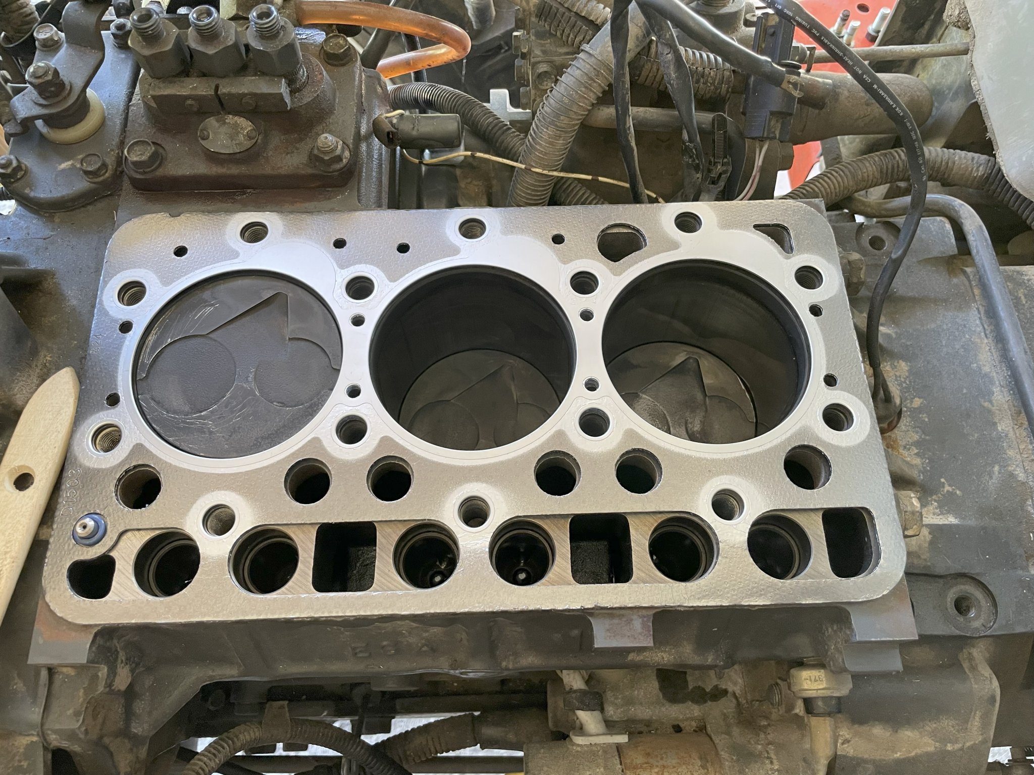

thought I'd show you some pictures.....
And it's running very smooth now so I'm happy. Thanks for the assistance!
