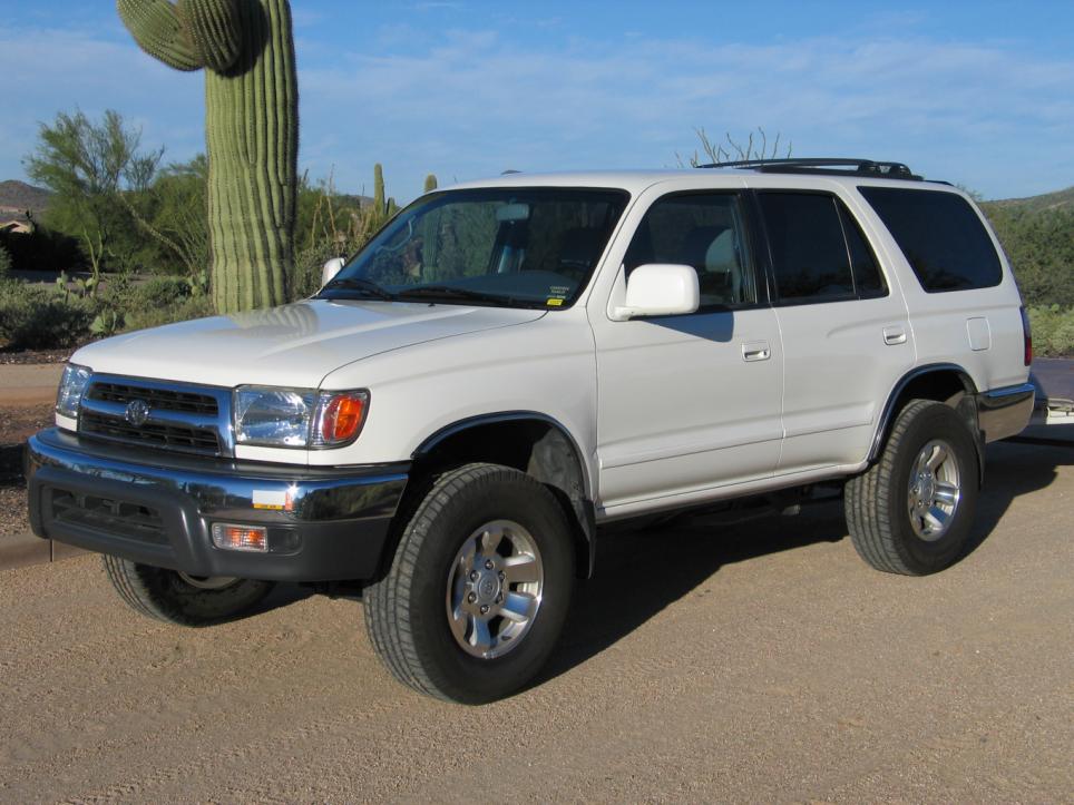

In the life of my '99 4Runner, I have had TOYOTA do four power flushes on the tranny which includes a new tranny filter. With 140k on the clock, it shifts like the day I got it. I get calls from the local Toyota dealer all the time saying they have people looking for that model. I finally told them, "I instructed my wife to bury me in it." They stopped calling. It's so old it has actually begun climbing in value. (There is a place in Oregon which takes this body off and puts it on a current model frame and running gear with the new engine. Guess that is why they are in demand...)

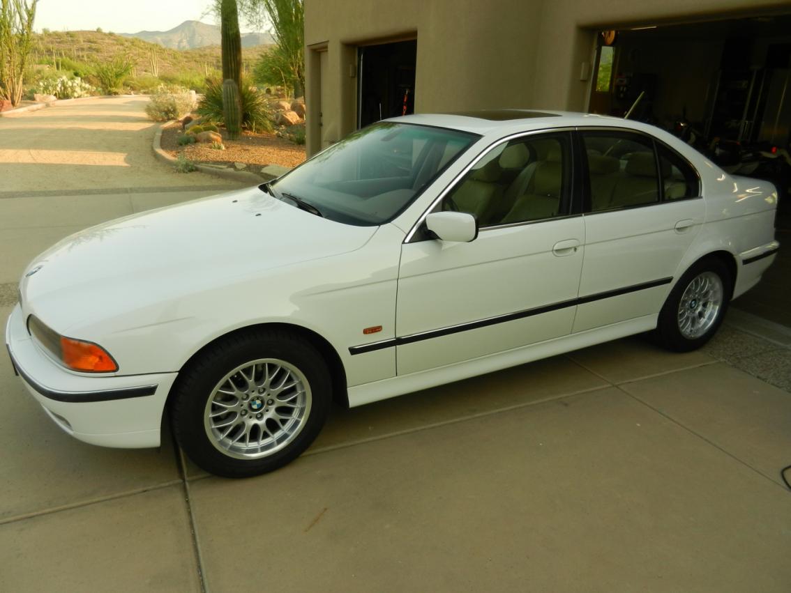

I have swapped out the "permanent" fluid in my 2000 528i tranny twice since I got it with 36K on it. Last month I drove it 500 miles in three days, much of that well over the speed limit. Shifts great. 27mpg. The old "heap" has a book value of around $5k. It's near mint inside and out. How can you sell a car like this? It's just getting broken in.
